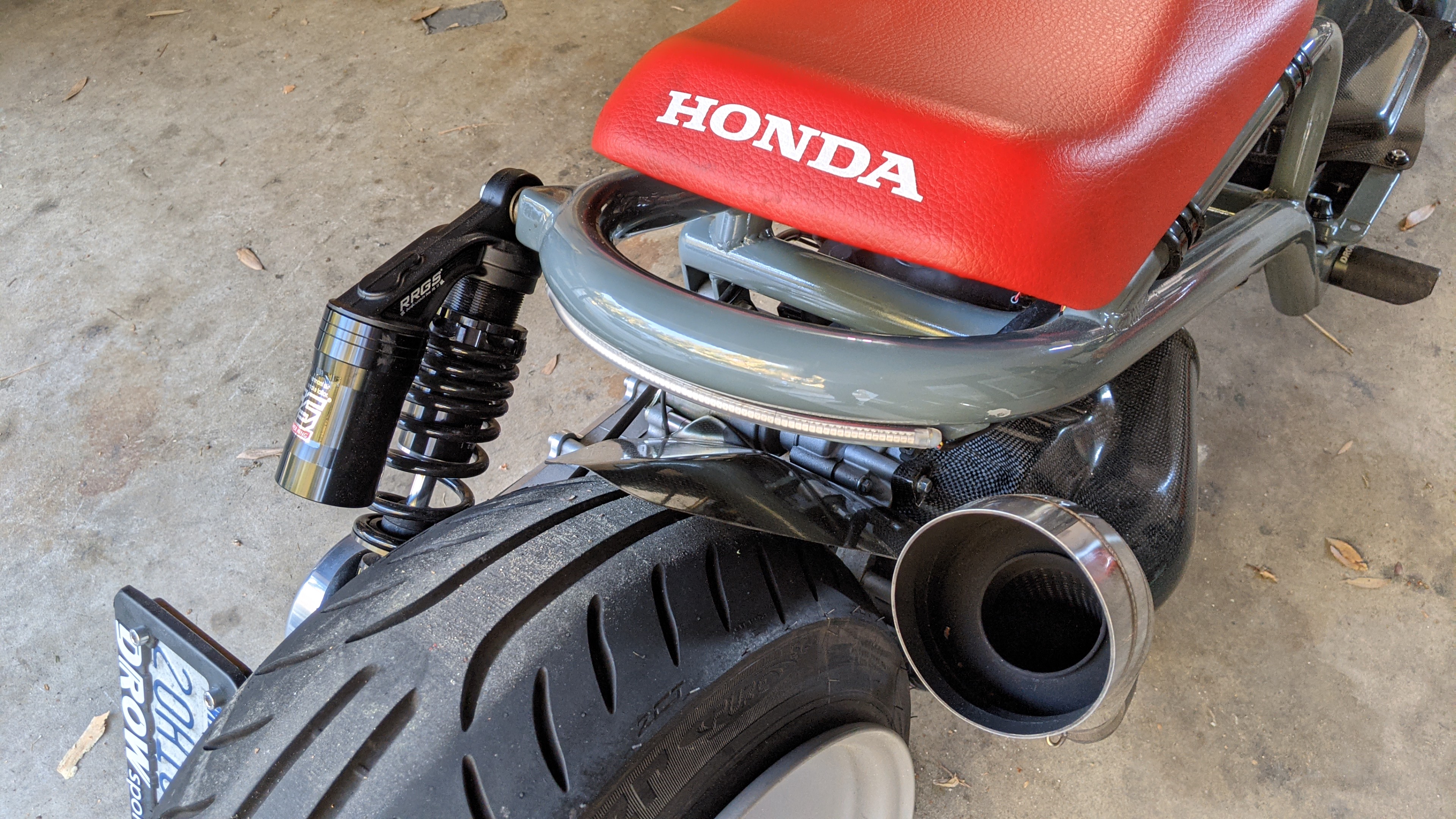

This keeps all the water from spraying on you. Even though I don’t like full fenders like that it would be great to have a removable fender like that. Ronks fender is nice!
I have the DROWSPORT carbon fender on mine. Really haven’t ridden it in the rain/wet much so I’m not sure how good it is on keeping spray to a minimum.
