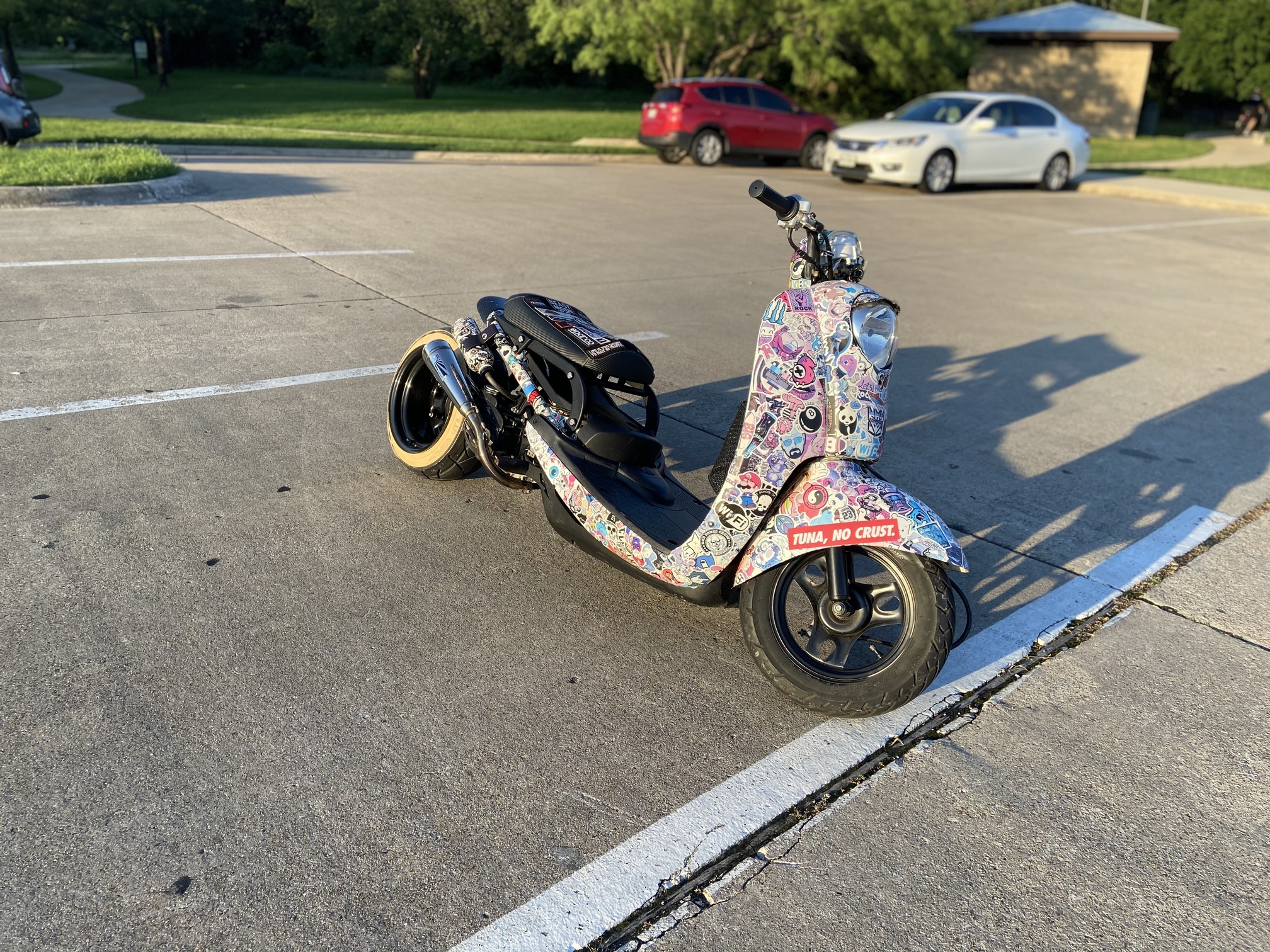

Need to get check valve clearance cause it doesn’t ever want to stay running for some weird reason… have to hold the throttle fully open for like 10 mins before it wants to stay running after it gets cold again
Me and about 6 guys I know are having the same problem, at the same time. I adjusted my valves and she’s back to normal.

It’s all good I adjusted my valves and while everything’s was apart changed my fuel pump and filter and now I get no clicks when the ignition turns on…

Found out the metruck had an air leak on backside after the carb making it run with pretty much no air intake
Cleaned the carb while the hole was being plugged, found out I had an 86 MJ in there ( must of thought the 6 was a 0 ) replaced it with an 82 cleaned the SJ and put her all back together and she idled nice and smooth
Thanks to Happypancake for his wisdom to help me through this trying time!!
