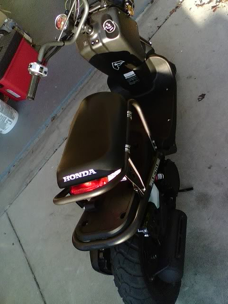

here’s what i did instead.
I took off the red plastic cover and drilled 3 holes on the black part of the tail light. (sorry for no pics while doing all this) After that I screwed 3 black screws through the black part of the tail light directly into the seat. then I put the red cover back on. It clears everything when I open and close my seat also.
I also installed some LED turn signals (I do NOT recommend smoked tinted ones like I have. My Ruck is just rarely driven)
I’m happy with it and it didn’t cost me anything so ++++++ !
here are a couple diff angles.
And I can’t think of how better to describe how I installed it then what I wrote in the first post. Sorry.
