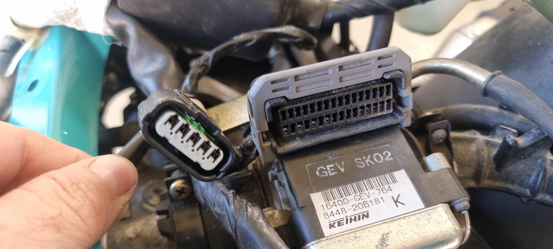

Can you please help me with the Kitaco I-Map?
Iāve bought it from Amazon jp and i didnāt check the connections. My Zoomer is a European FI and the kit iāve ordered is for the Japanese version. Iām trying to figure out the wires an how to connect them manually to the Euro connection. Thanks in advanceā:+1:t3:
Hi, The connectors on that iMap are not going to be any use. Iām not sure if the wires that go into the connectors are the same as the wires on my iMap. If you are not planning to return the iMap for a refund it might be worth stripping the main cable back to see what coloured wires are underneath. If they are the same then you could cut the connectors off and hardwire the iMap into the loom like I did (all videos are on my scottishzoomer youtube page. Did you buy the PClink cable too as frankly without it the iMap isnāt much use anyway?
Sorry I canāt be more help, but I sold my Zoomer three years ago so Iām having to refer to my memory and my own youtube videos
Hi again. Thanks for the information. Well⦠i have 3 weeks to send it bach or i can give it a try. Iāll check your videos again to find out the colours. The main problem is the color of the original EU version. Nobody has an idea what is whatā¦
I didnāt bought the computer unit. Iāll get it later if i can solve my cable problem.
