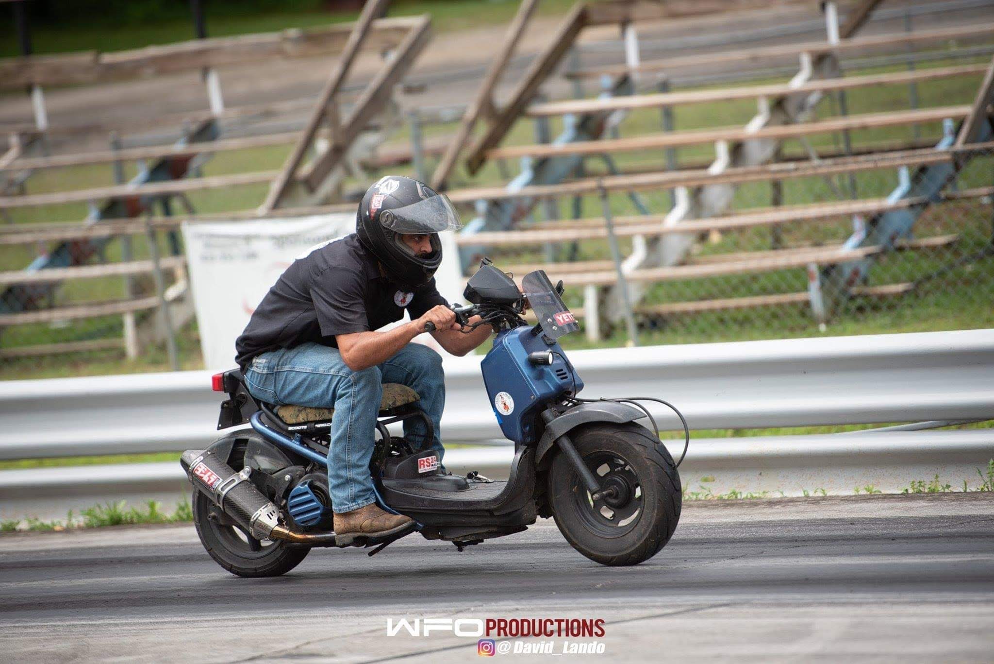

This is my zuma swapped ruckus. I used to be cool_whip_ruck on the OG tr pages. Started off on a completely stock ruck and the mod fever hit. I soon met a group in the Charlotte NC area where i found Little Boy Blue. He was originally built by my friend who found out quick i was good at cvt tuning when my stock ruckus was walking his stock fi zuma 50. He had sold Little Boy Blue to someone who didnt know what he had or take care of him properly. So i traded my first ruckus that i fully GET modded to pull 45, for Little Boy Blue. My original ruck is still running and close to home and every now and then i still get to help work on her.
Little Boy Blues current mod list
Custom welded mount for Zuma 125 motor
aRacer mini 5 with b-link
Full carbon yoshi
TST variator
PG clutch and bell
10 and 12g NCY roller combo
Custom 45° intake runner with UNI pod
NCY 158 bbk
NCY cam
Kiljima
Next up …DYNO Tunes!!!
I cant express enough how much fun this lil ruck is but i know one thing hes been great to me and cant wait to go on many more adventures. (Photo taken at drag strip eating stock groms!!!)
Woot woot first zuma swapped ruckus post!!!
Love how the engine is tucked to give that stock ruckus look. Very sleeper-ish. Would be cool to see any updates photos as this post was in 2020. RUCK ON!
