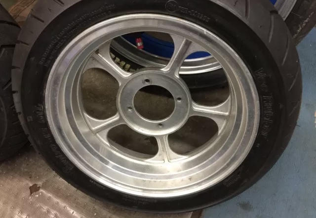

Hi, can anyone tell me what the Wheel offsets are on a Honda monkey (old type, not the new one). Can’t seem to find it anywhere on the internet.
I’ve measured a front wheel and think it’s 13mm. But does anyone know the back?
TIA.

The rigid frame z50a offset is different than the later swingarm models ( z50j,m,r,z). The hubs and wheels are different. I’ll measure it today on a later model and post here. Don’t have a z50a to measure.
Thanks, No worries. I bought the wheels anyway so will see if what turns up works!!

So they seem to be 12mm (1/2”) offset wheels. Both front and back. I thought the rear was gonna be a 4” wide, but they are both 3.5” wide.
