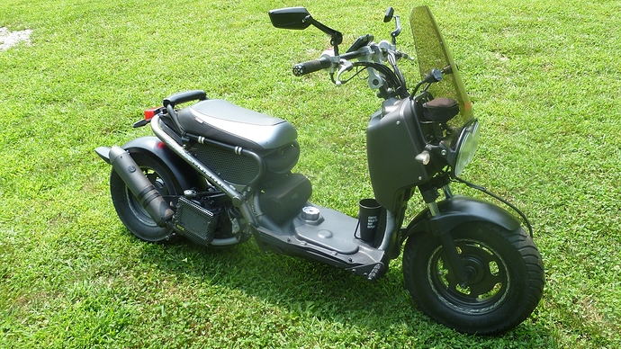

I had a 130+ page build thread on the old site. I’ll try to catch up with a paragraph. Still got the same old ruck. 08 stock bore GET, ported/polished/milled head. PC20 carb, Polini exhaust, lightened flywheel, NCY CDI. So many drivetrain mods I can’t even keep track. A weird Kitaco 5-1/4" stretch. HT Moto seat cover and Hoodrich tank cover, both of which are incredibly good quality. Almost all other cosmetic mods are DIY, no big $$ stuff. Does an honest 44-45 (GPS), level road no wind, untucked.

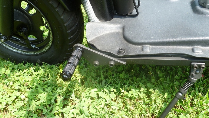

I like the front pegs solution.

Thanks! They’re comfy and plenty sturdy.
Just a couple of close-ups of my footpeg setup. 3/4" square aluminum tube, and risers cut from 1/4" aluminum.
If that’s square aluminum tube, er, what’s actually in that coffee mug??!!! :laughing:
Sorry, the contents of the cup cannot be disclosed on a public forum.
I like that these pegs aren’t drilled through the frame like the shop bought ones, and that they are fixed down through the tank / floorboard bolts.

So, the old ‘08 GET finally gave up the ghost. Found a good deal on a low-mileage 2016 and swapped it in. It wouldn’t handle the PZ20 off the old motor (it had some head work done to it). Went to a PZ16 with 38/78 jets and it’s running great! Feels good to be Ruckin’ around again.
