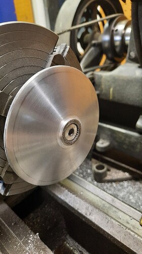

Machined my Kymco hub to be concentric with the wheel. Essentially i made an arbor out of a ruckus final drive gear, pressed the gear off of the shaft. Then I mounted and indicated it in using the 4 jaw independent chuck. I turned the raised section down to the same diameter as the hole in the center of the wheel. Once the diameter was correct, I took a light face cut to square up the assembly. I also shaved off the bump in the center because i dont like how it looks. You will see this called “hub centric”. All it is is making the wheel and hub concentric with each other.
Currently running 55mph at 10k RPM, not to bad for stock gears and a 130x90x10 stretched onto a 8" wheel. Have an old shaved drive face installed currently, the bottom end on it sucks, have a new one on order to mess around with.
Here is a small tool i made to shave drive faces. Its made from 300 series aluminum, used an m6 bolt to hold the drive face in place while it is getting worked.
