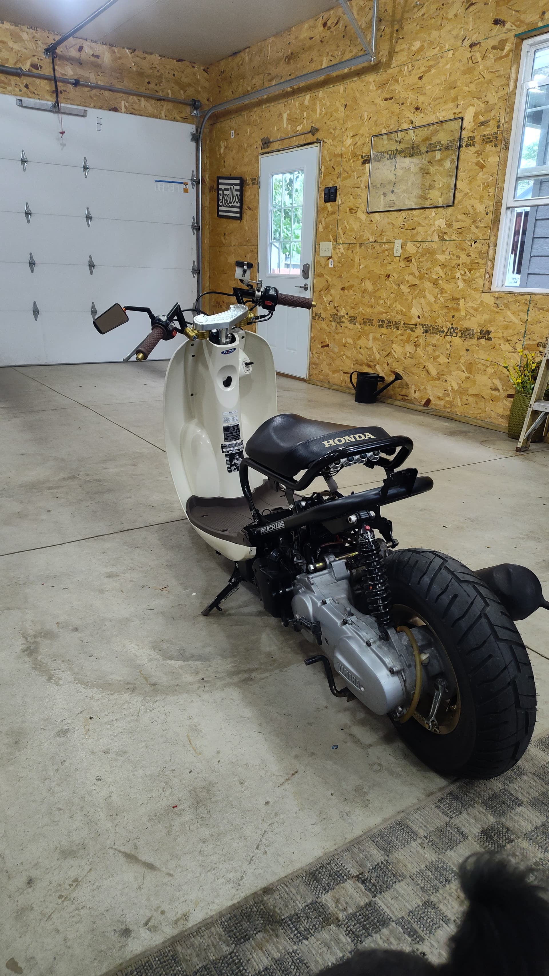

I was on the first total ruckus. Went to Super Sunday. From South Dakota. Only grandpa around here that mods scoots.

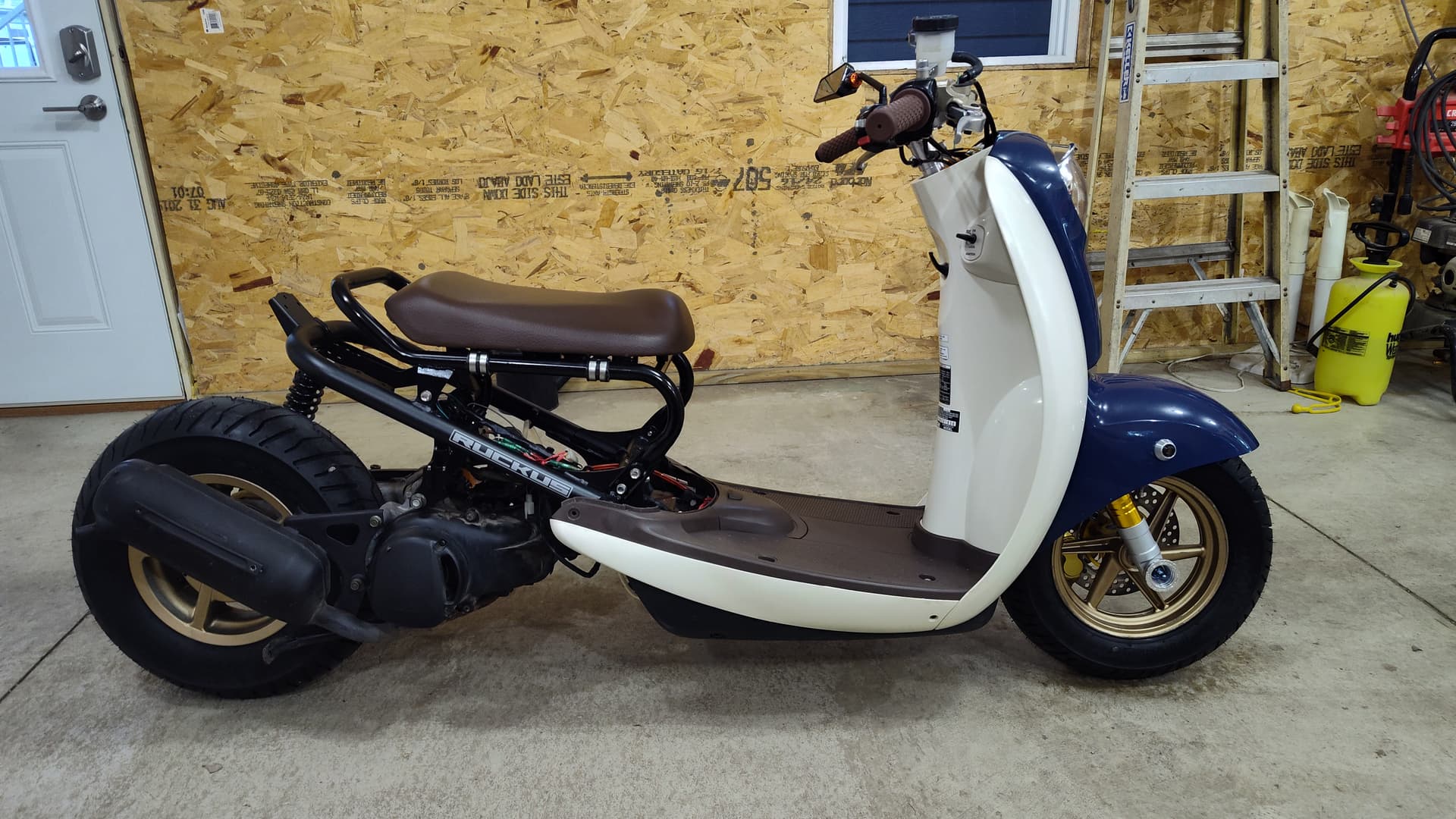

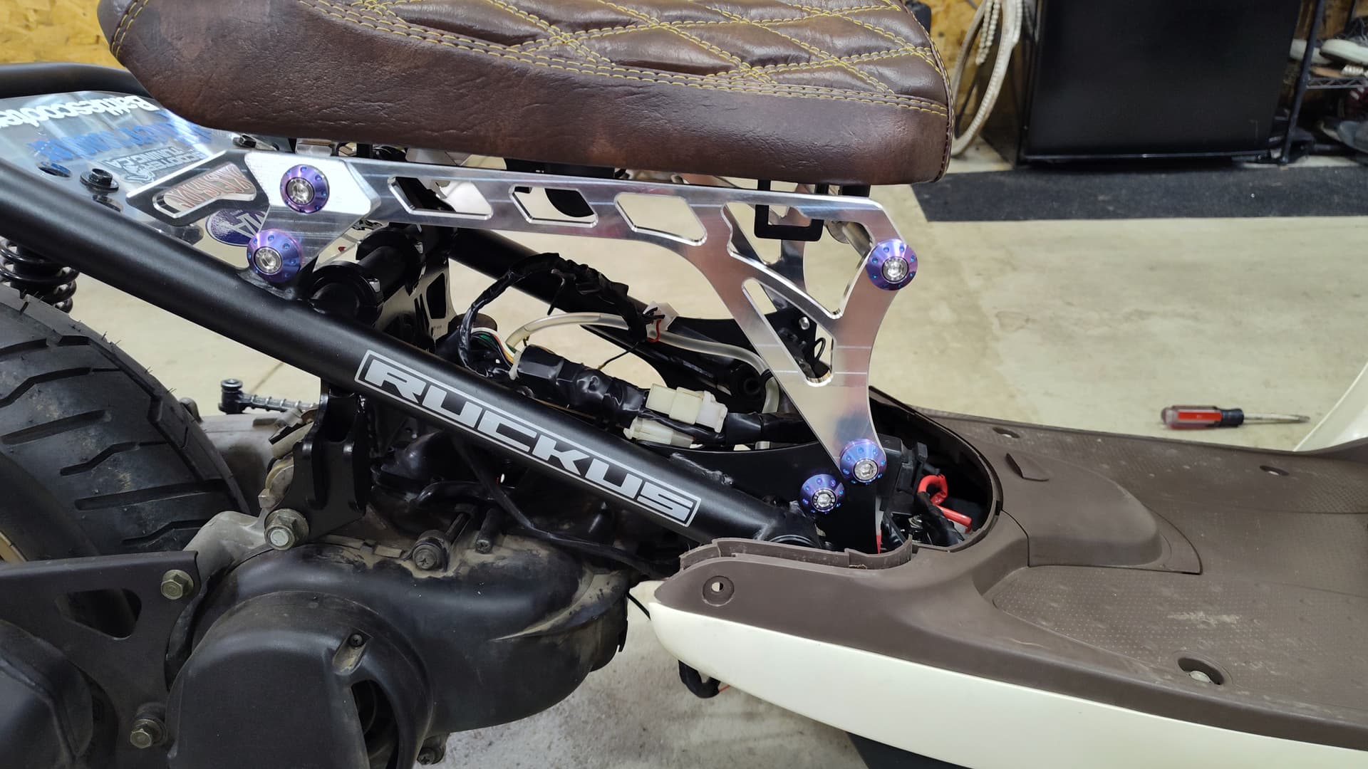

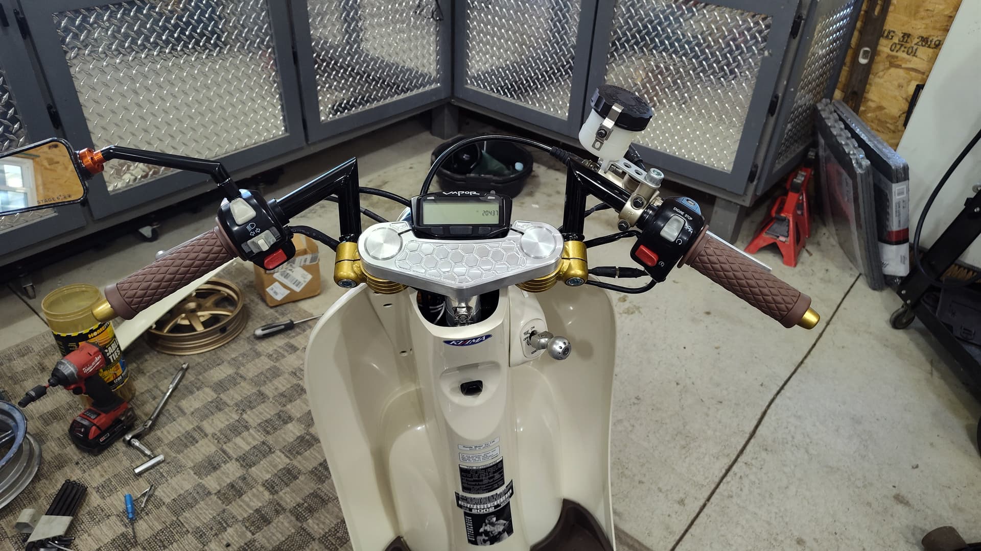

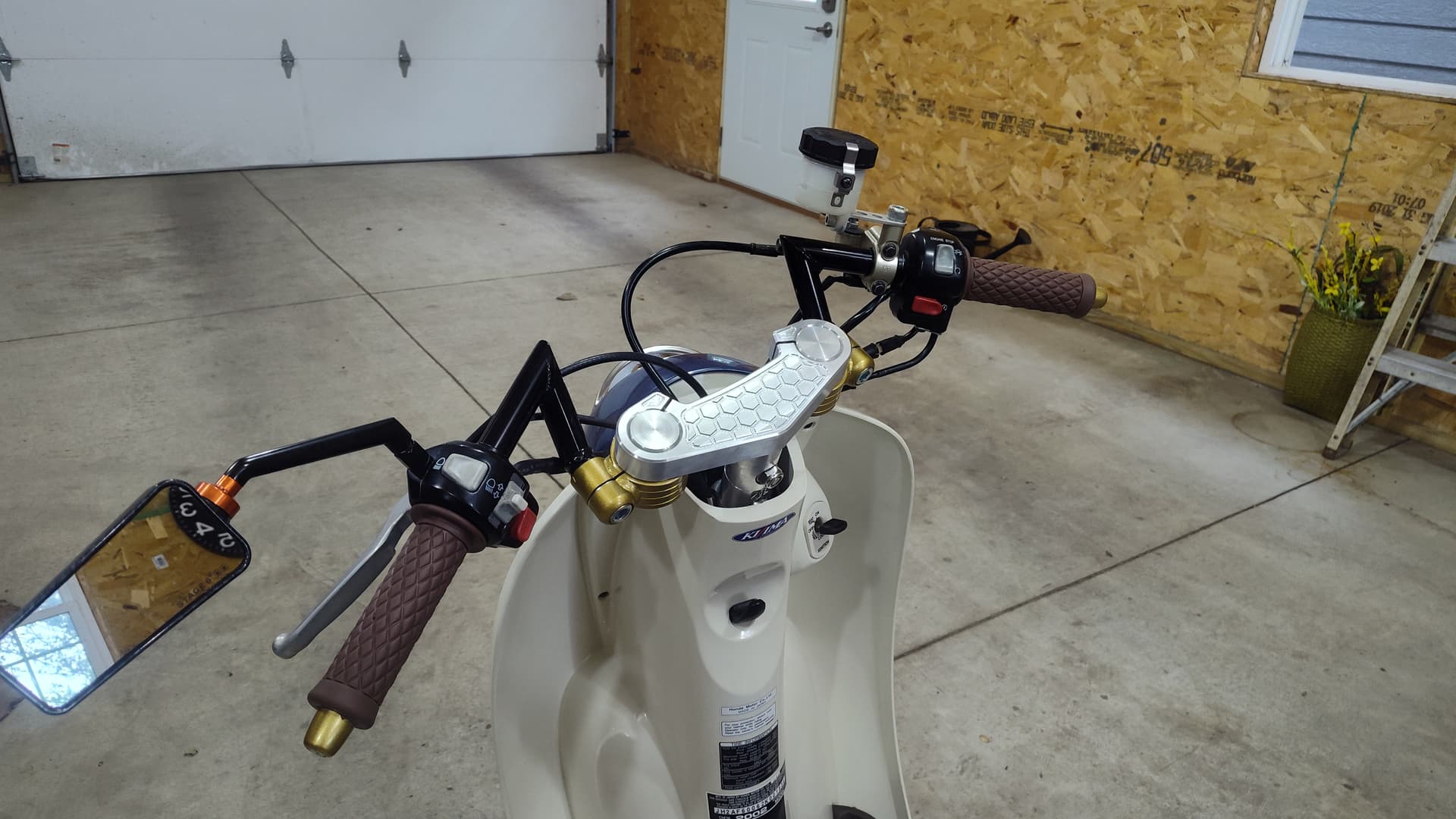

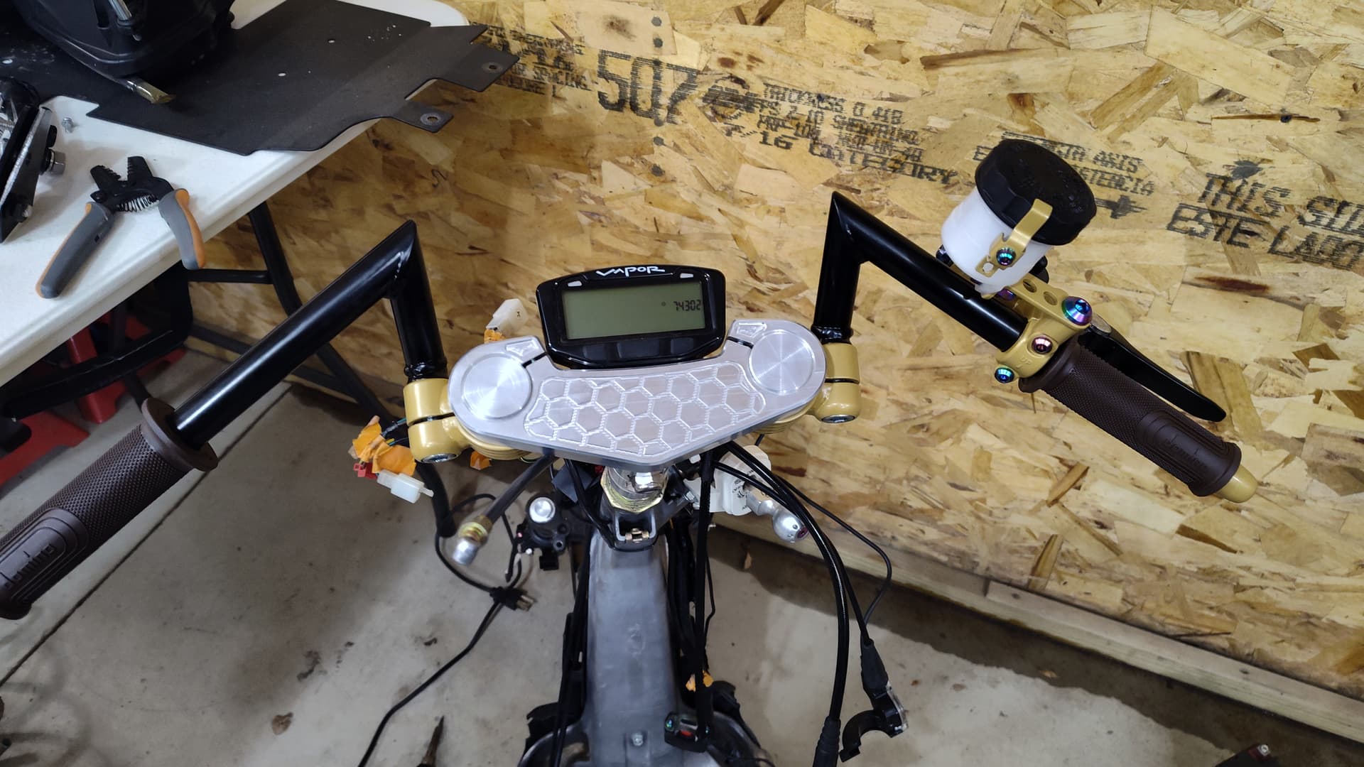

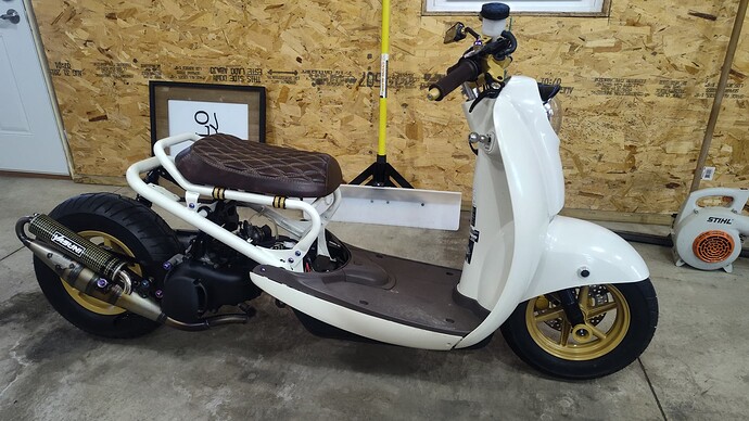

I’ve wanted these bars for as long as I can remember. I ordered zen bars then ordered aluminum round stock and machined it down to make these works. Enjoy
Ordered all my engine upgrades today as well. More to come.

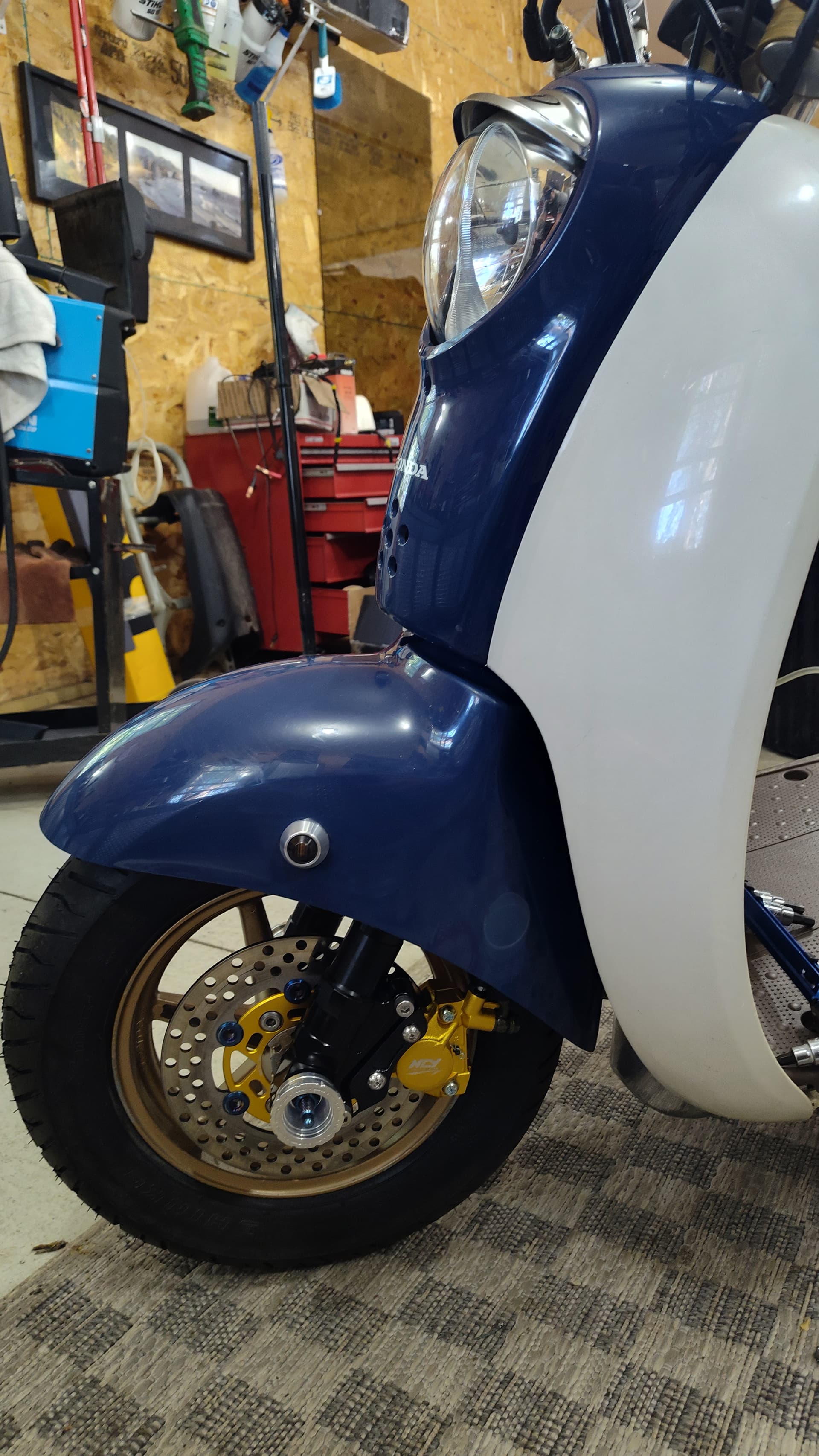

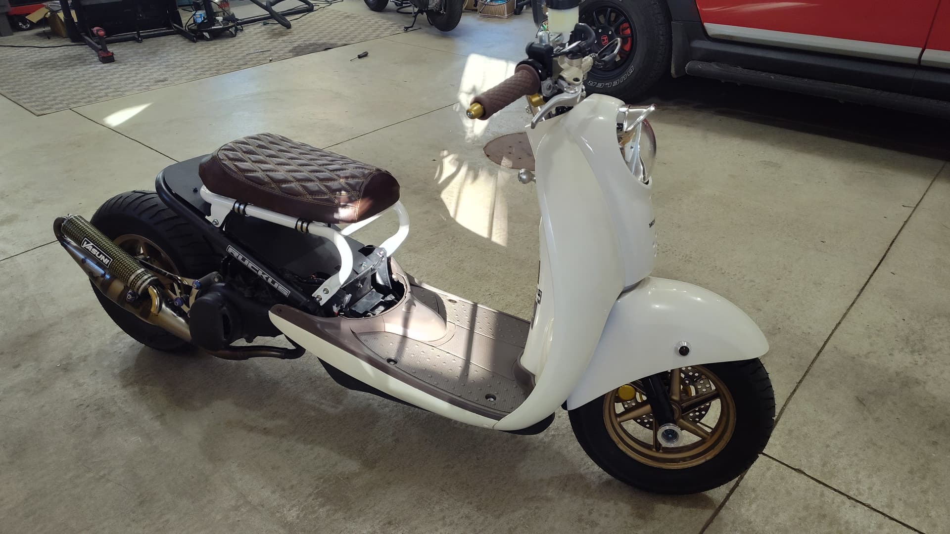

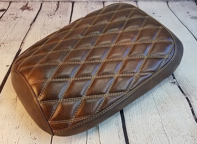

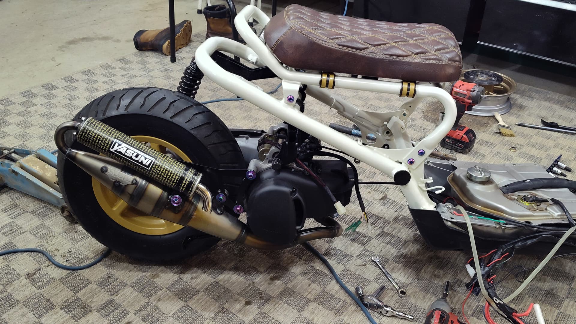

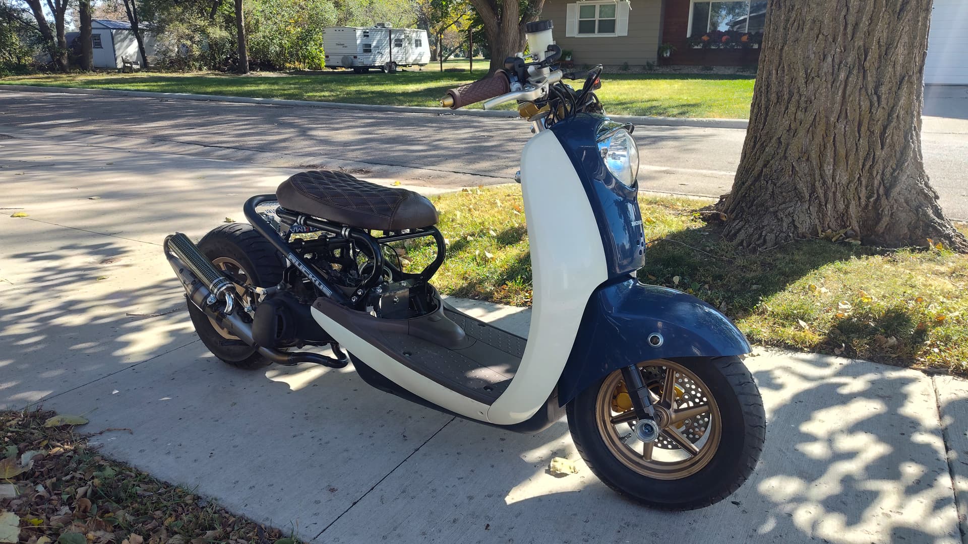

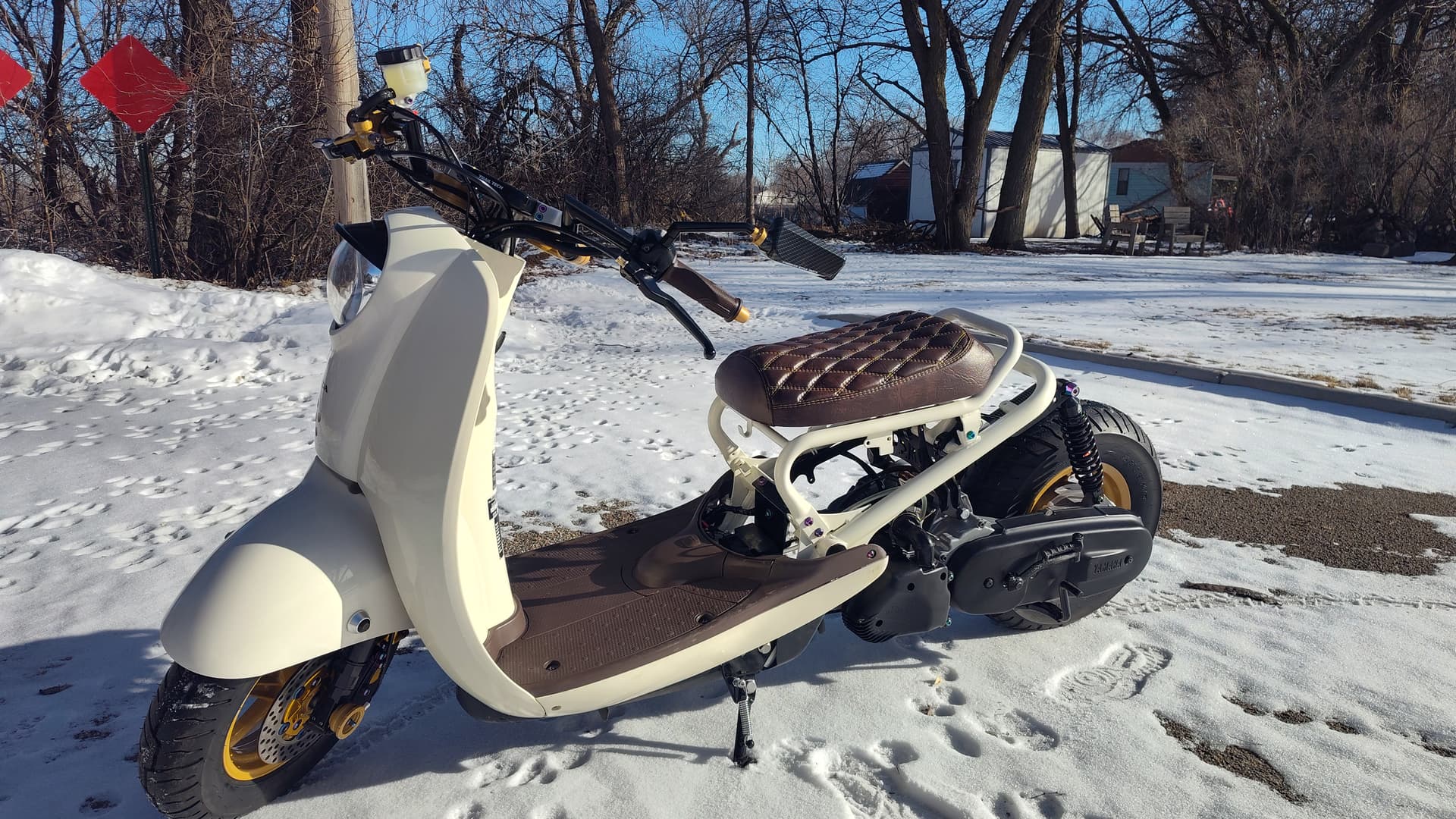

Just minor updates. Got my vapor installed and received my exhaust, big bore. Waiting for my cp 19 and jets. Figured out ncy caliper and bracket will work with ruckus forks. Ordered cheeky seats in tobacco and gold double stitch. Installed polini final gears . Just waiting on some flp parts and ready to ride it till winter then full strip down and powder and big bore.
Got my flp seat in slowly coming together, finally cut my kijima kickstand down to actually work too.

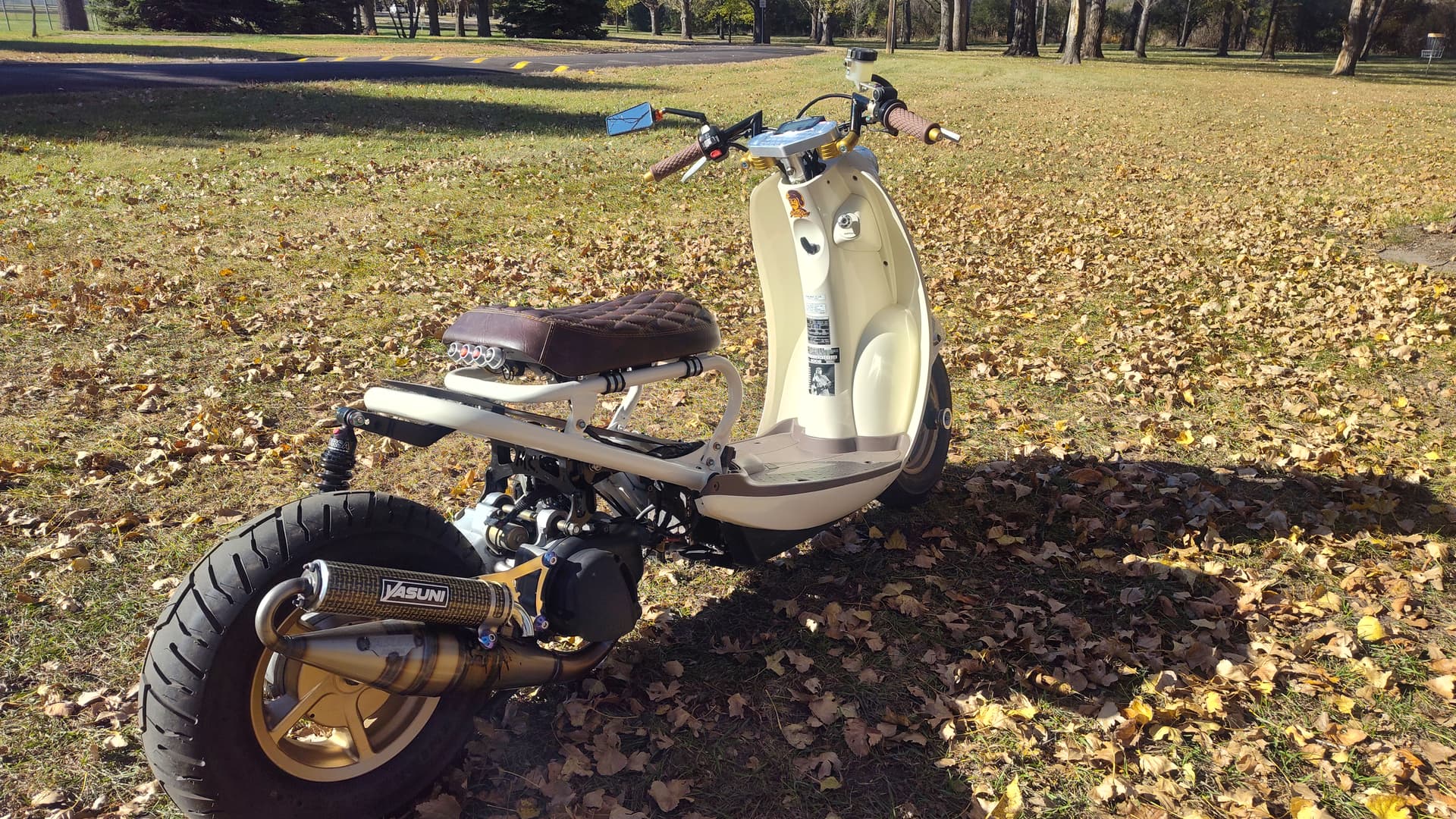

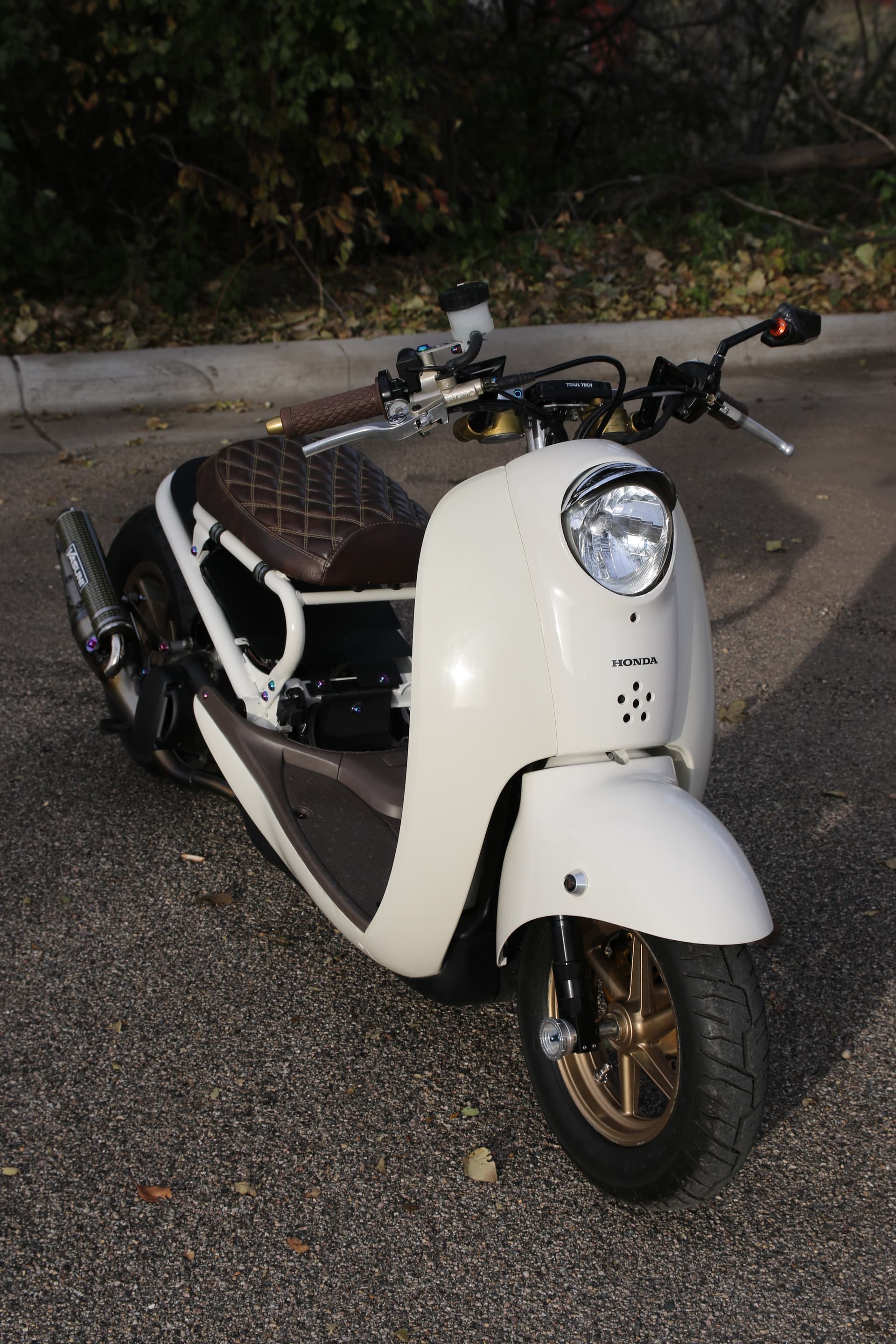

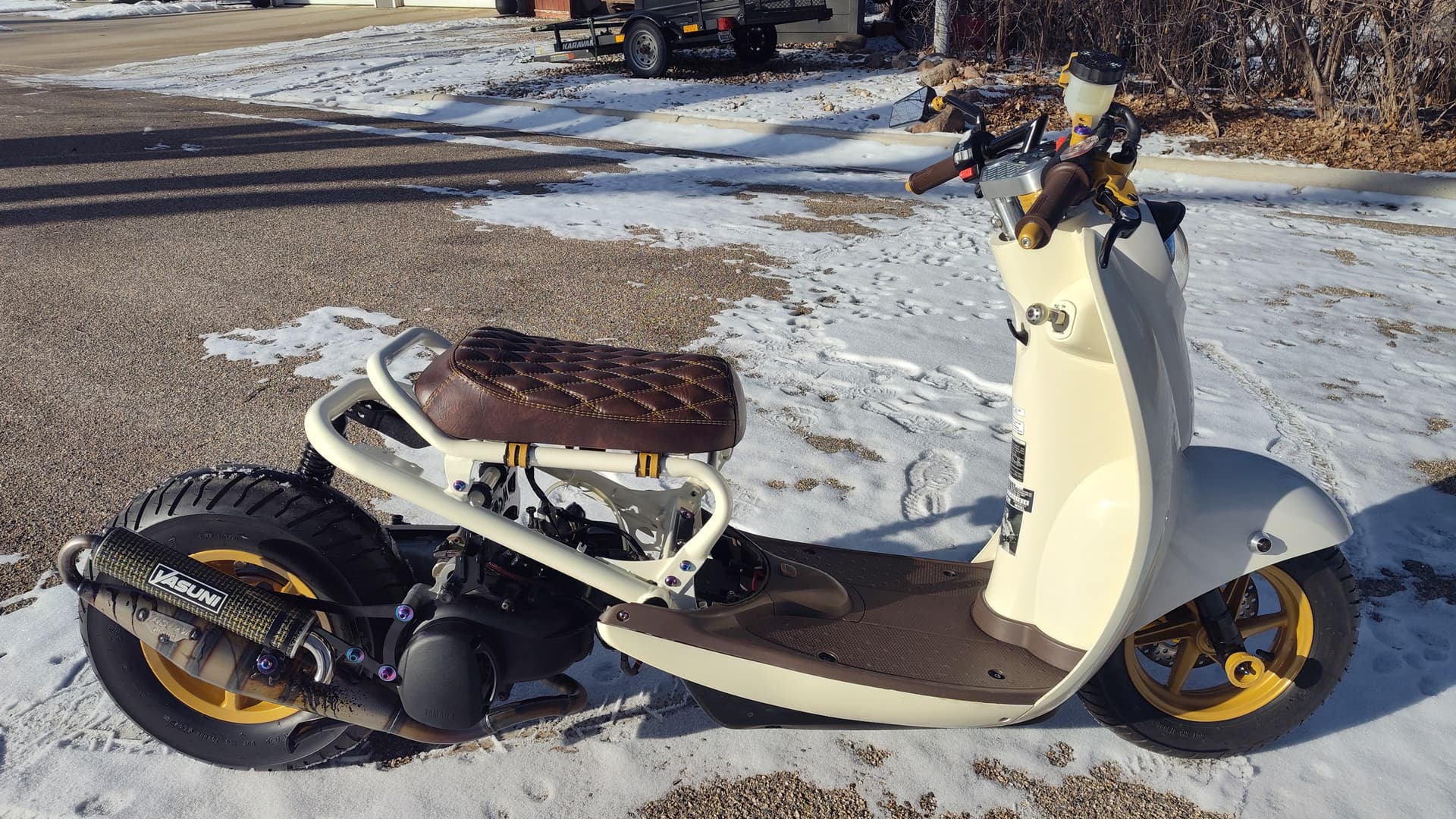

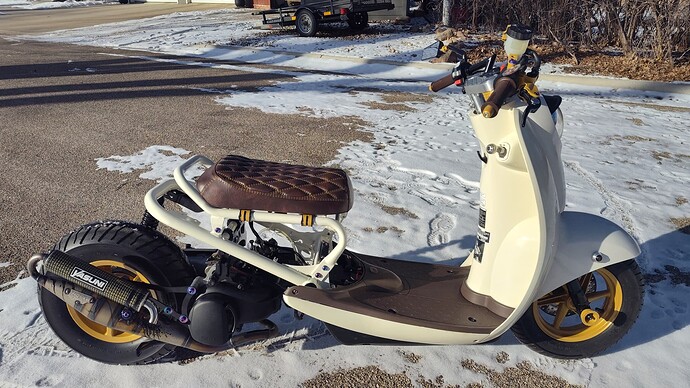

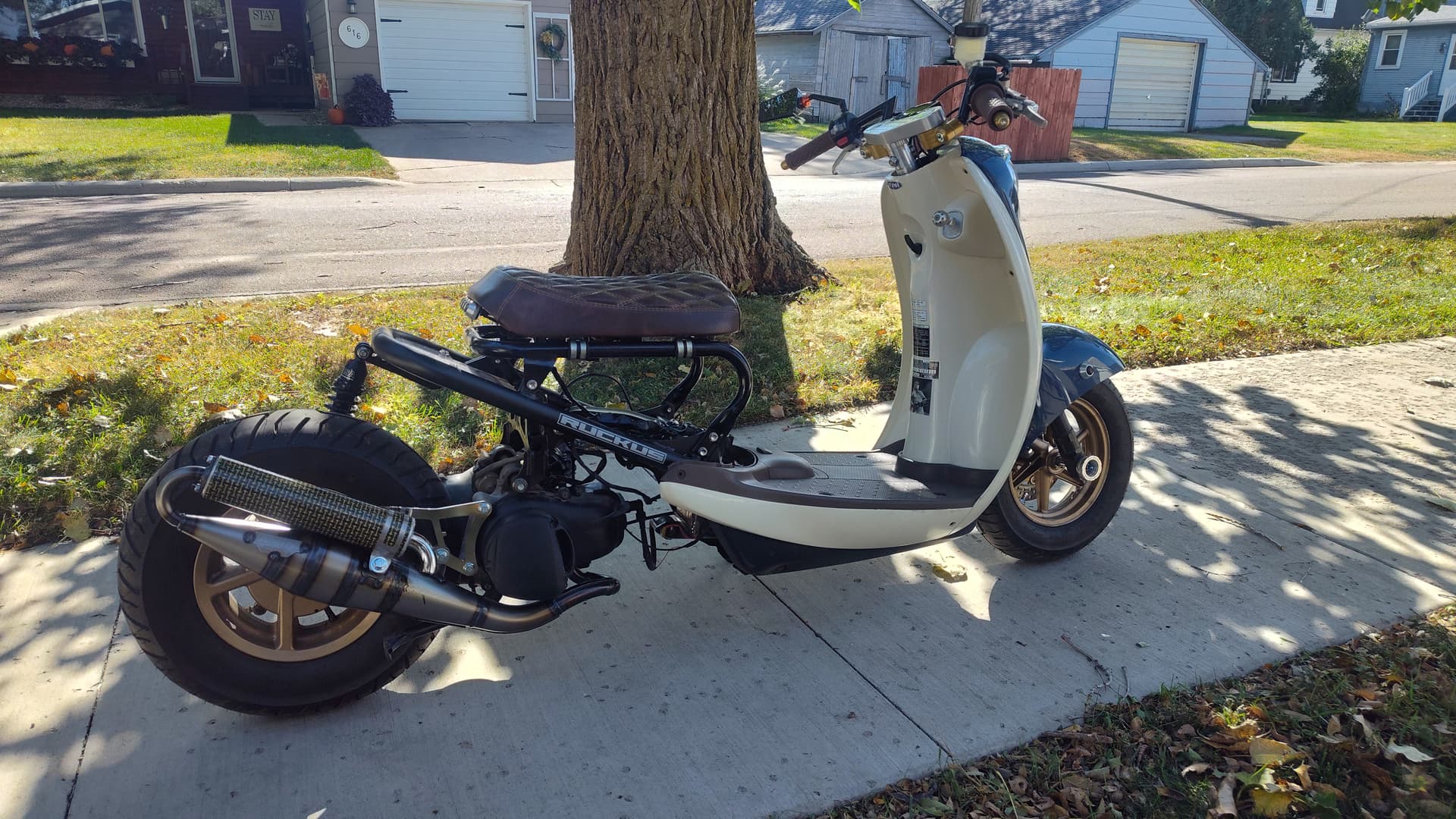

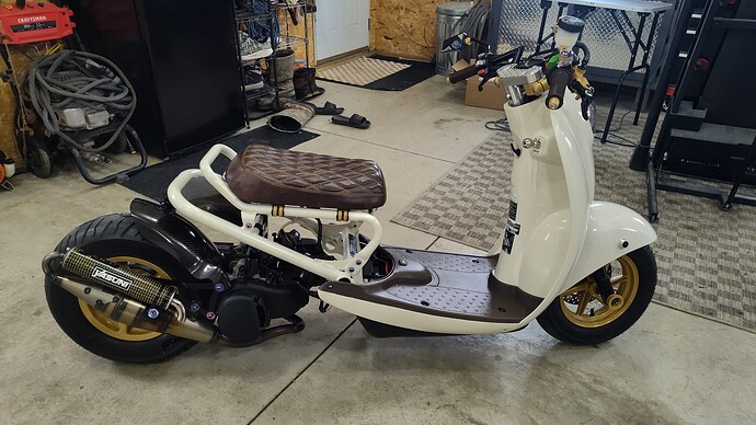

More updates. Installed stage 6 intake and reeds, polini 3g clutch, polini cp 19, yasuni z exhaust and polini 70 cc sport. Gotta do some more dialing in but love it so far. Just breaking in the new kit so no hard riding.

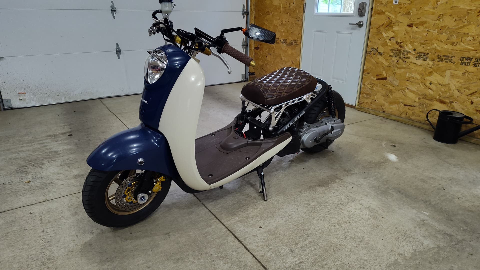

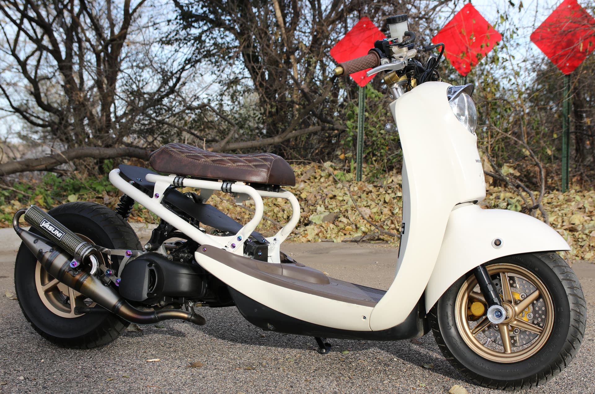

Changing up color scheme. Runs great and plenty fast for my needs. Just trying to decide if I do classics white or championship white in the rear

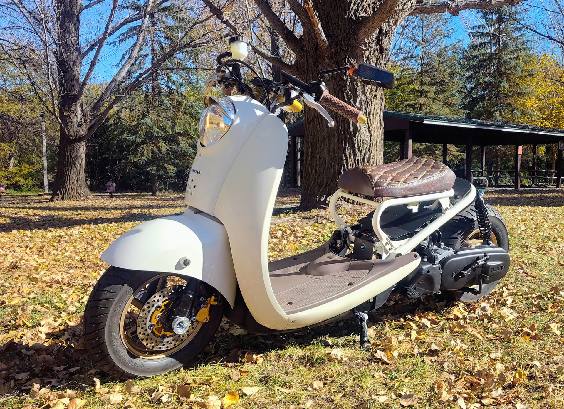

Championship white is too white. Lucky 4 years ago I restored a Yamaha tw. And the white paint is a perfect match for it. I was dreading trying to find the right white to go with it. This is much better

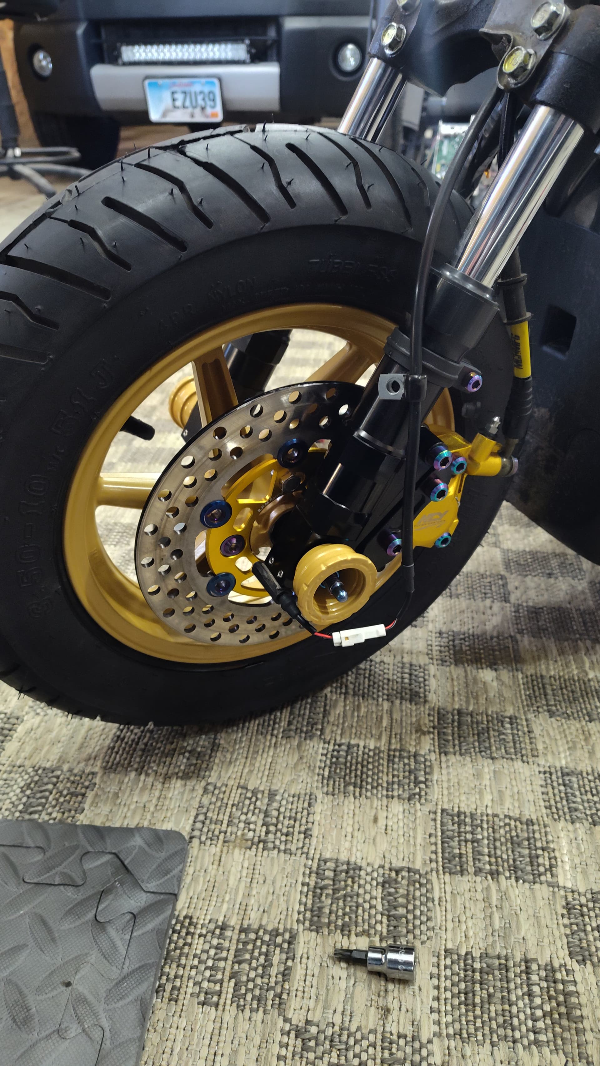

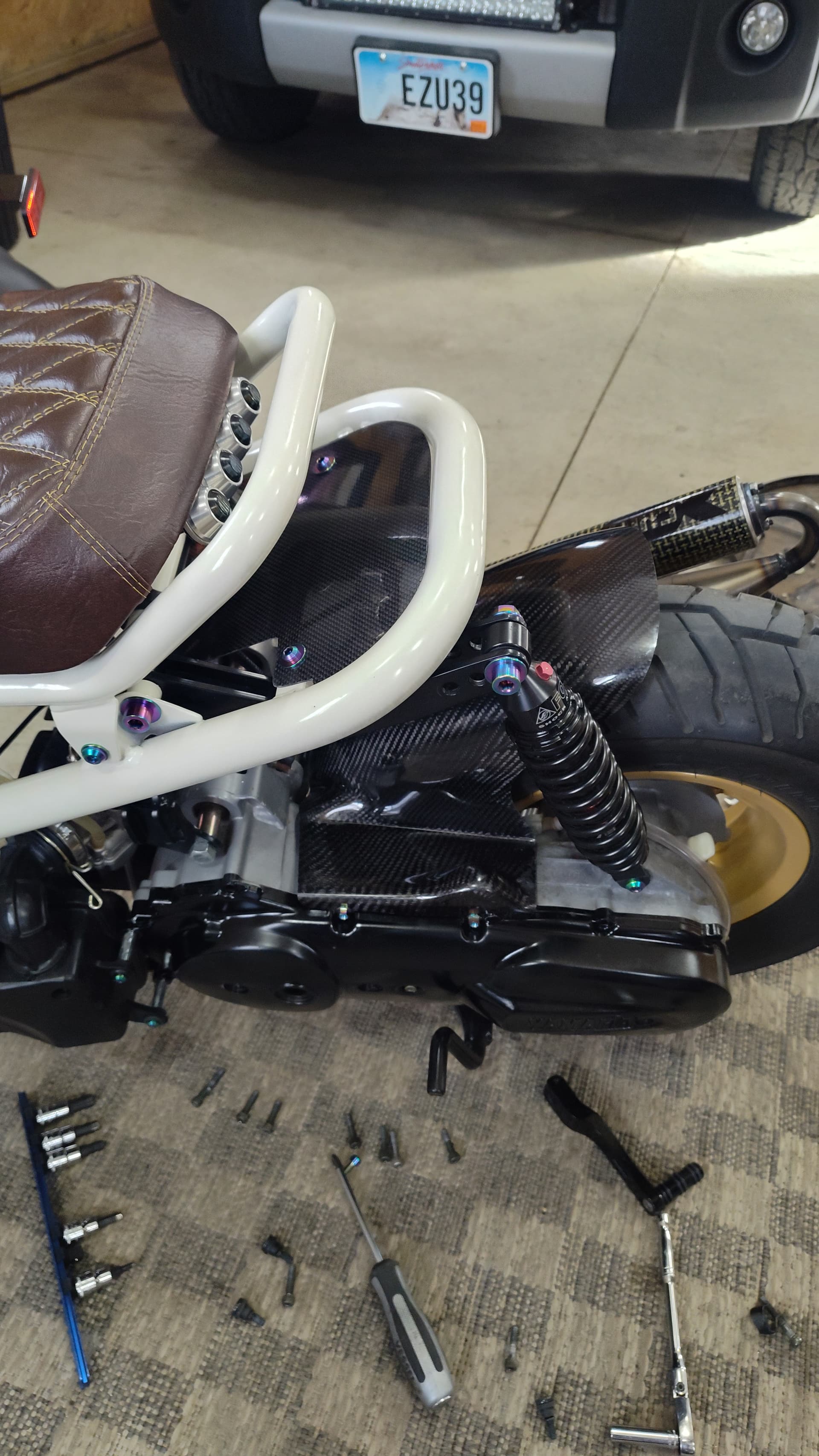

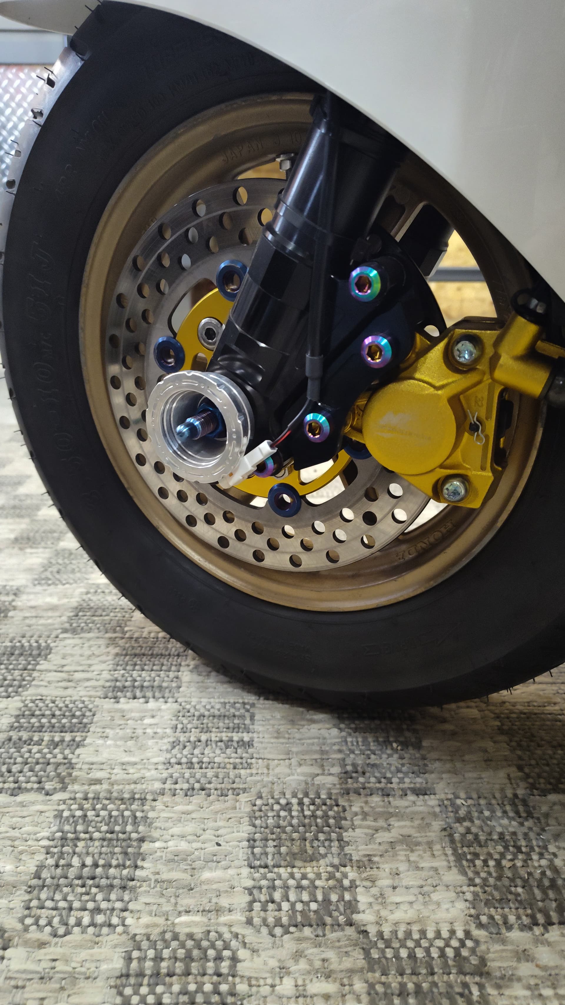

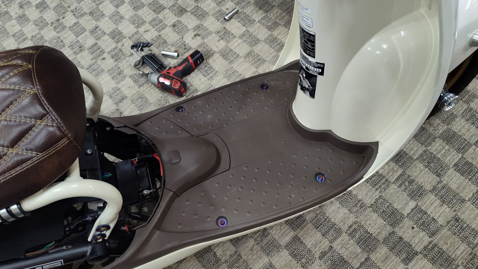

Got more of my titanium bits in too. Wanted it to match everything I put on it. Burnt was the call

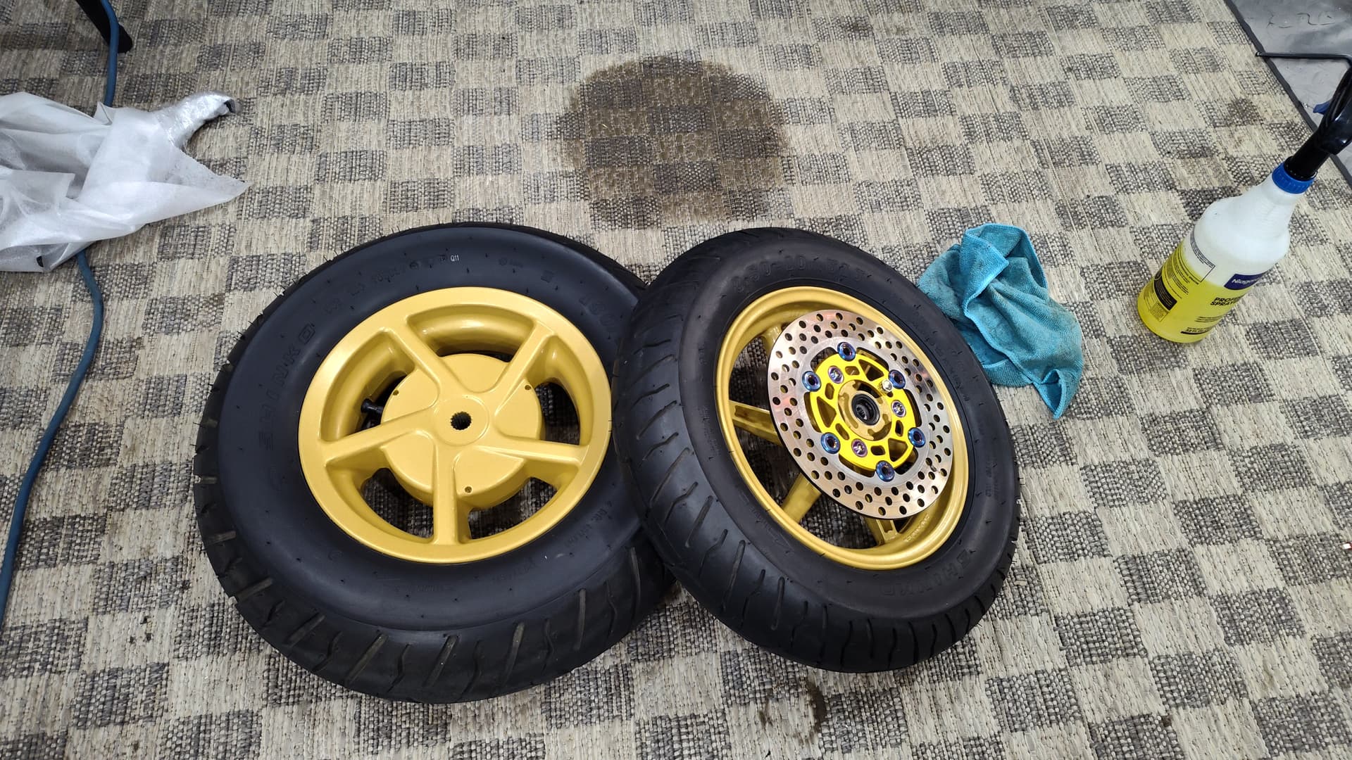

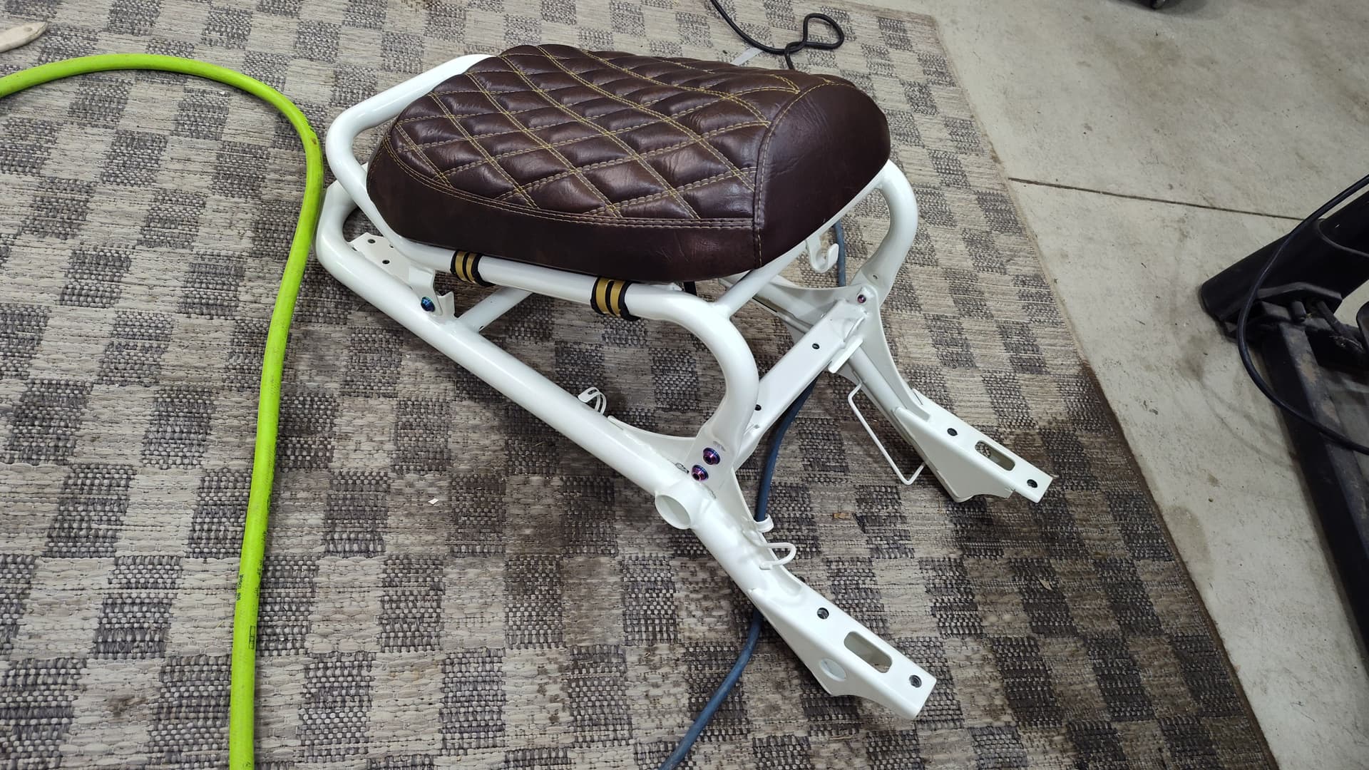

Done for a bit. This winter powder more parts
Processing: 1000003309.jpg…

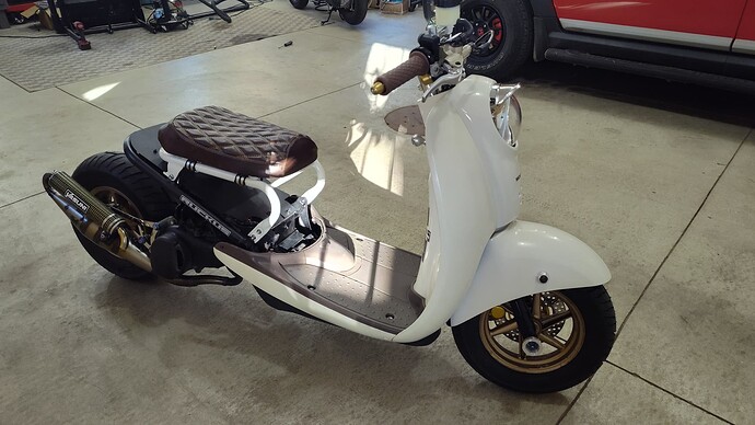

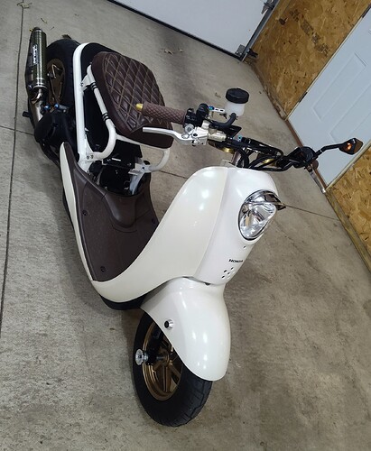

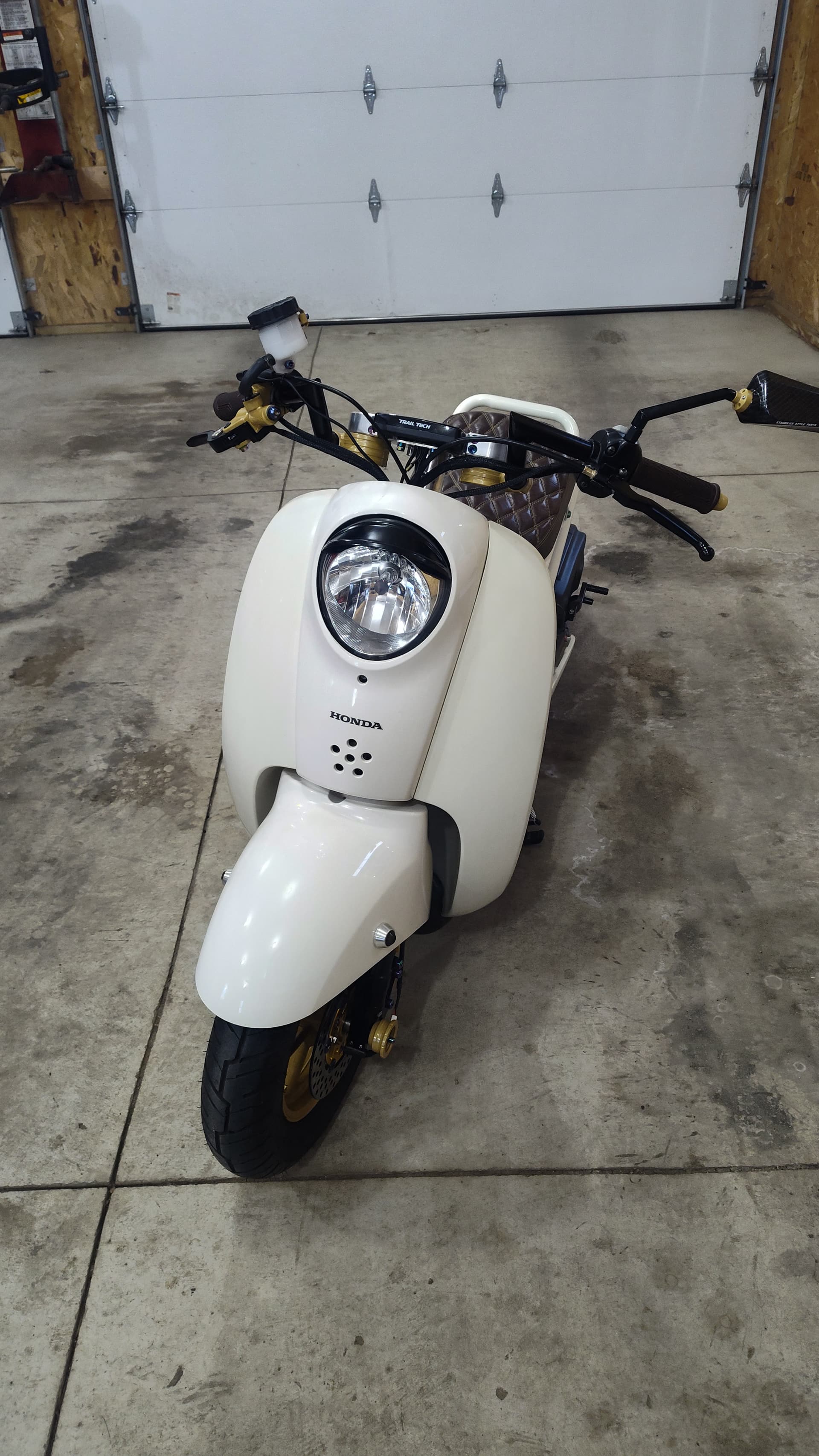

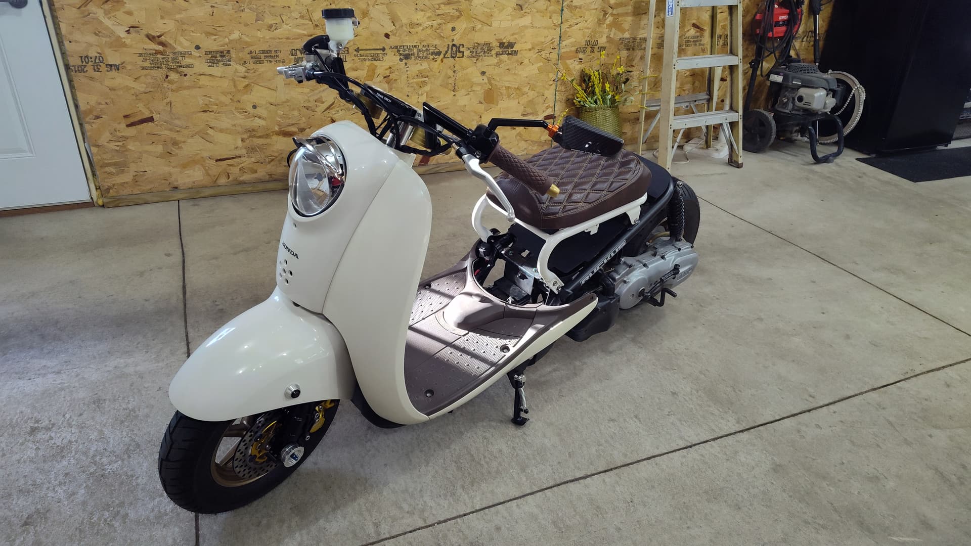

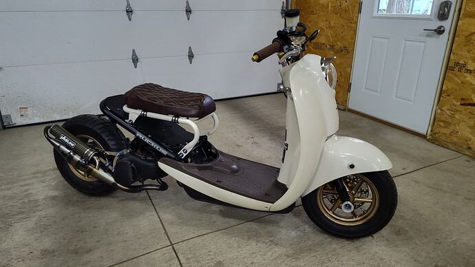

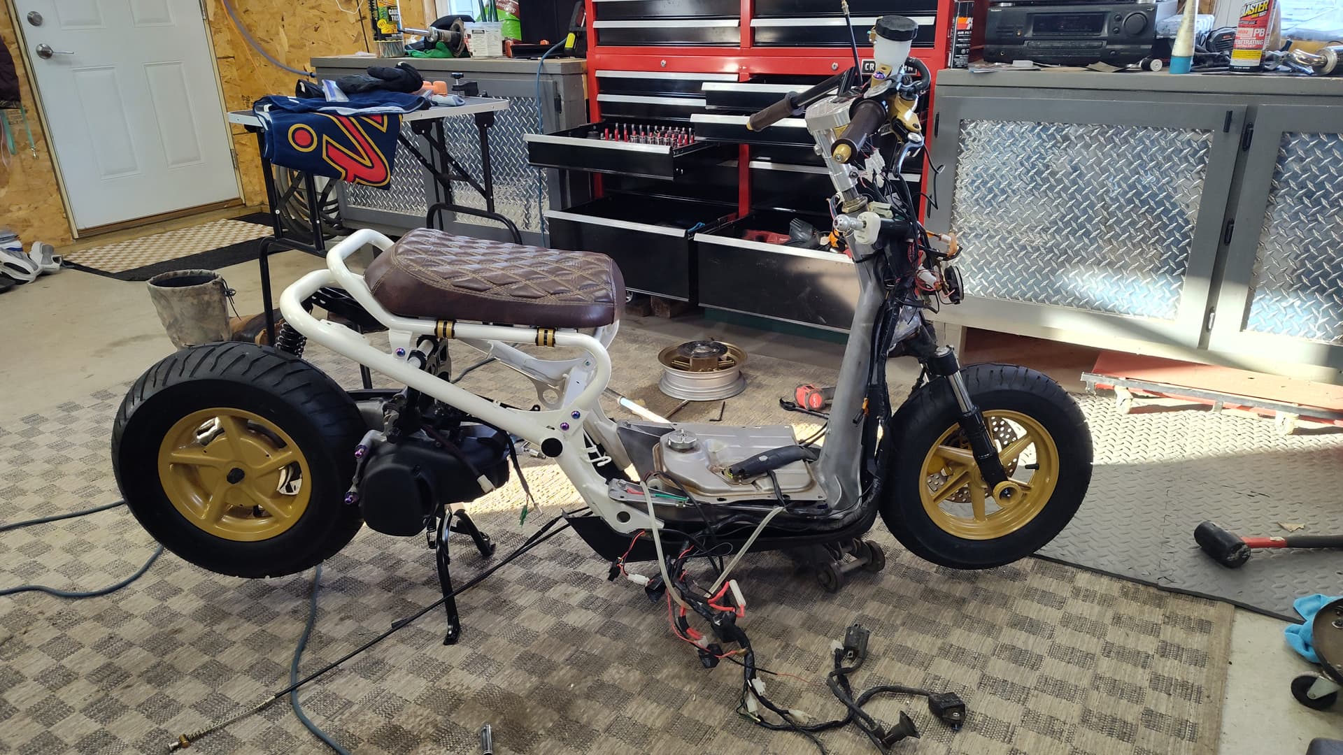

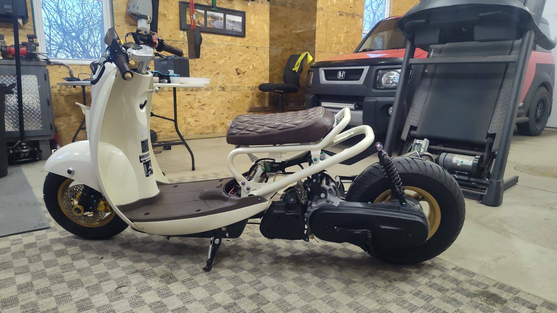

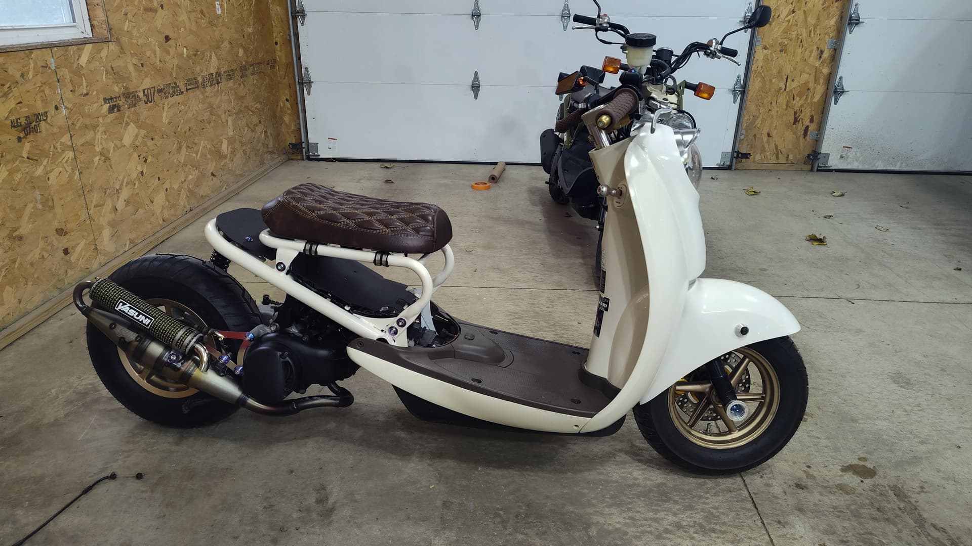

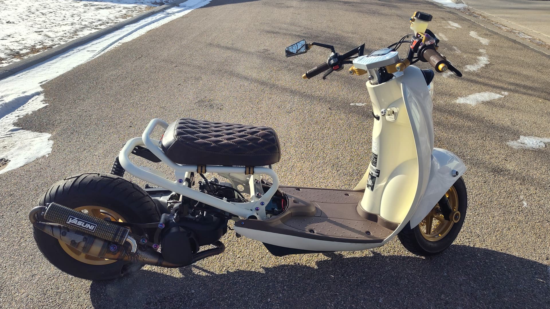

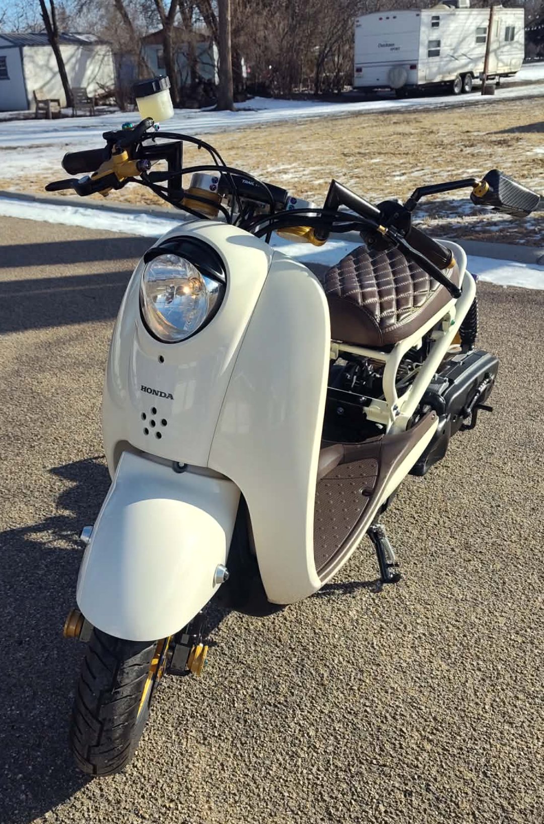

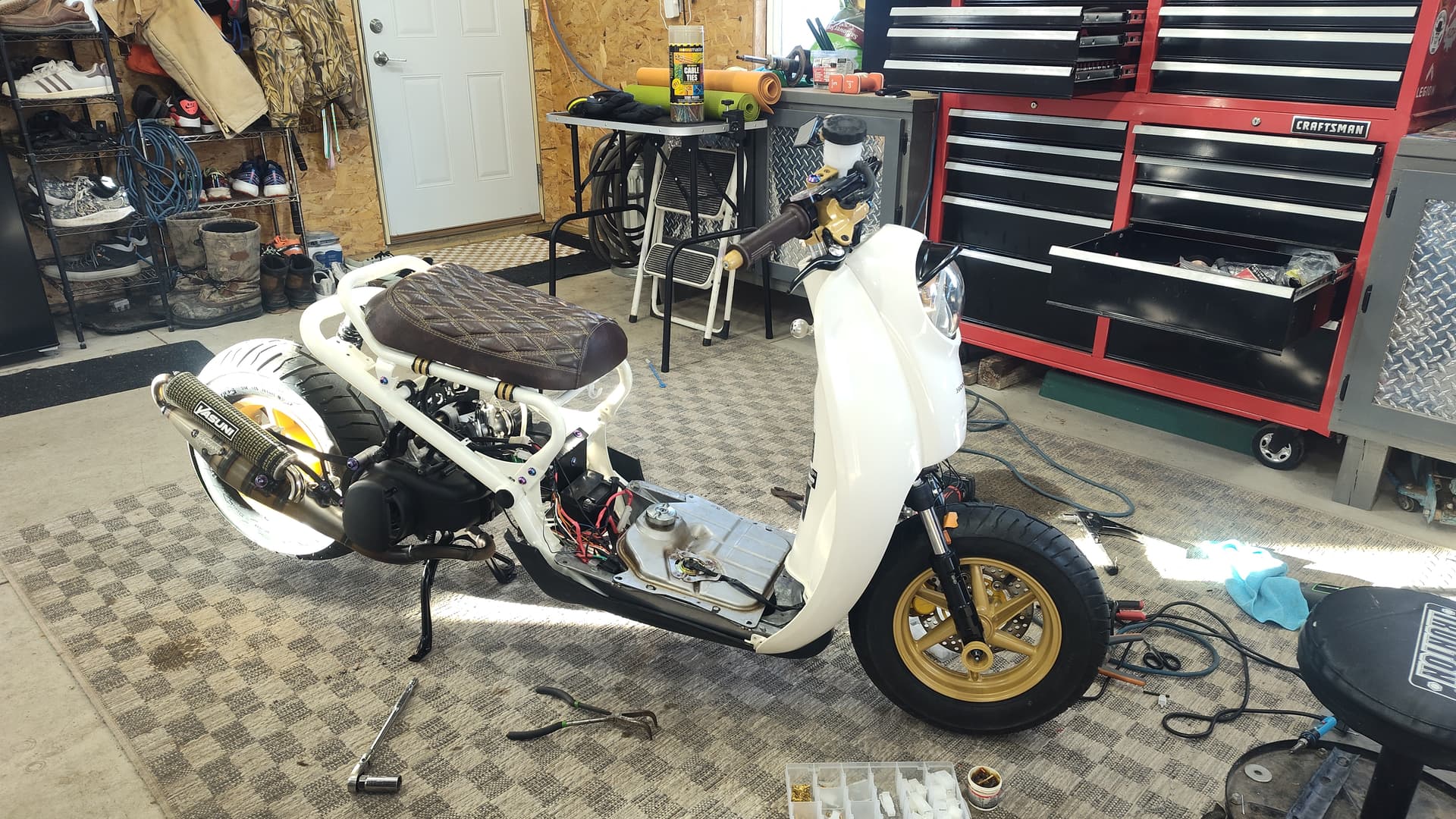

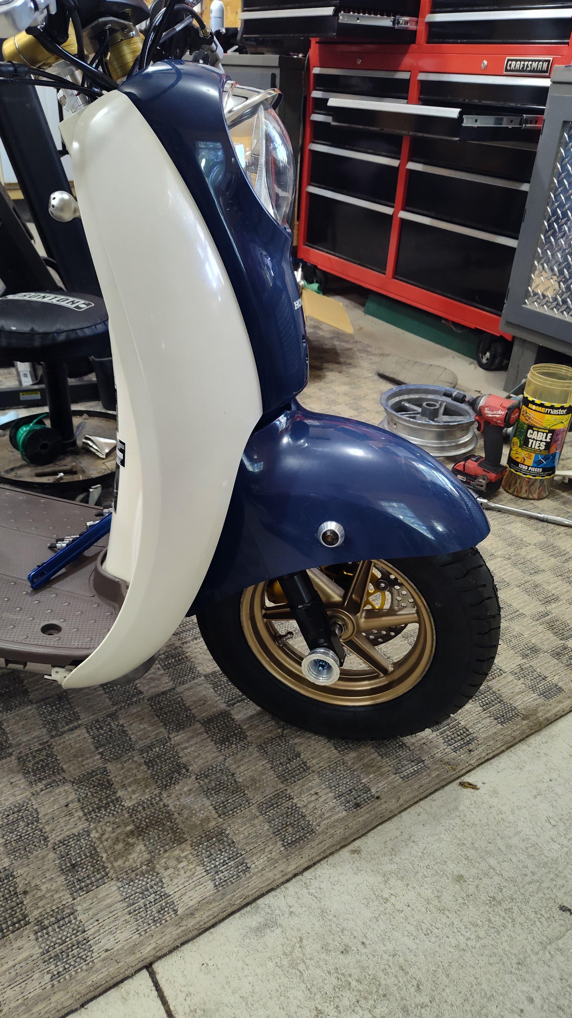

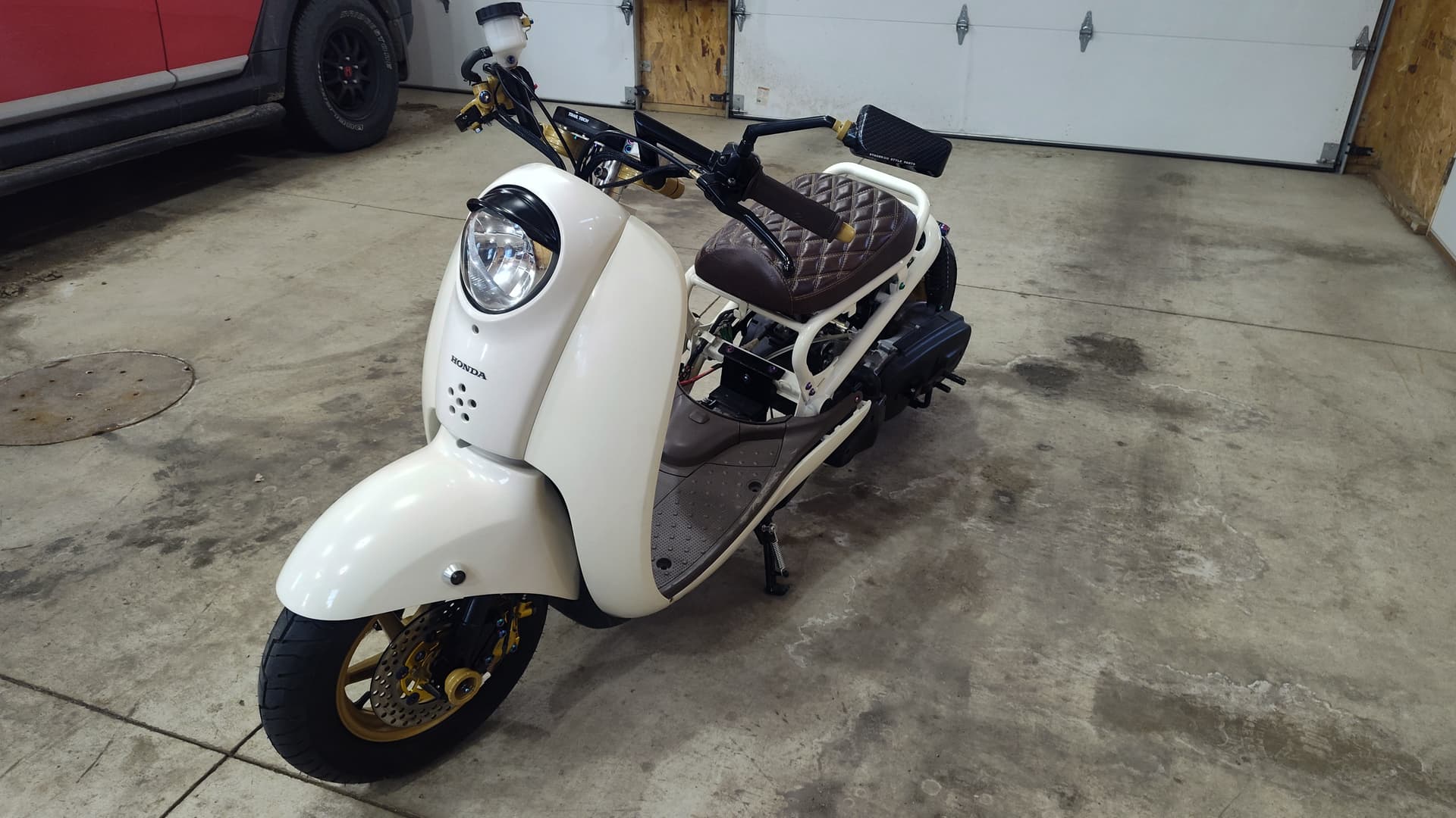

Decided to tear it all apart and just do some minor tweaks. Found a powder to match up the met classic white plastics. And decided to go off the track with the new gold color. At first I thought it wouldn’t work but after getting the plastics on it all came together. Them decided to work on the wiring, since I built it I just threw the harness in without modifications. Well got rid of tons of wires not used and shortened up and wire loomed to make things look more professional. It’s not 100% done and plastics are just sitting there but you get the idea. I wanted to build a clean bike and when you walk up then you see all the little things that doesn’t make it look to busy.
![1000003482|690x388]

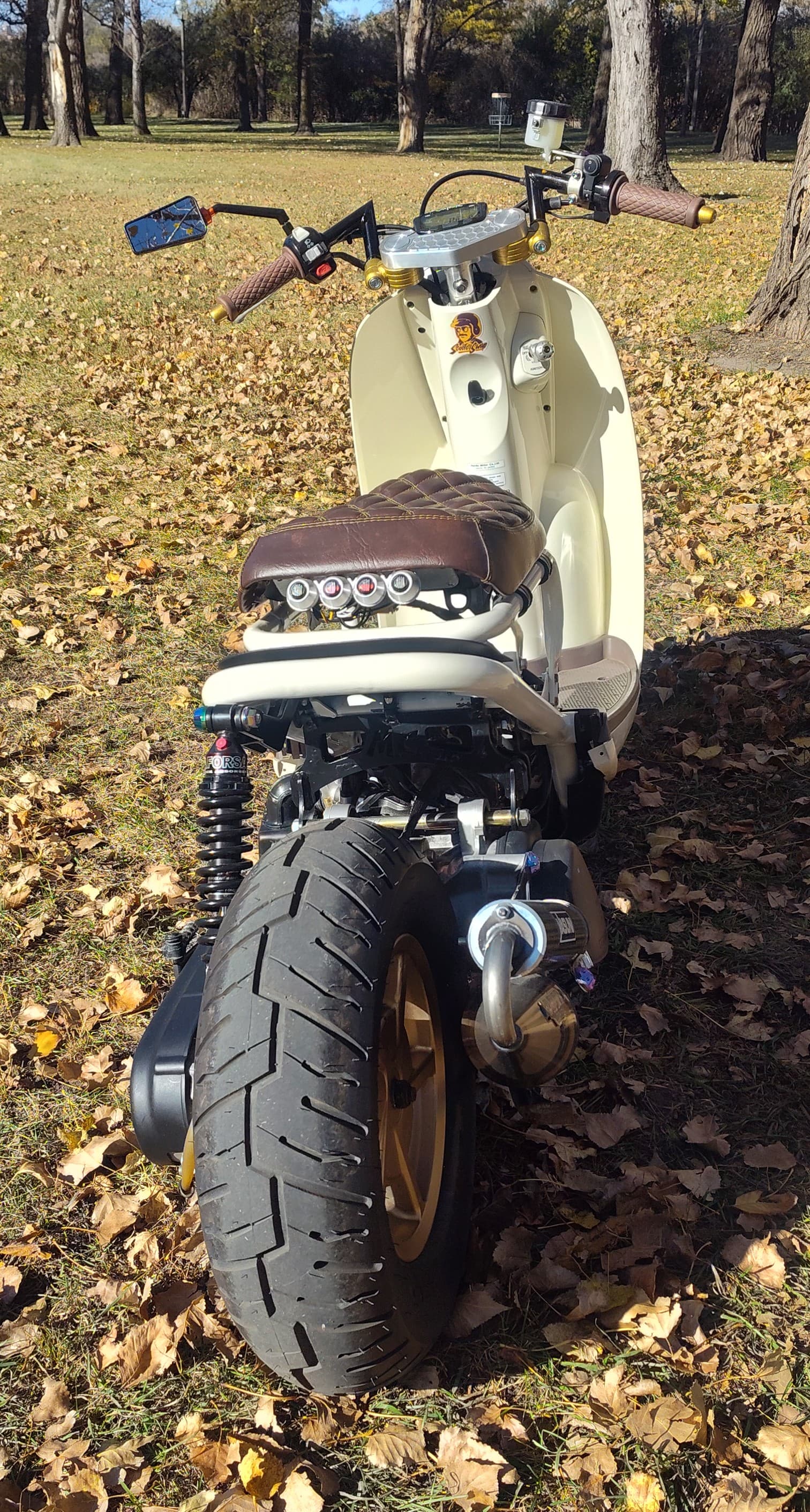

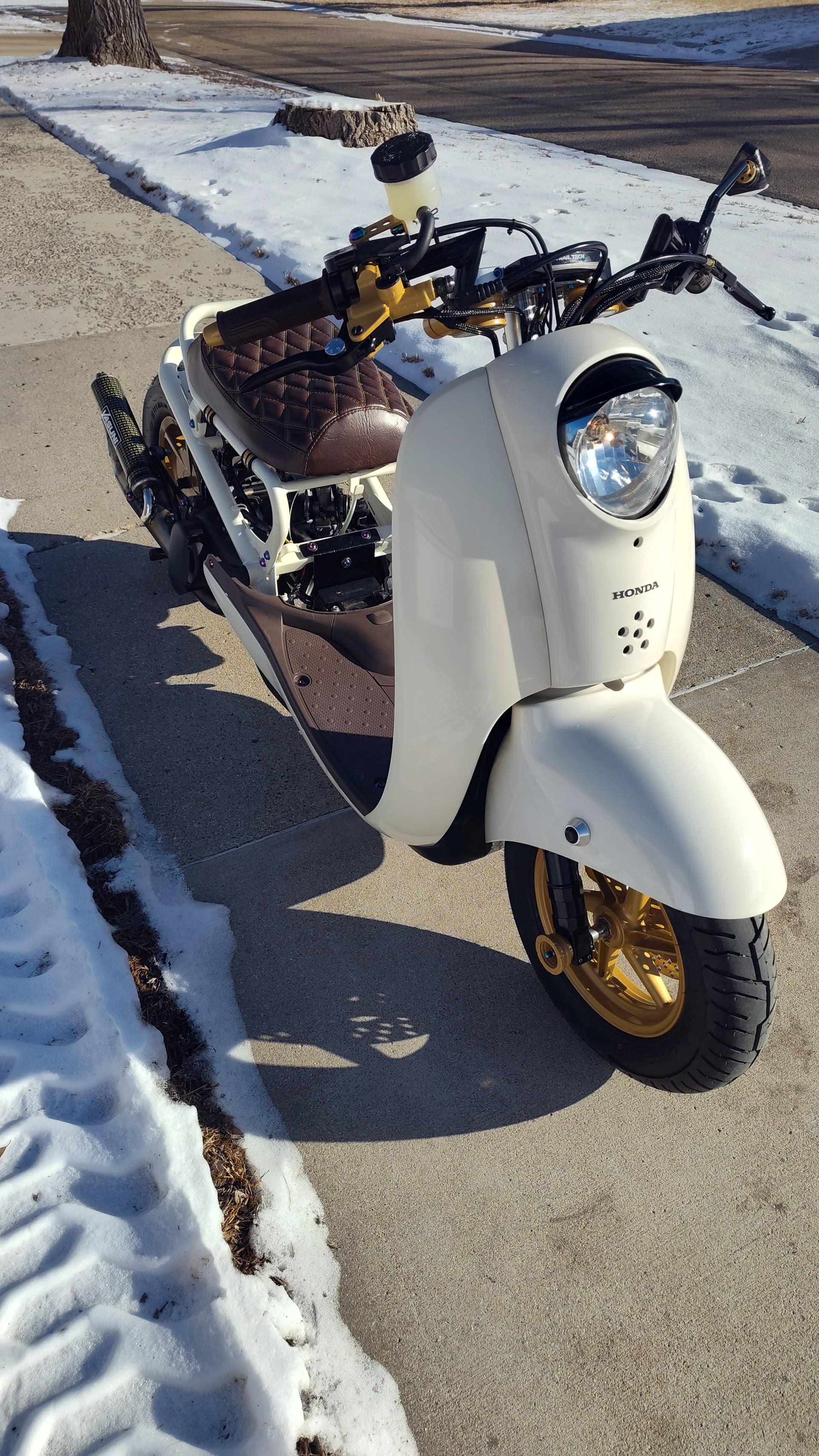

Finally got the rest of my stuff in. Got sick of stripe up my back.
