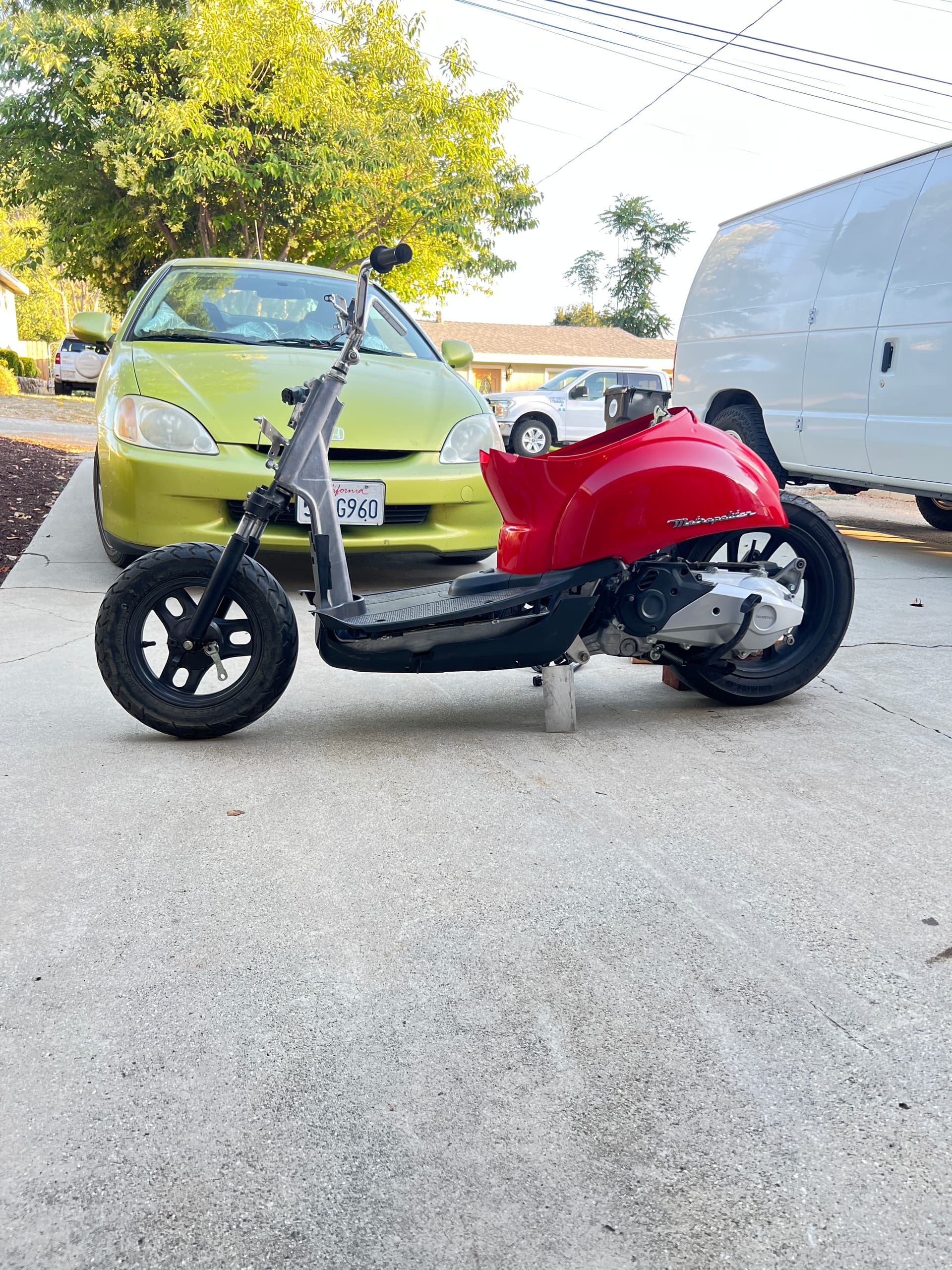

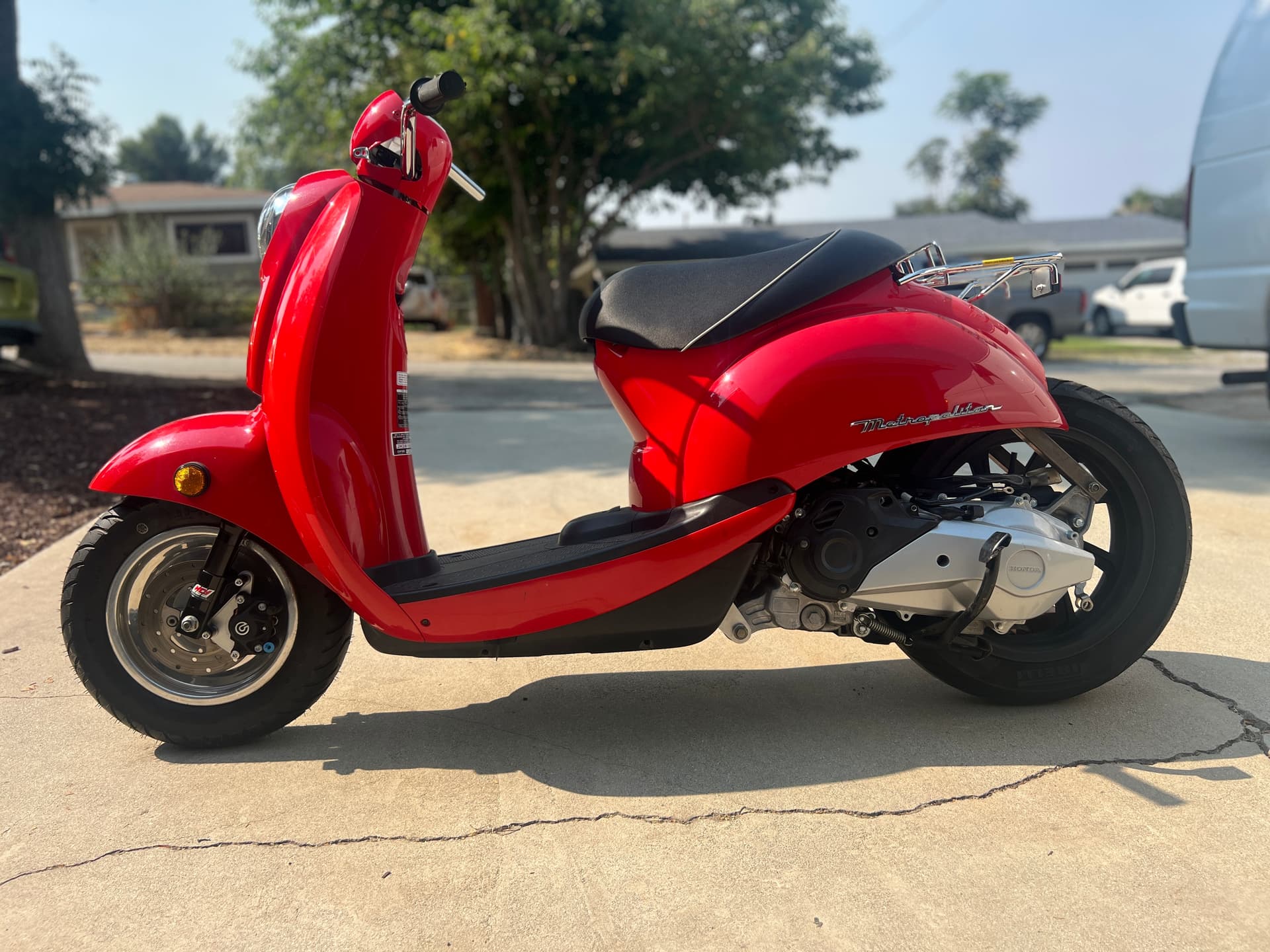

First post , sharing my pcxmet build . Figuring it out as I go. I had started sharing on fb group page but this is better for timeline
Stock met. Pcx engine. Only seen a couple with not much detail to what needed to be done so hopefully this helps others :slightly_smiling_face:

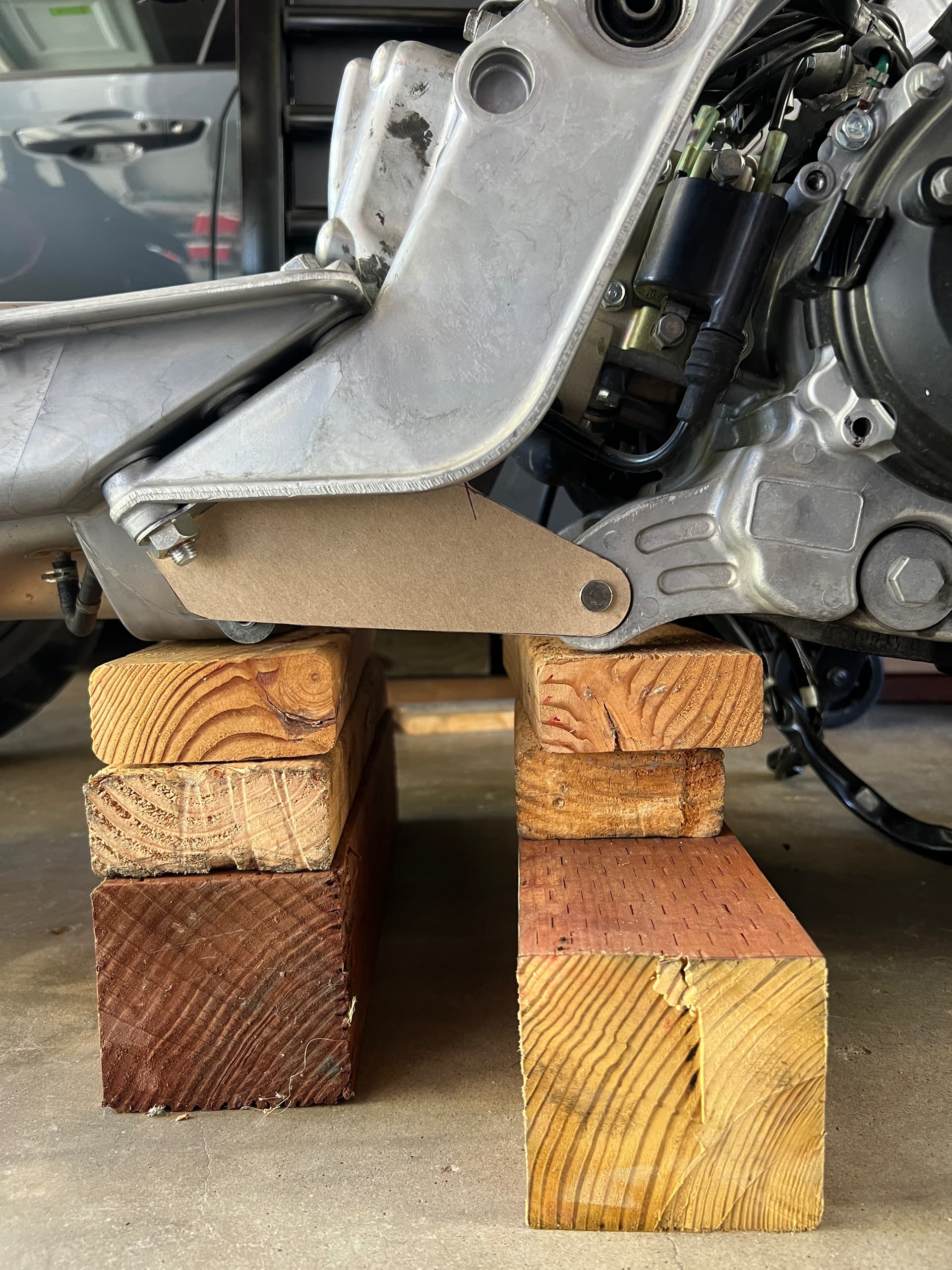

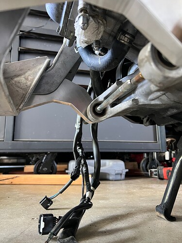

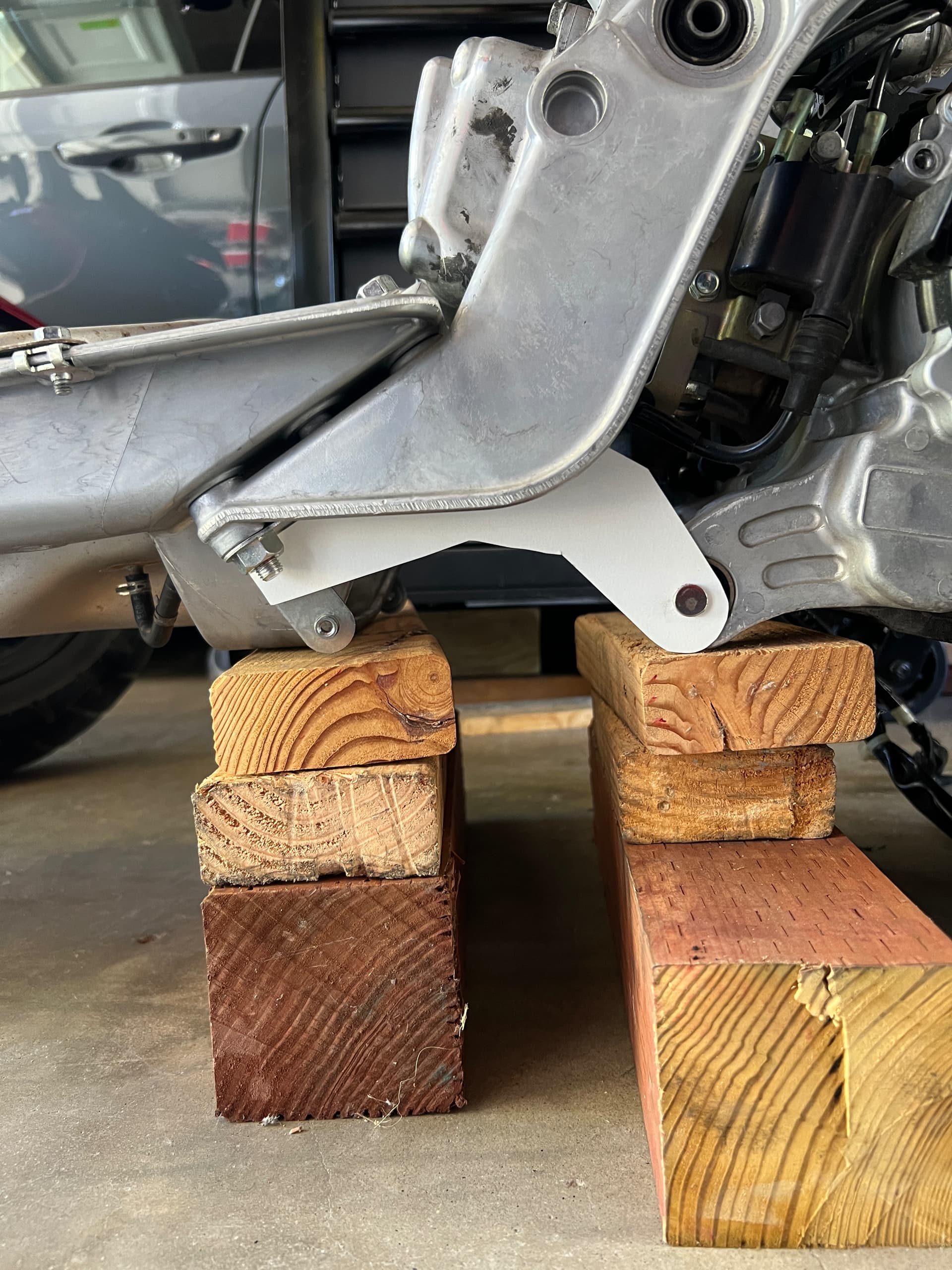

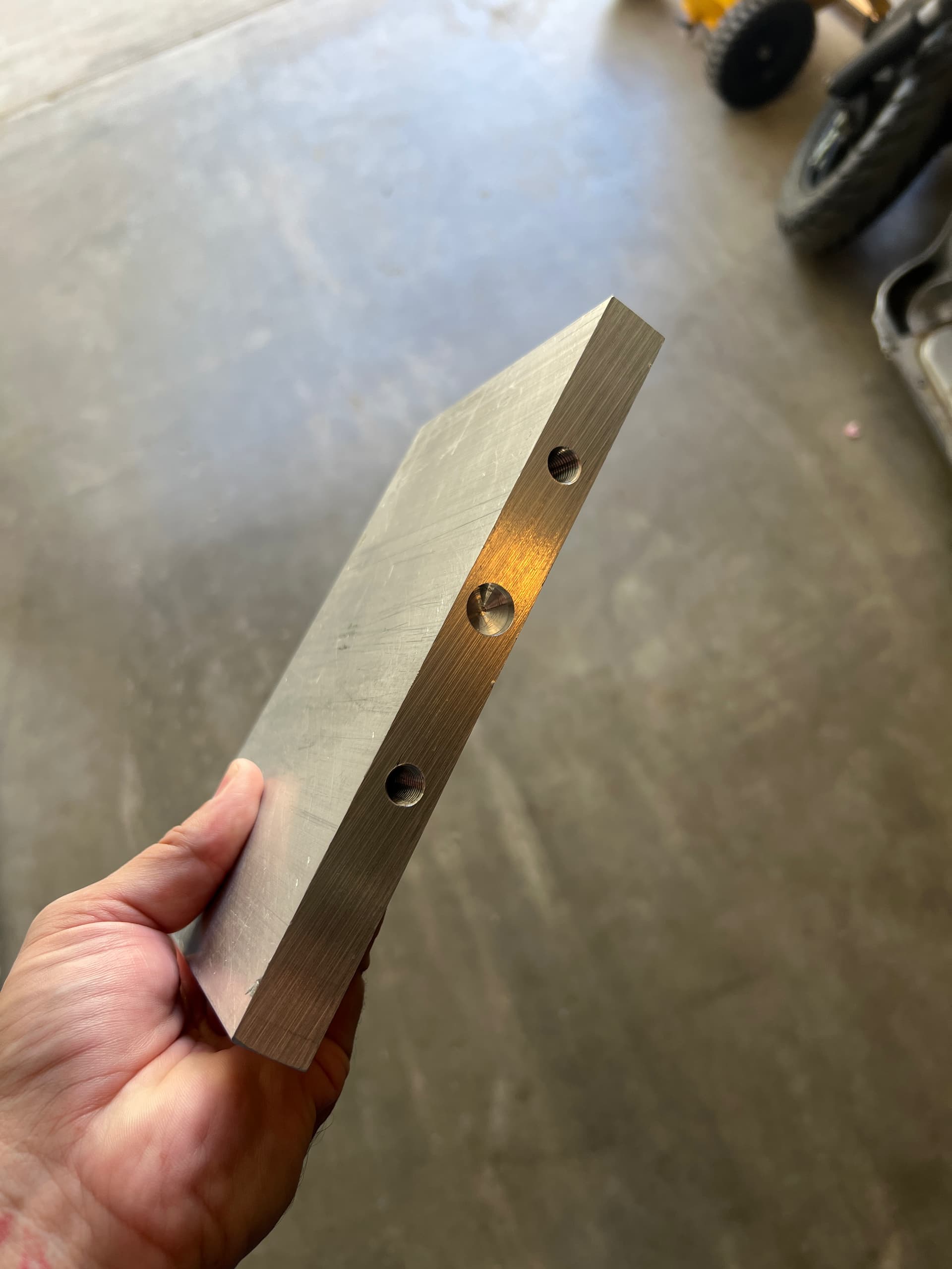

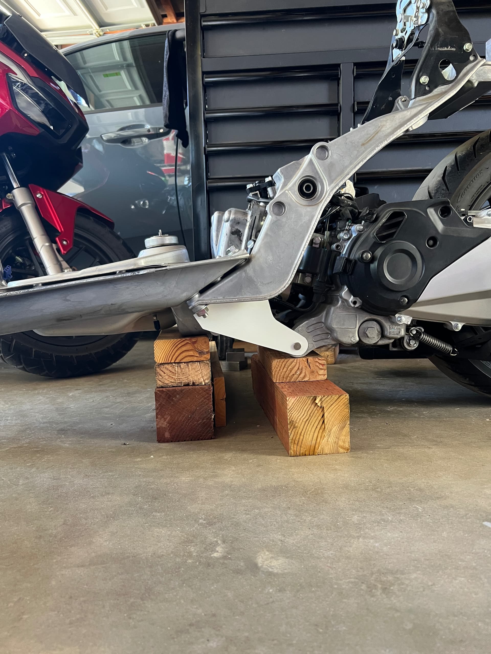

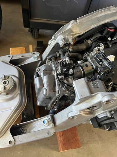

Really the first order of business is engine mounting . I’m designing something and it’s going through a few iterations . The one I’m going forward with is due to header routing . I also am aiming to keep the engine shaved as far forward as I can. I’m not a stretch kinda guy .

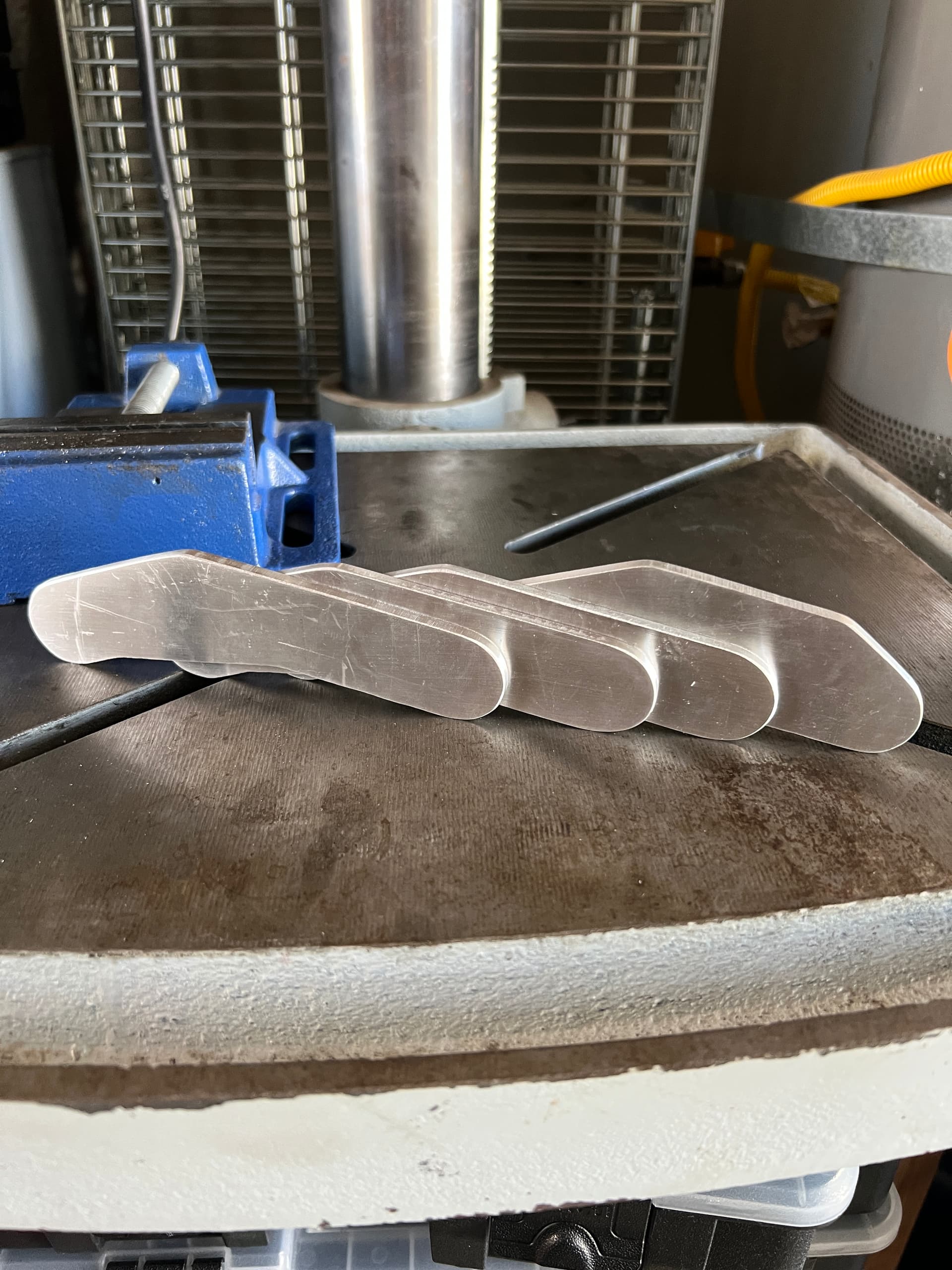

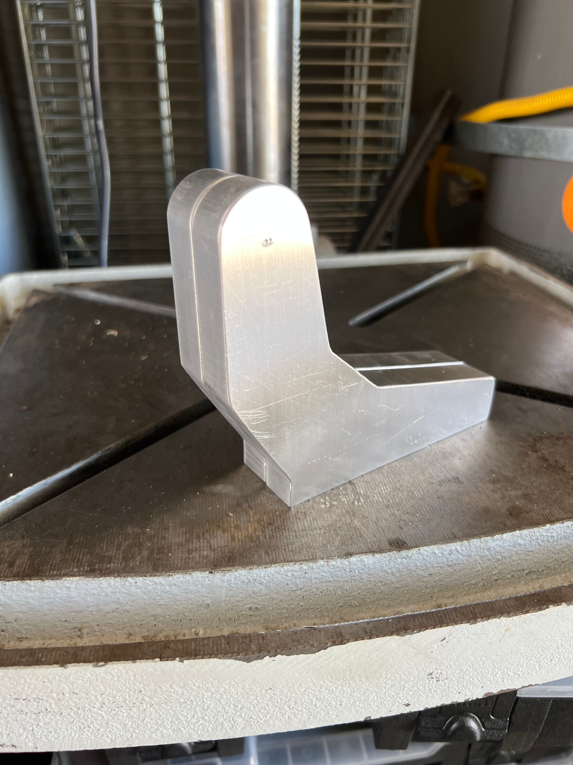

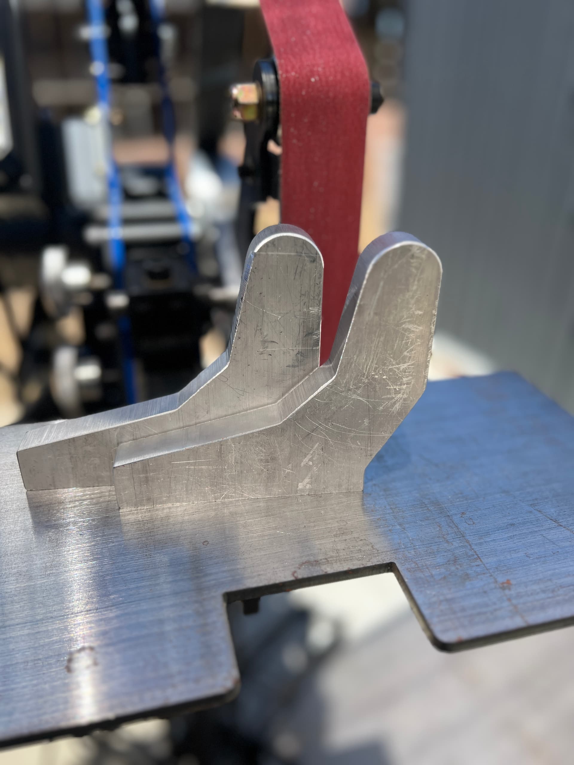

A nice piece of 7075, drill and tap for frame bolts . Cut with bandsaw and finished on the belt grinder . Came out exactly how I wanted🤘🏼. Ample room for a header . It will have a center sleeve for in between the engine mount points, this will be threaded so a bolt on either side will secure it. I don’t think I have single bolt long enough to go all the way across. Now I can measure for center and make the spacers .

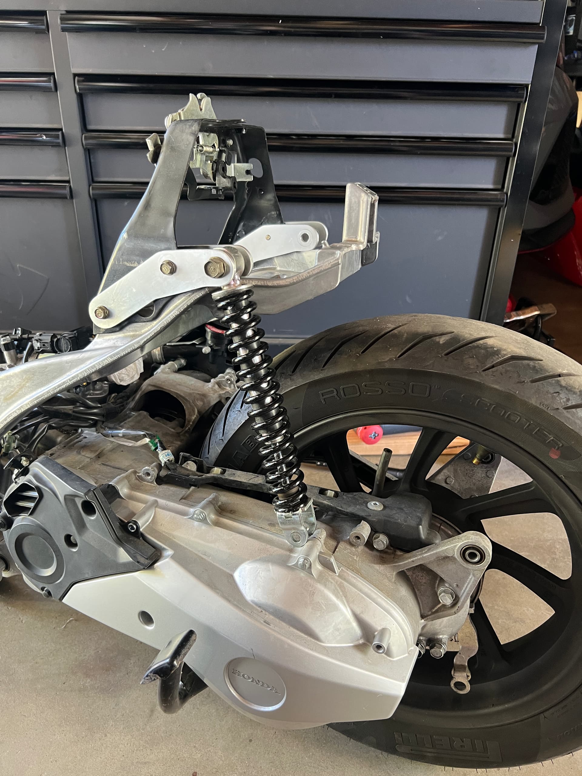

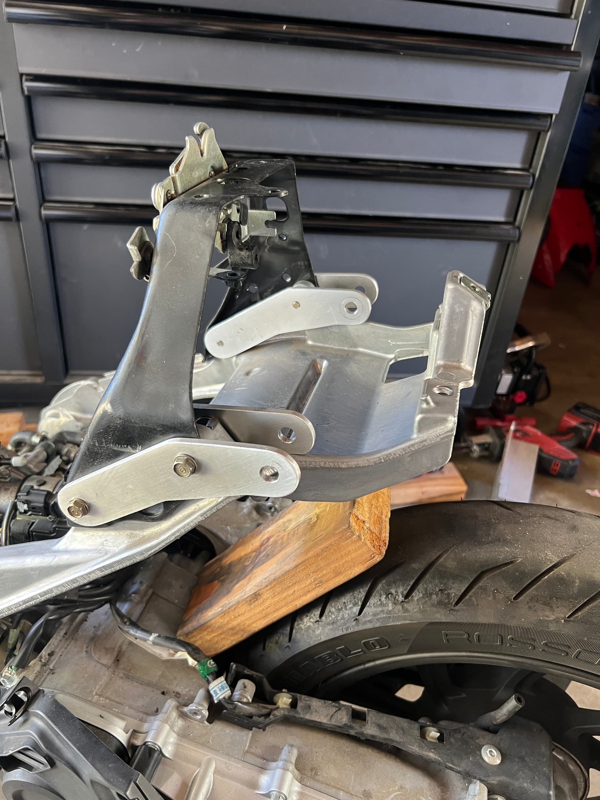

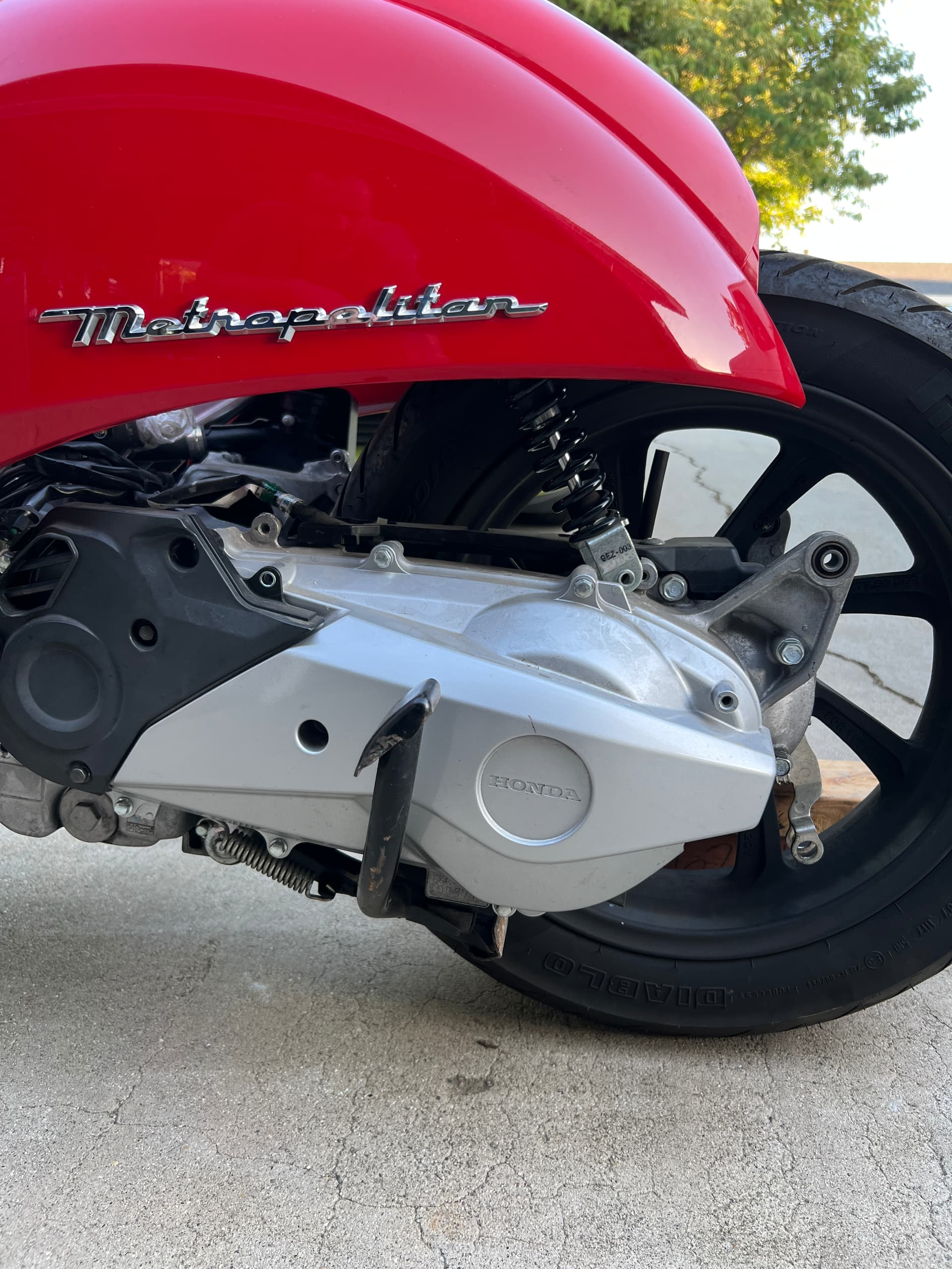

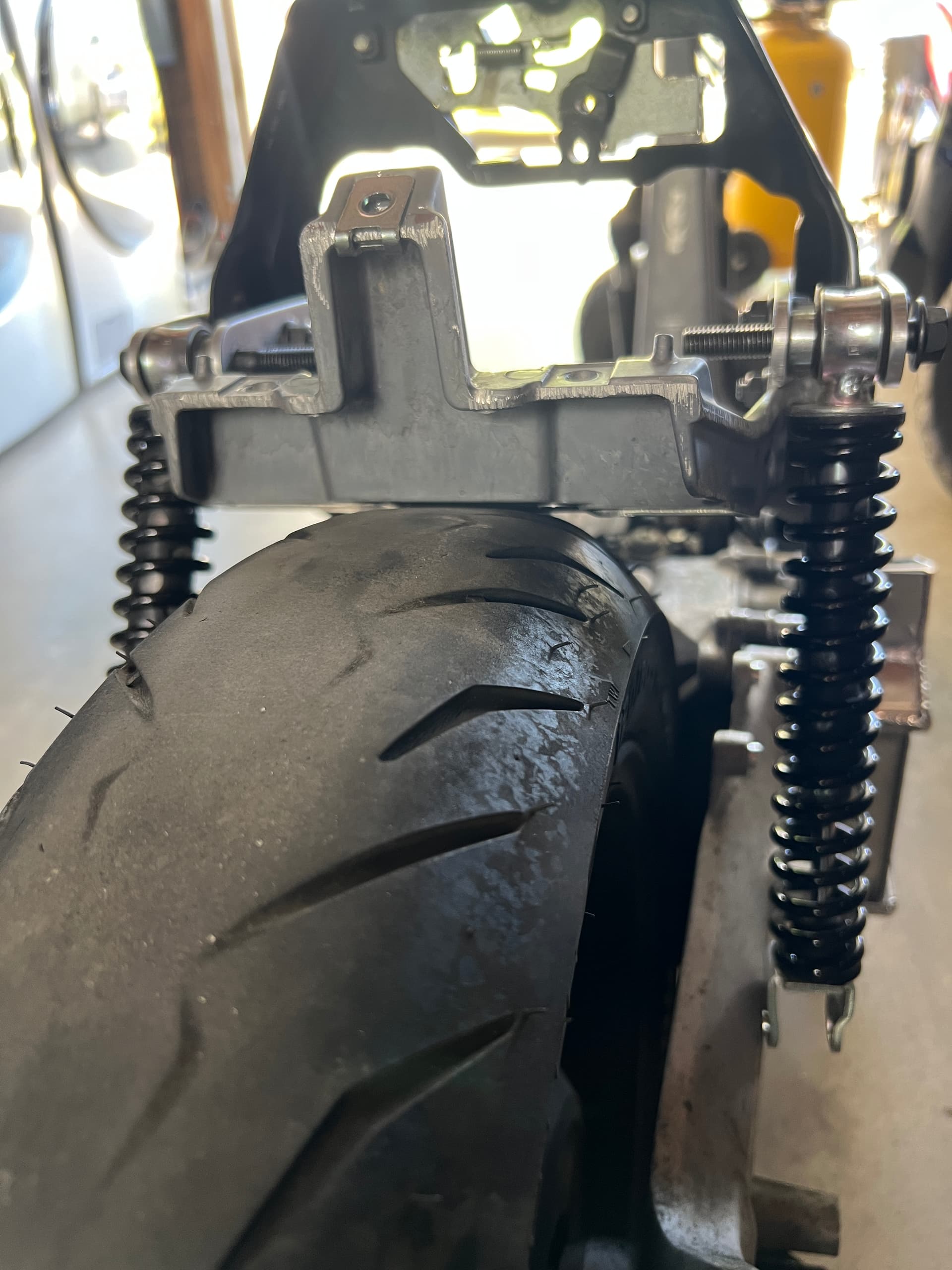

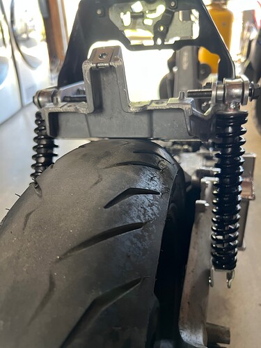

Mount is finished for now. Always open for suggestions. Moving onto shock mounts. It will only have 2” of shock travel . The other Mets Iv seen in order to keep them slammed they hard tailed them. I want to keep dual shocks , I’m 200lbs and these will gangsta lean with single sided shock :joy:. Plenty of room and symmetrical mounts for both shocks. Upper will be plated on the inside too. The lower will be a custom bar for strength.

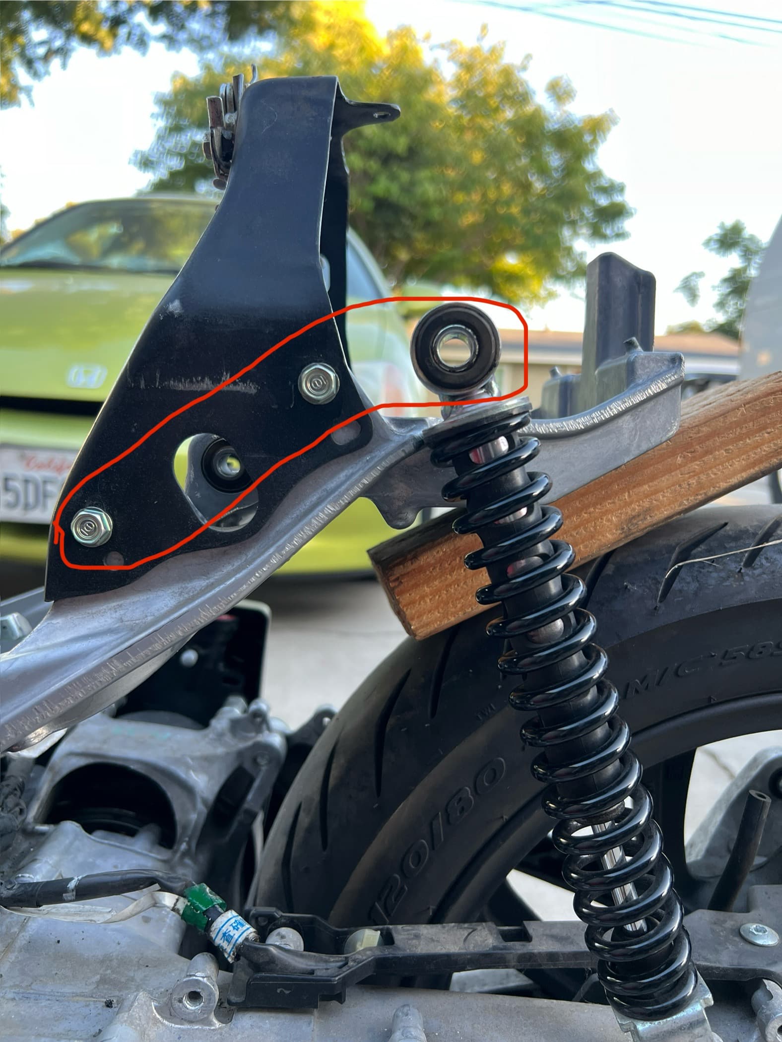

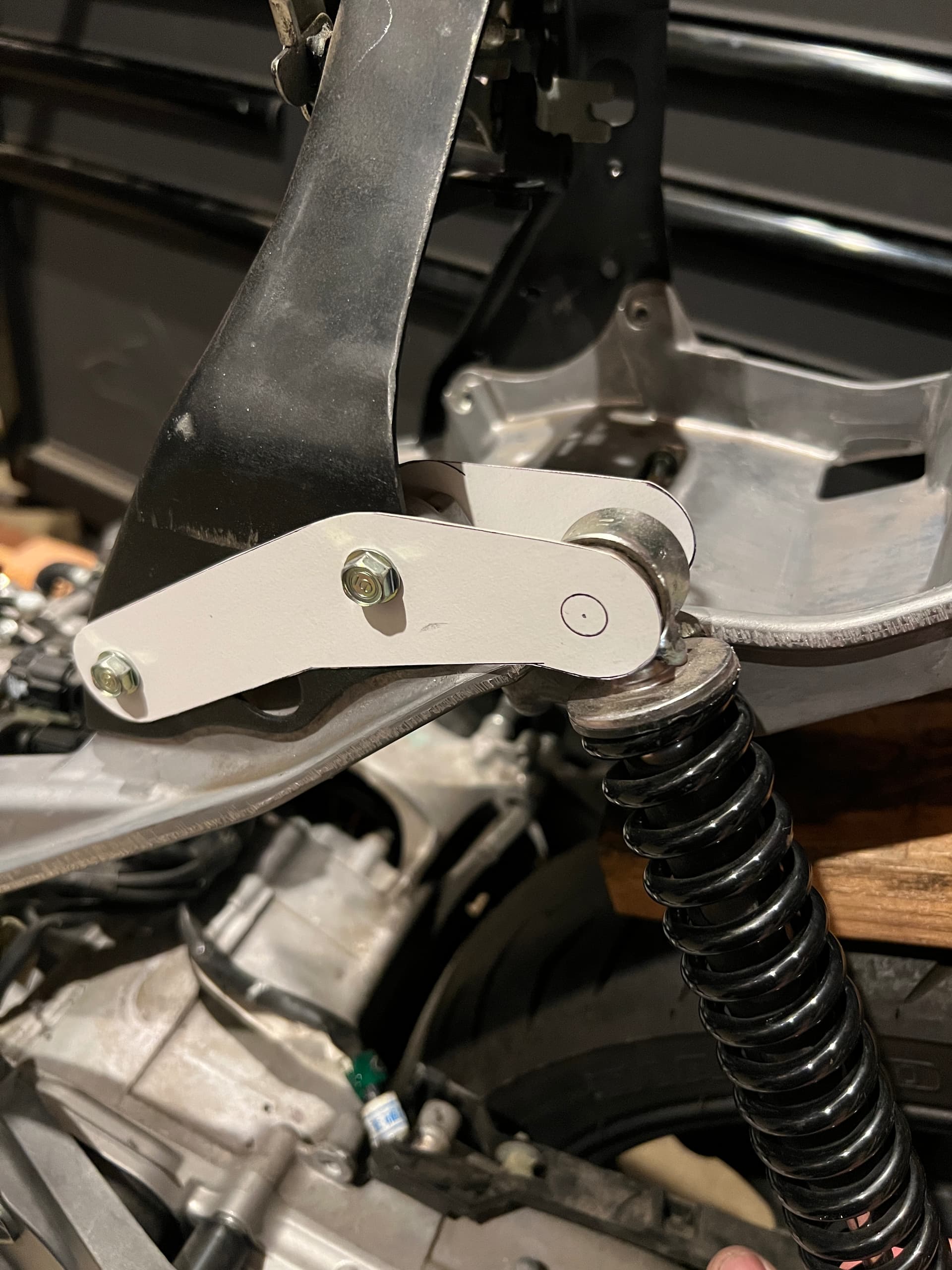

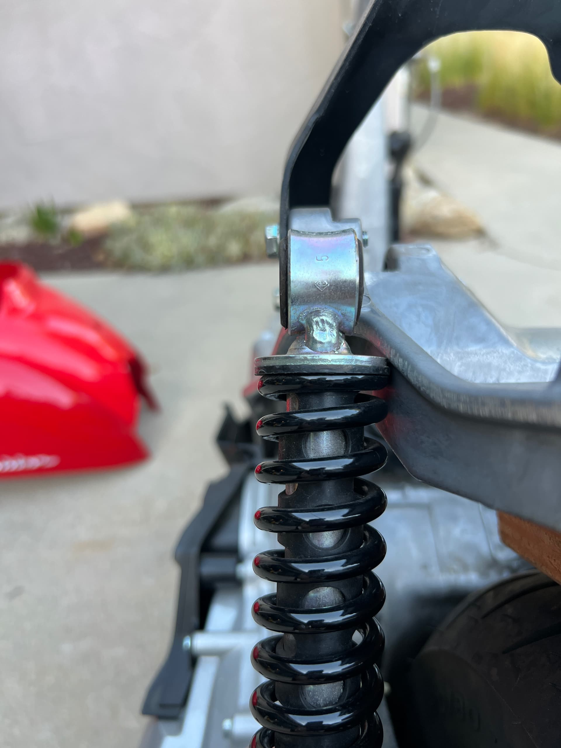

Something to consider with the rear shock mounts if you haven’t already –
Looks like it might be a tight squeeze for some of the thicker, adjustable, aftermarket rear shocks. Mainly at the top where it looks like those factory ones are almost kissing the frame.
Yea definitely, this is only ver.1. build it up and see what needs to changed , added, taken away etc. thanks! :metal:t3:
Shock mounts. This isn’t final this is placement testing. The m6 hardware will be upsized to m8. Add a few cm to length but overall I like it.

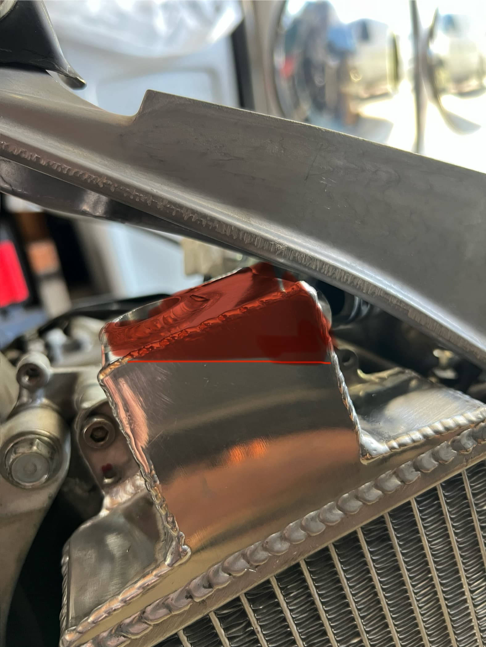

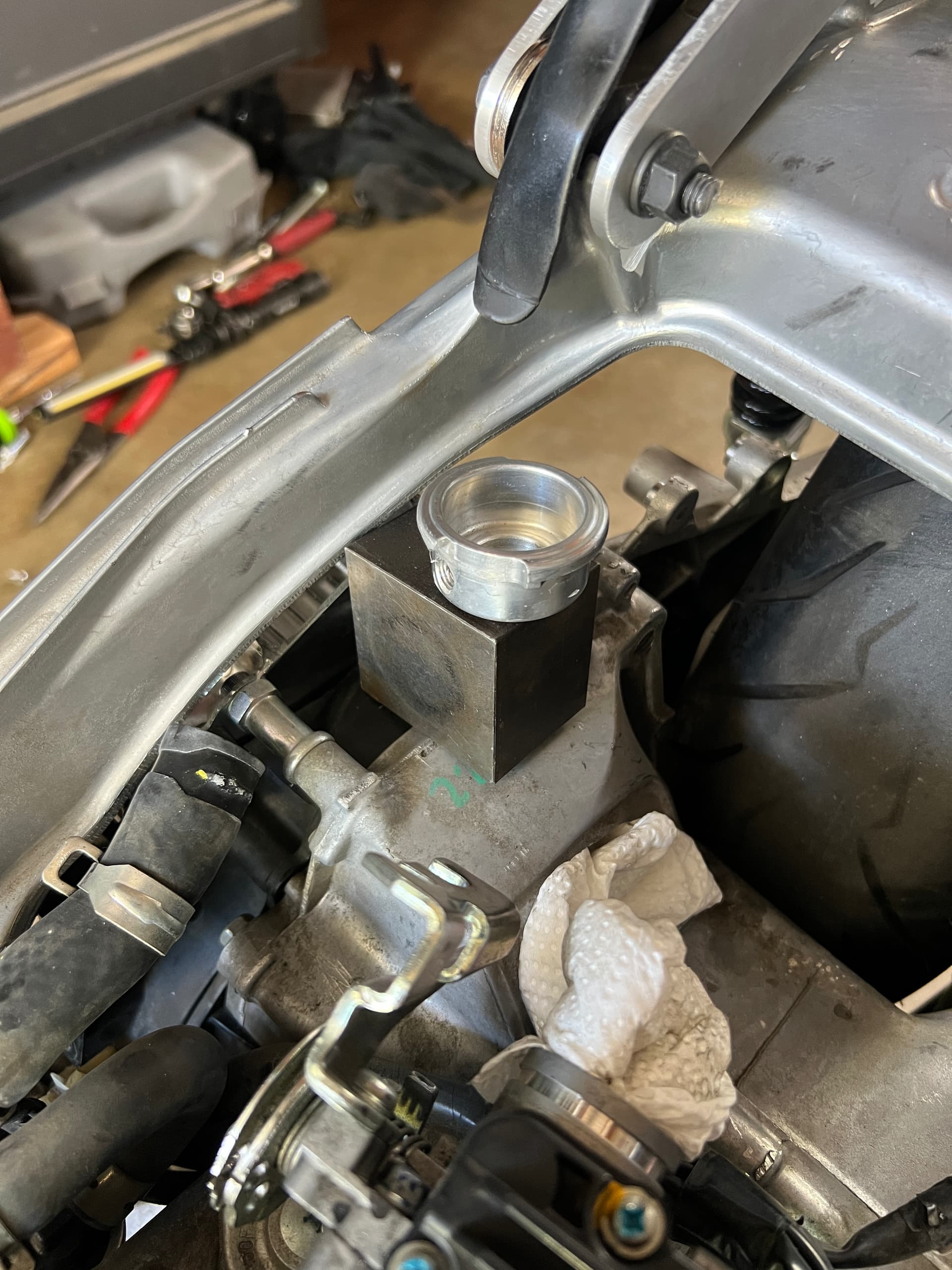

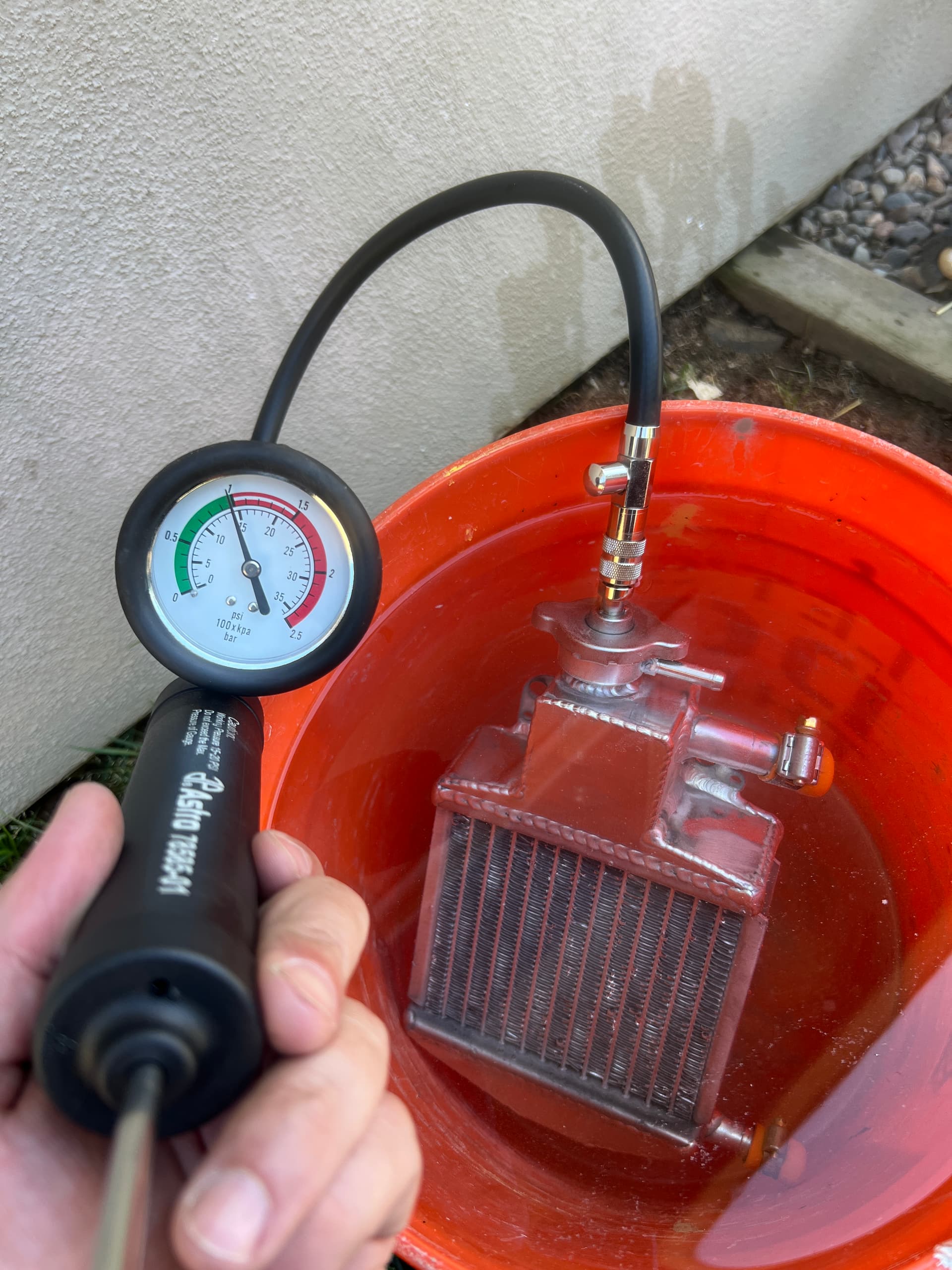

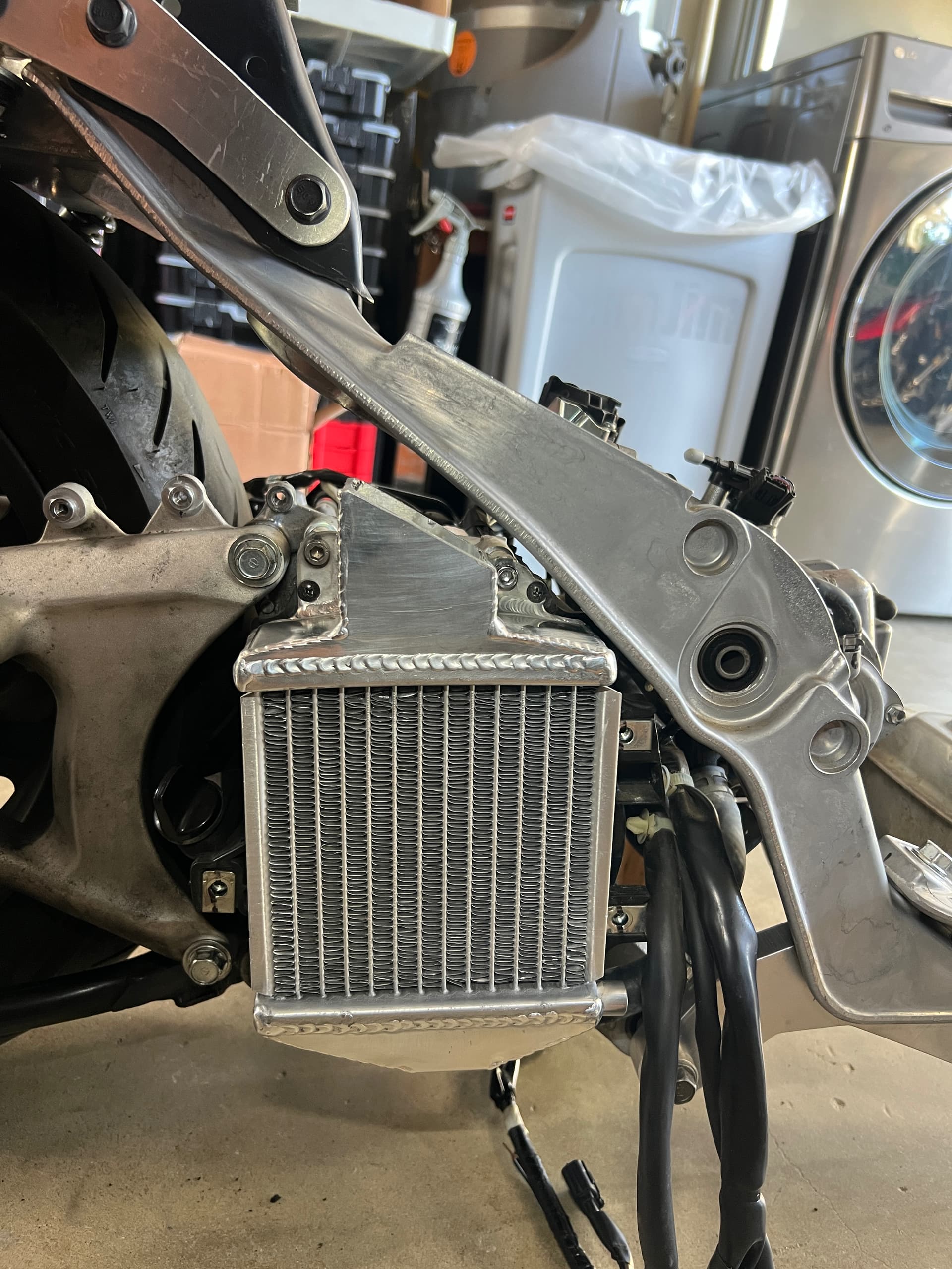

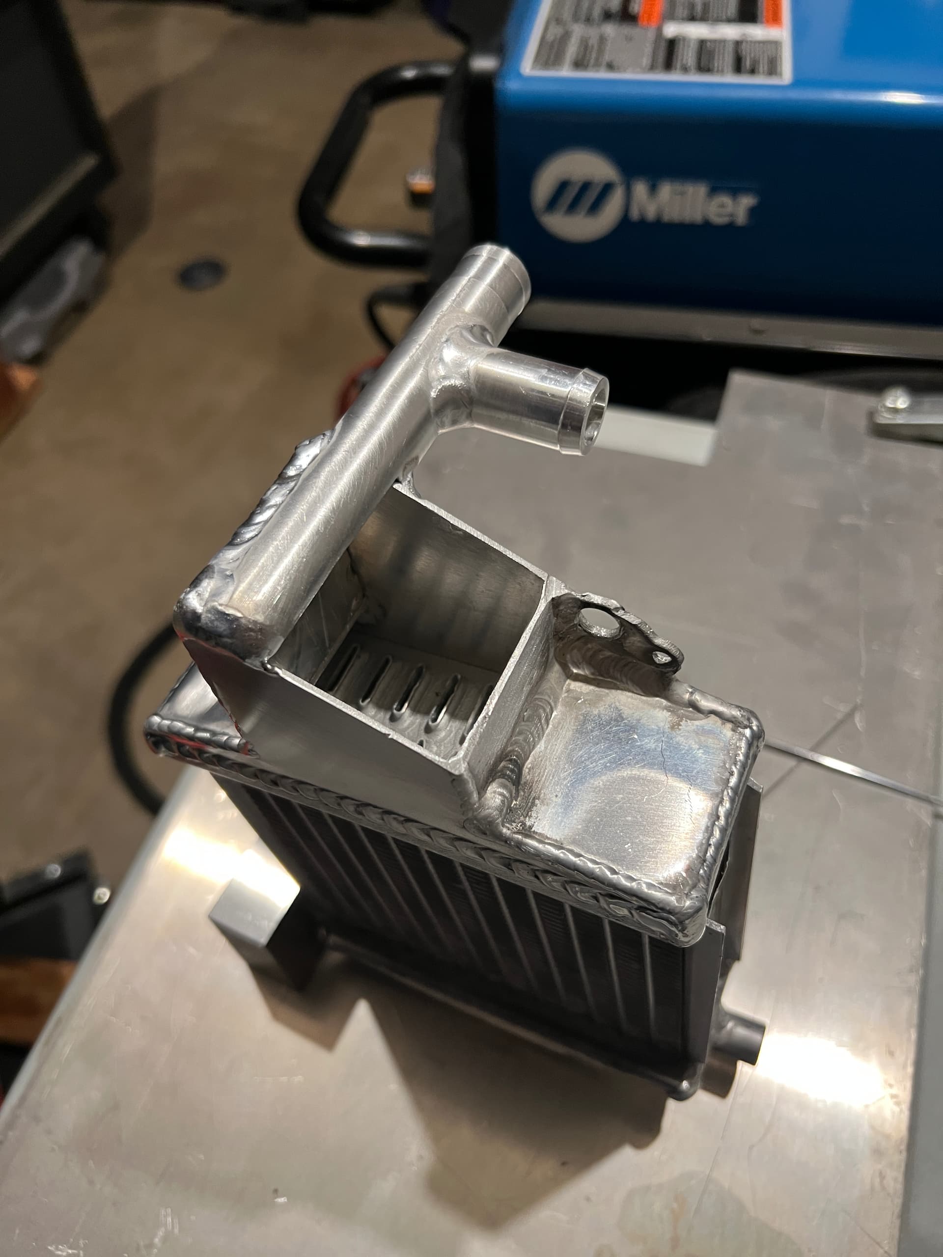

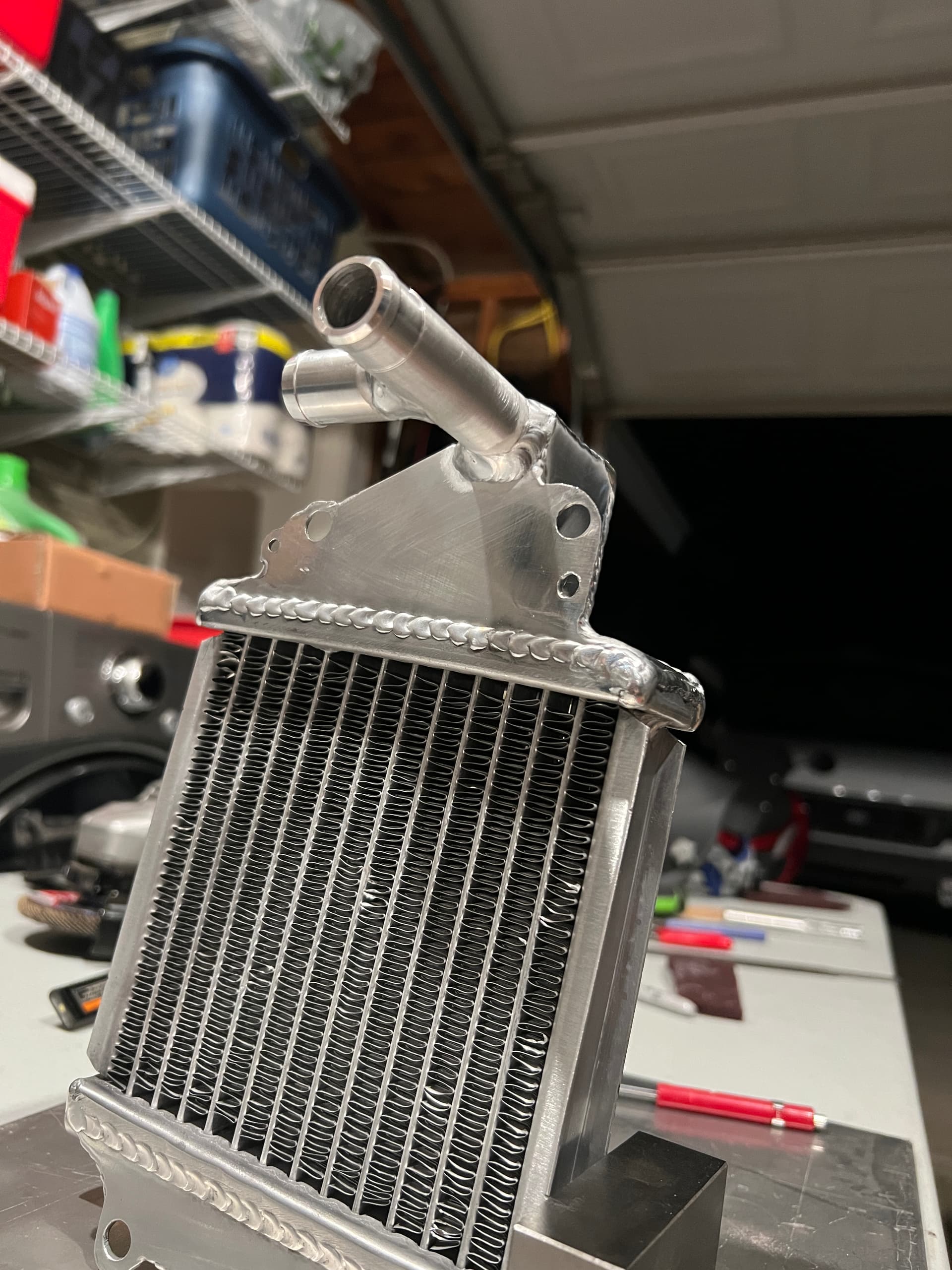

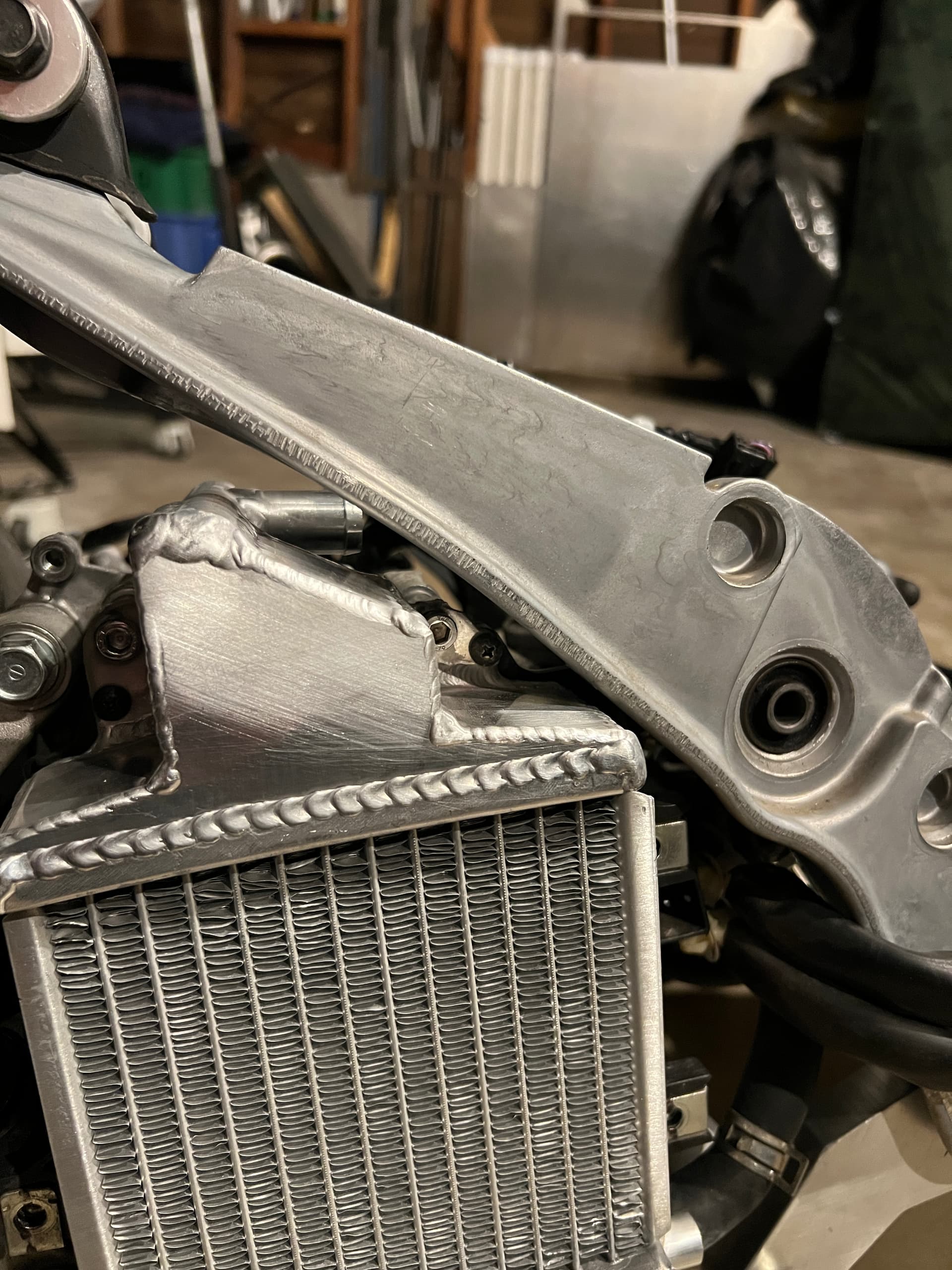

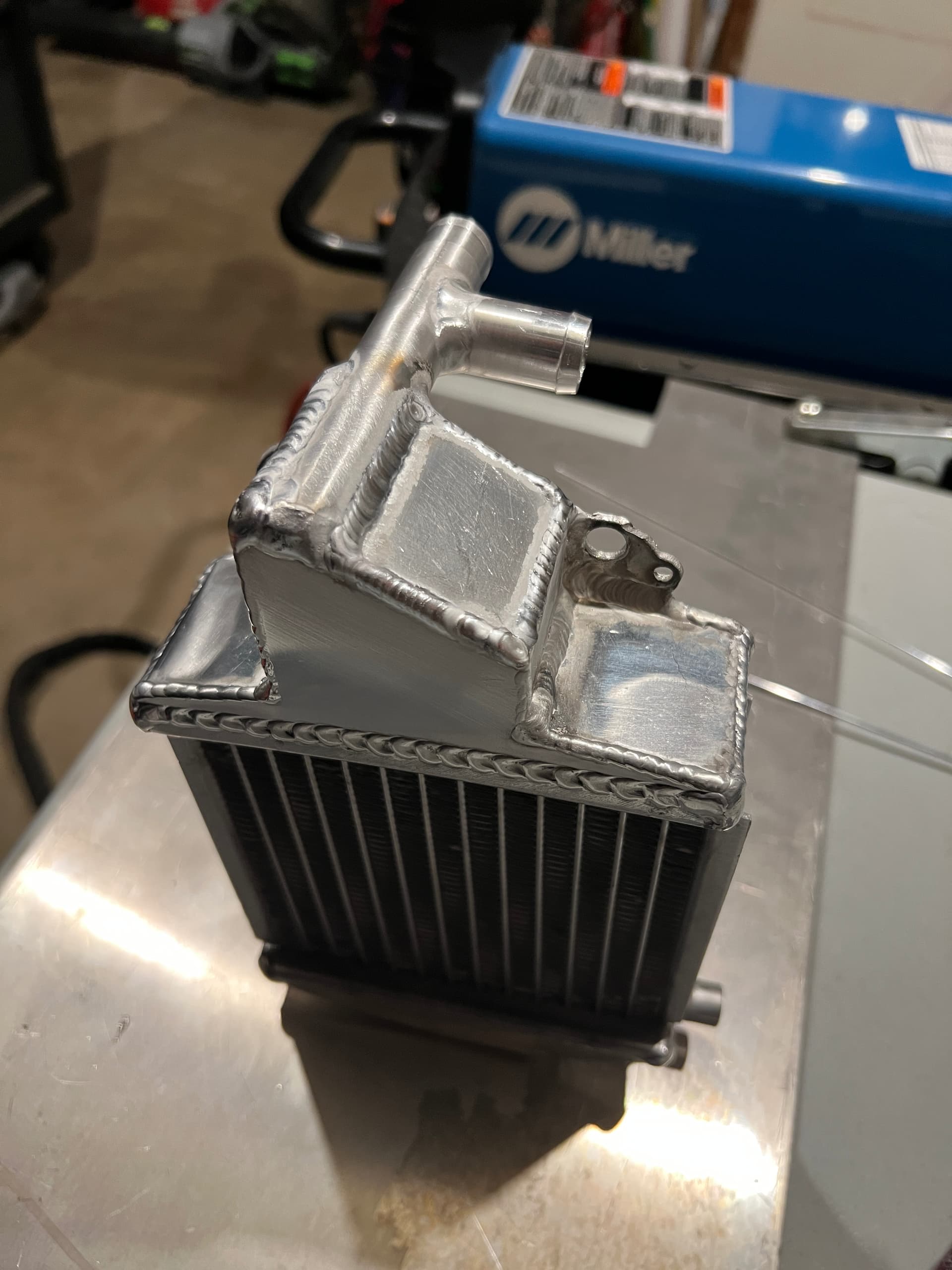

Pressure tested the radiator at full 15psi for 30min . The radiator was a clearance issue hence why I went aluminum. Plus better cooling for big bore. At full bump everything clears . The upper hose fitting and fill neck are being relocated to the inside!

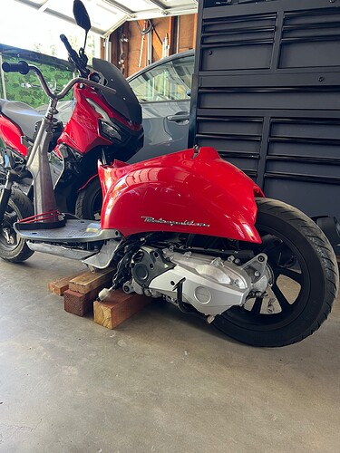

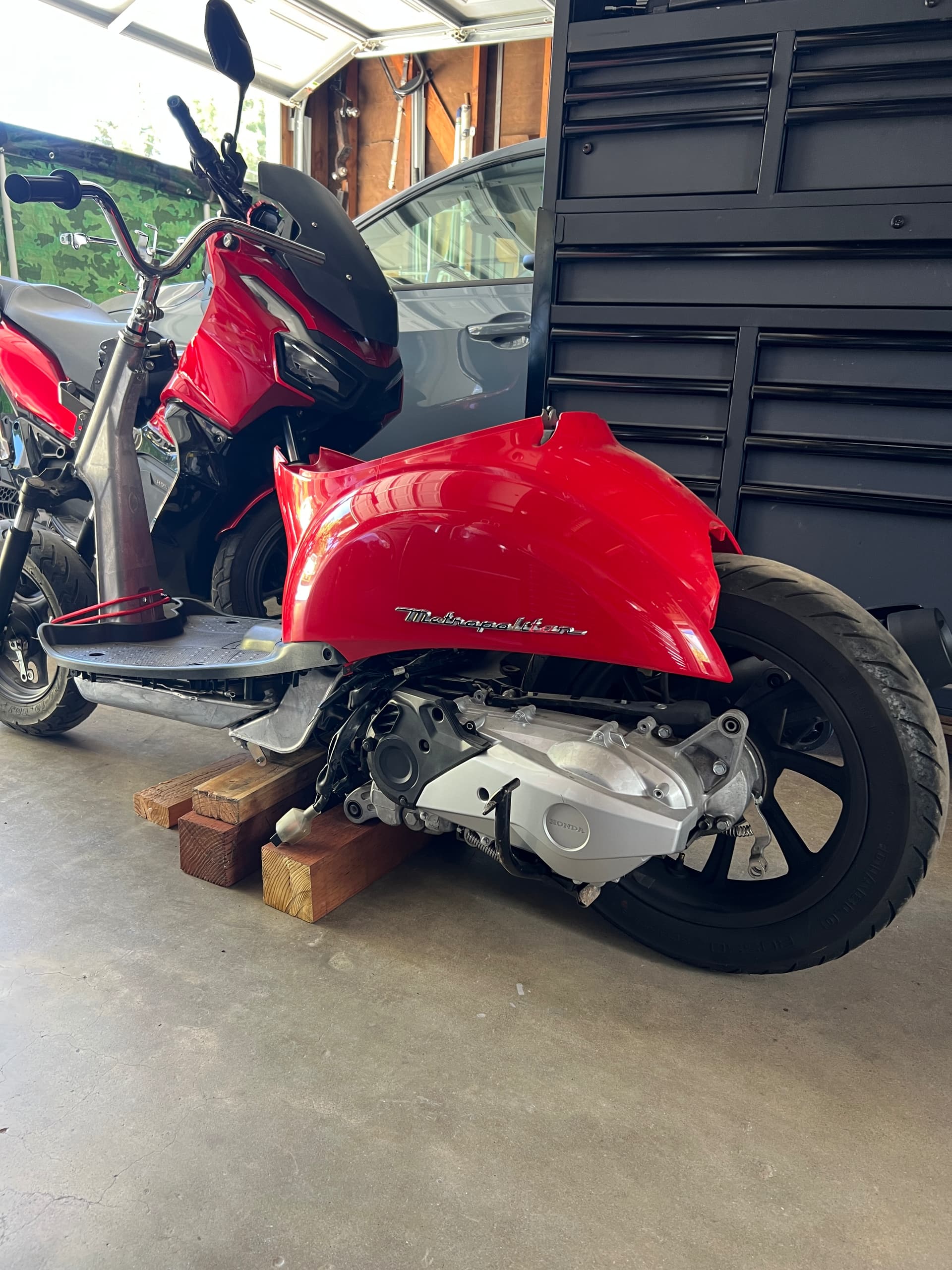

For motivation i put all the plastics on to see how it will sit. I want to lower the front a little. The rear will come down when I get the shocks on.

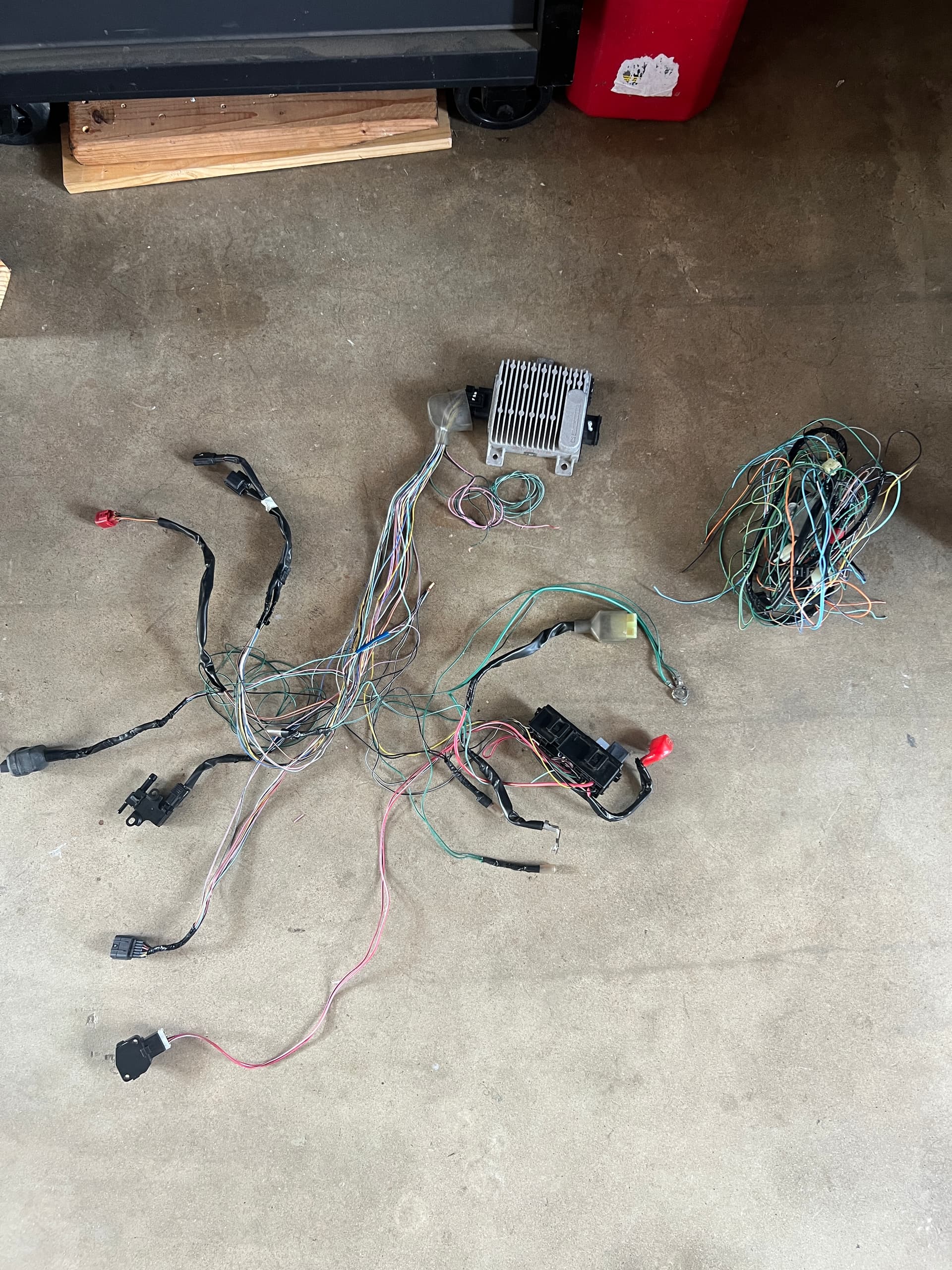

Went through the harness and eliminated it to only what it needs to run and shut off. No lights, no horn , no kickstand switch
For lights and everything else i am running the motogadget mo.unit. I have been using one on my elite 250 for the last 4 years and it works great. It replaces all fuses and turn signal relay. Has built alarm and some other cool features. So all the lights and such will be a stand alone harness

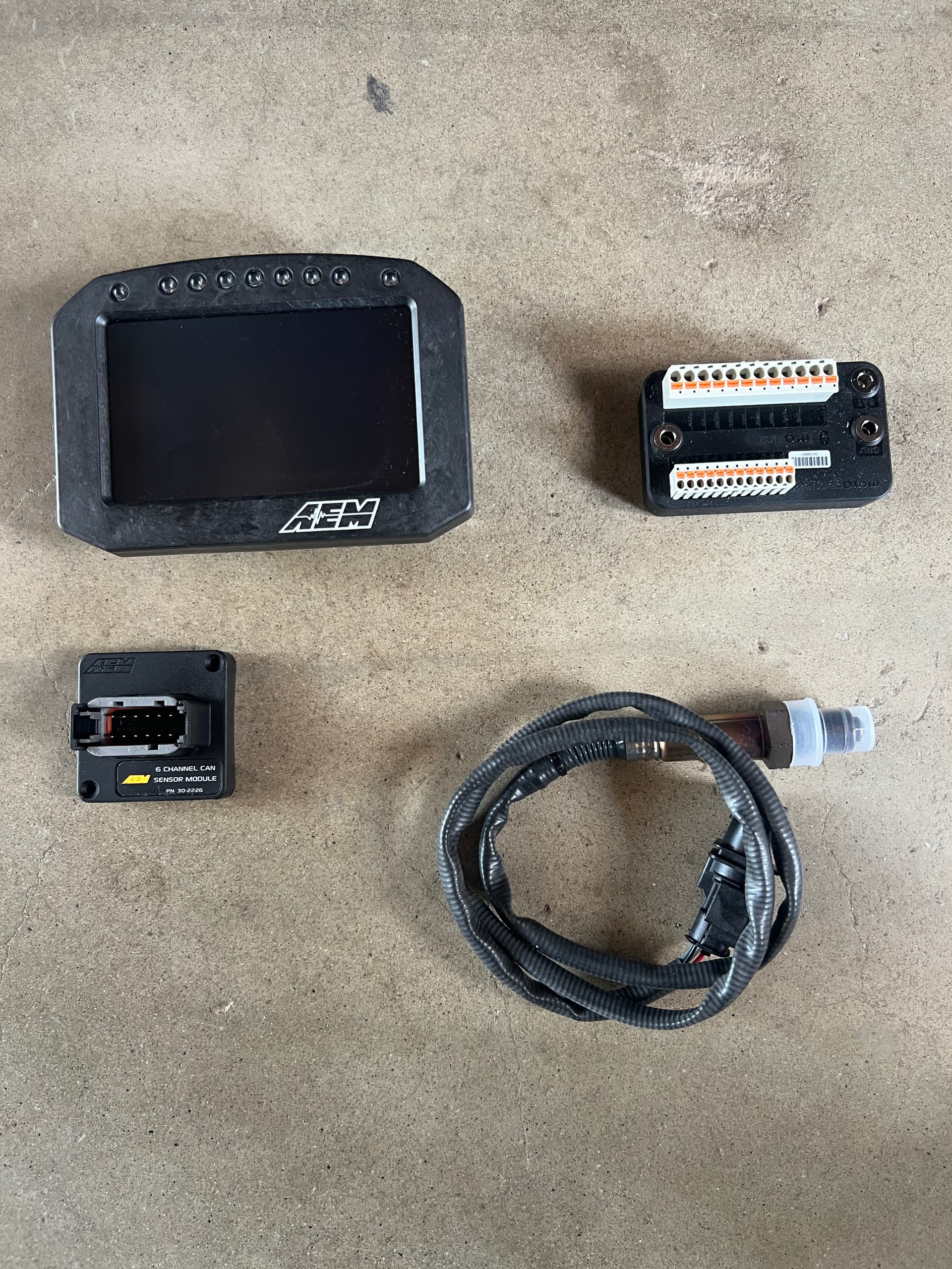

Cluster. I am using the smaller 5” aem display. I have the 7” in my racecar and know how to set it up very well. Speed is gps . I can add temp and pressure sensors for coolant temp,oil temp, oil pressure , fuel pressure , fuel level, rpm, air/fuel ratio
