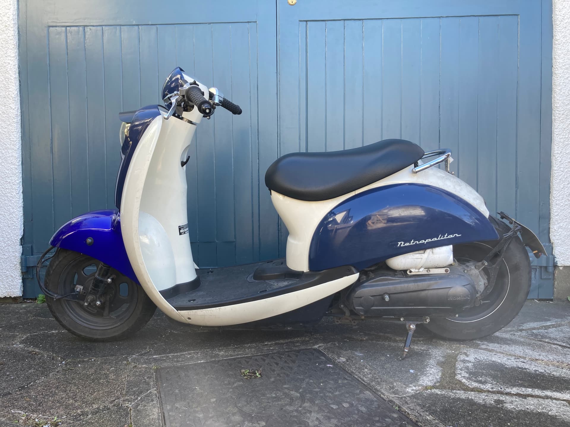

Some comparison photos…
I actually quite like how the old fender makes the bike look so low. It’s just too long and looks odd from different angles.

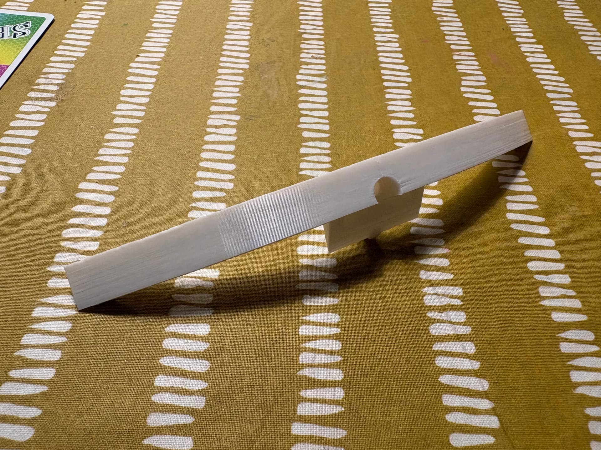

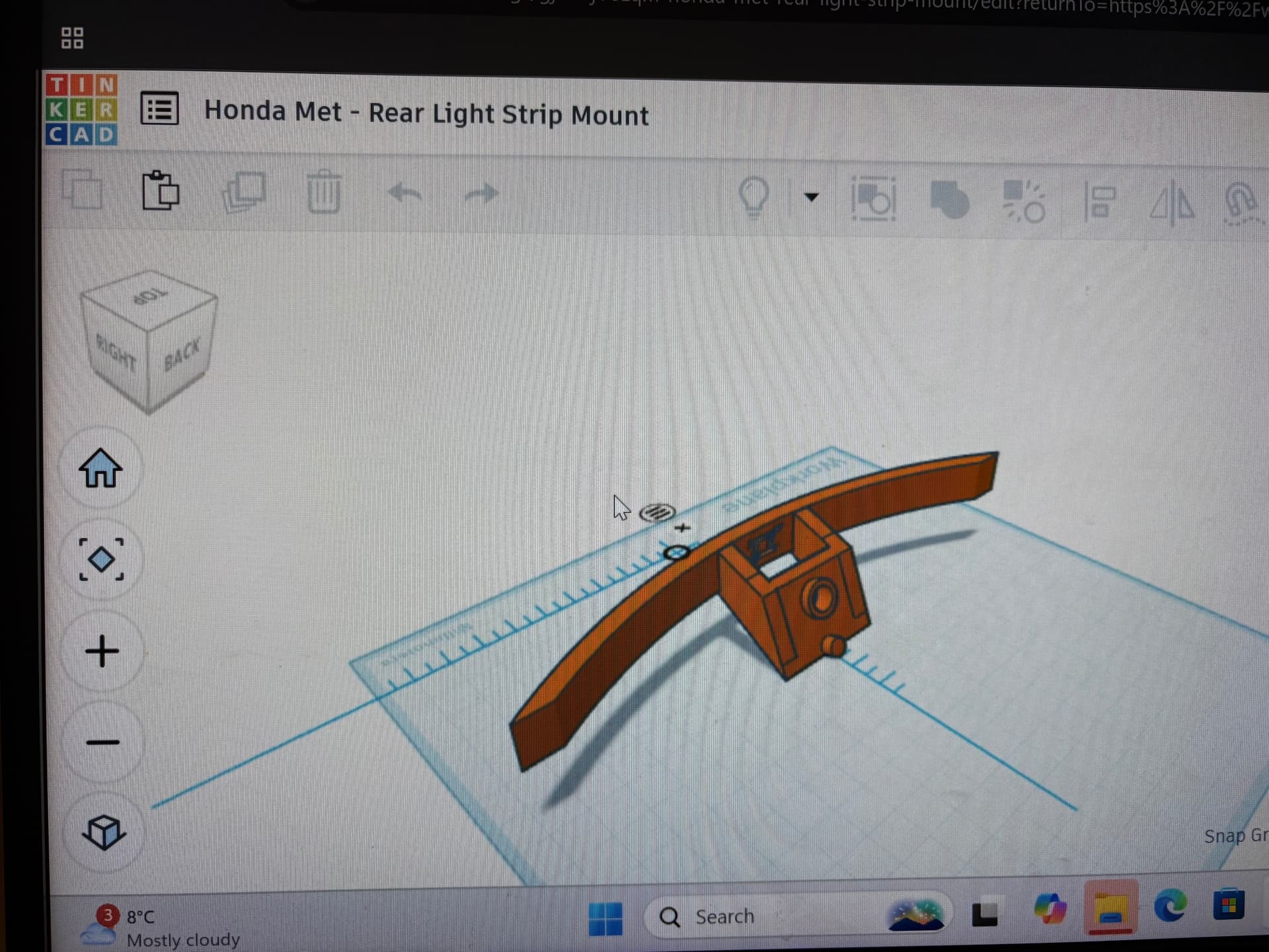

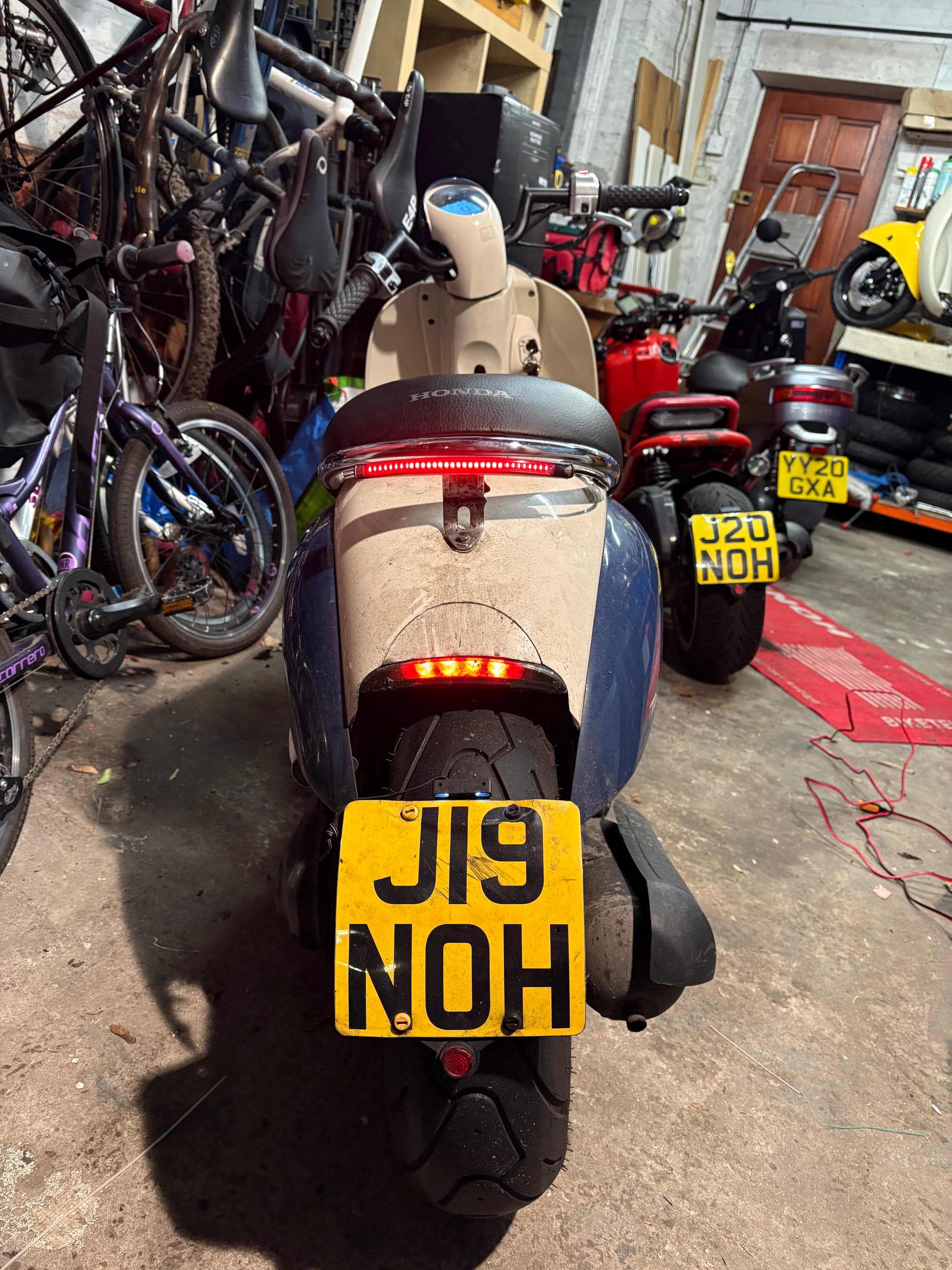

Decided to add an LED rear light strip as I don’t think the light cluster I have is enough.

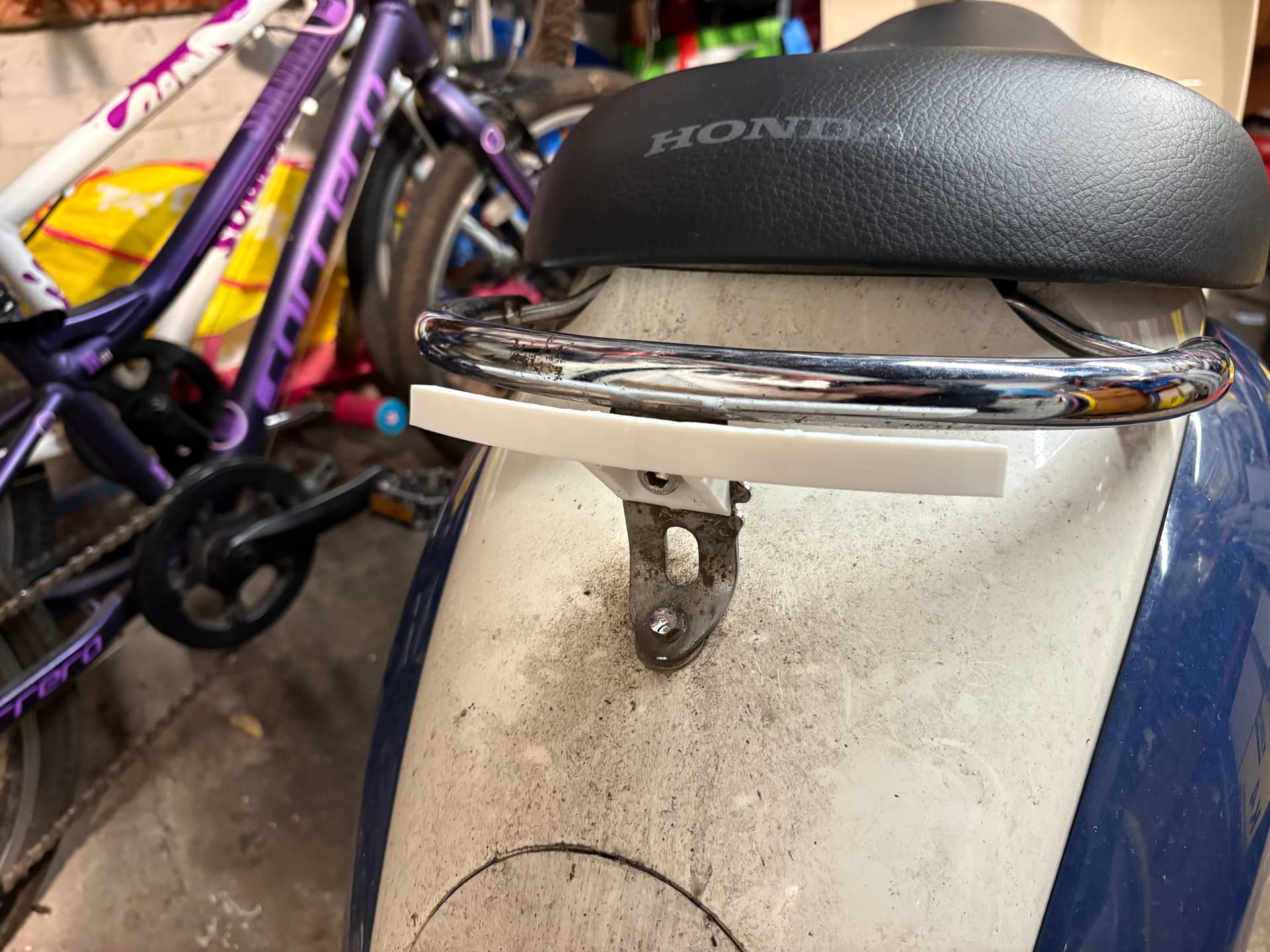

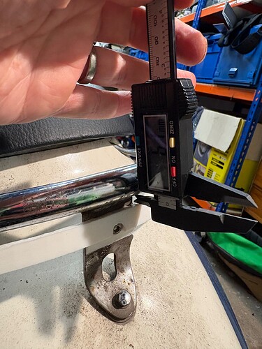

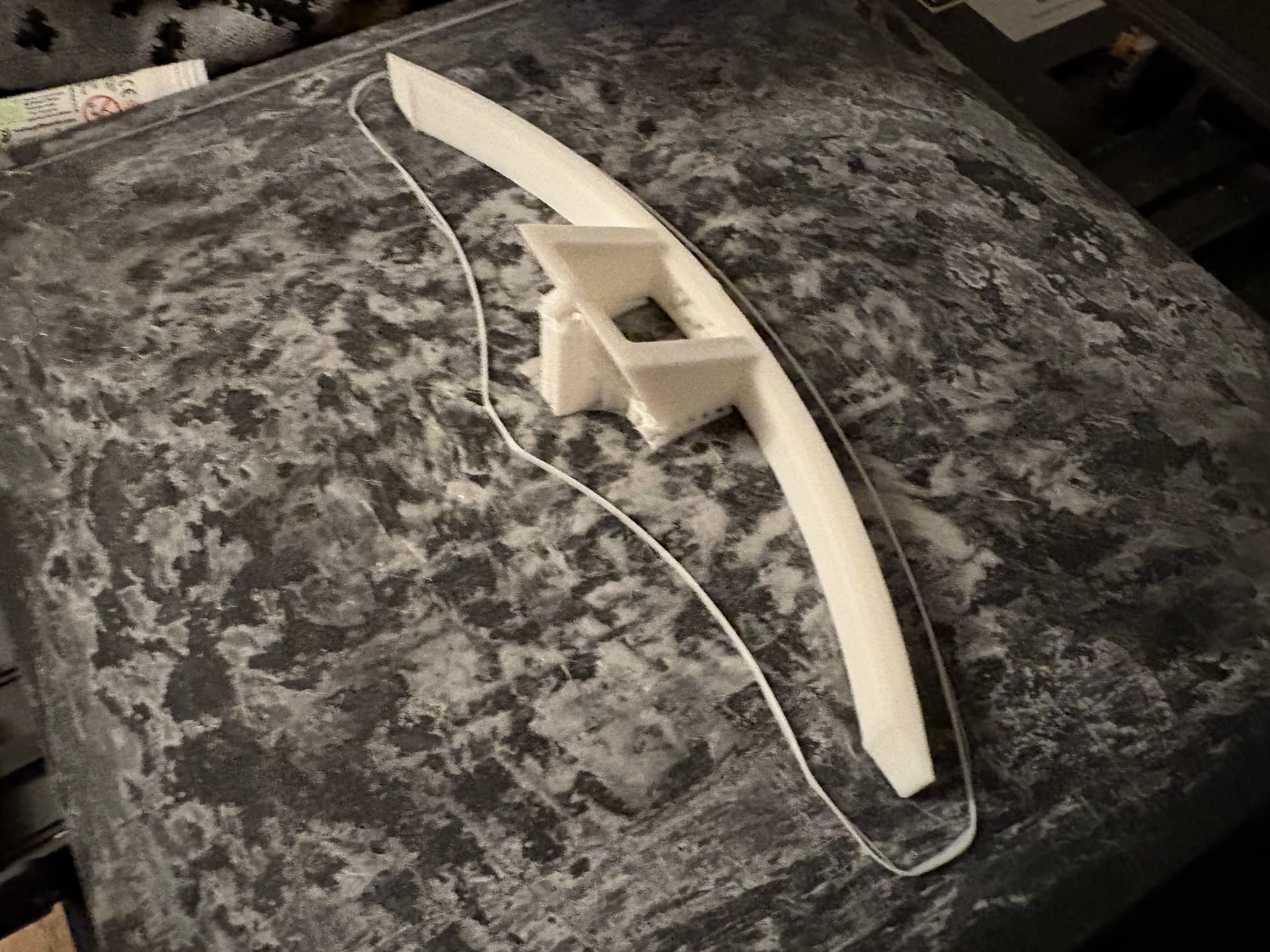

So this is attempt number 2 on the mounting bracket. Trying the get the radius and alignment to match the rear grab bar. I’ll post a picture when it’s mounted…

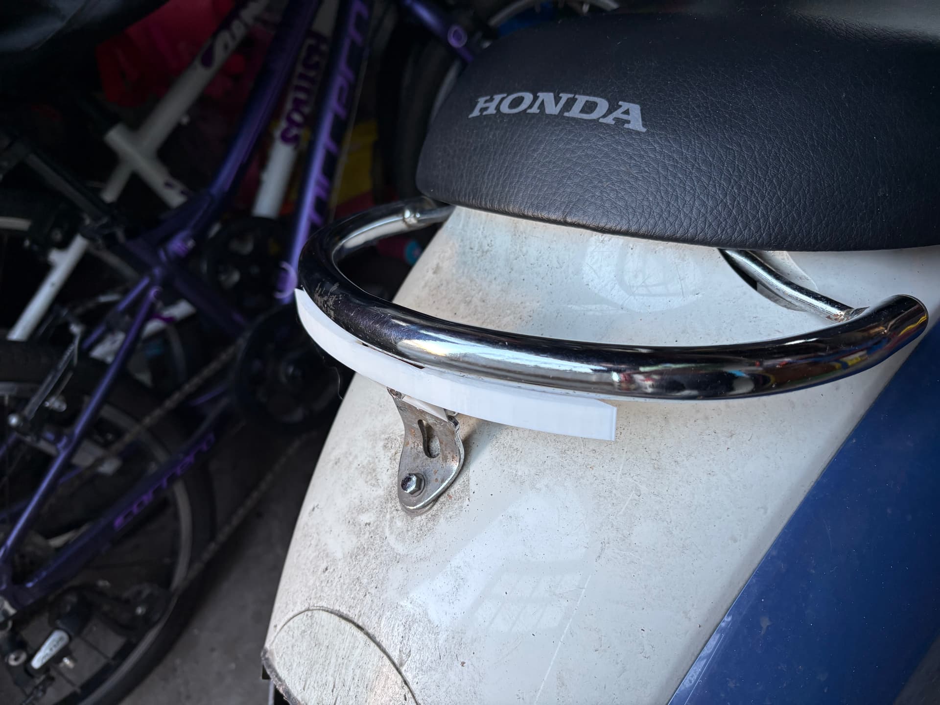

Not sure if I like it or not.
I also think I’m gonna knock it and break it at some point…
May run it over the winter whilst it’s dark and see what happens.

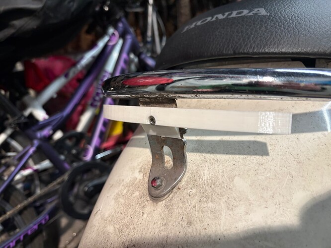

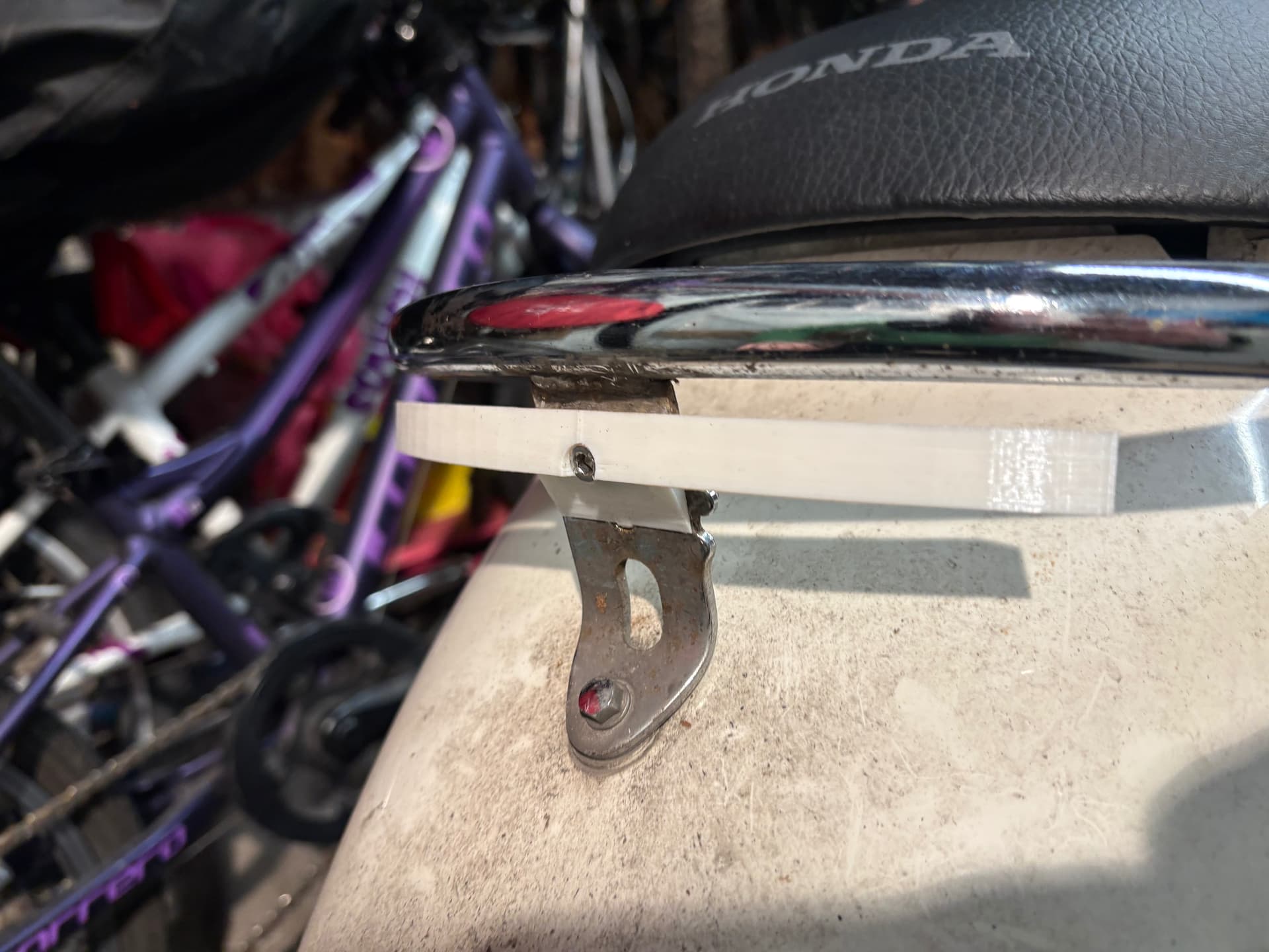

Version 2. Tucked back and under.

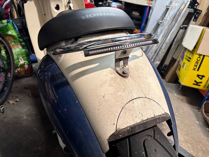

Gonna raise it 6mm so it’s tight to the bar and leave it at that.
3rd attempt is close enough. The radius is slightly off as it moved backwards. If my ocd kicks in I’ll correct it.

Light fitting and working. However I centered the mount based on the width of the LED strip. However the LED lights aren’t central - there must be a controller at the wires end.
So really I need to rotate the round part around so that the LED is central.
