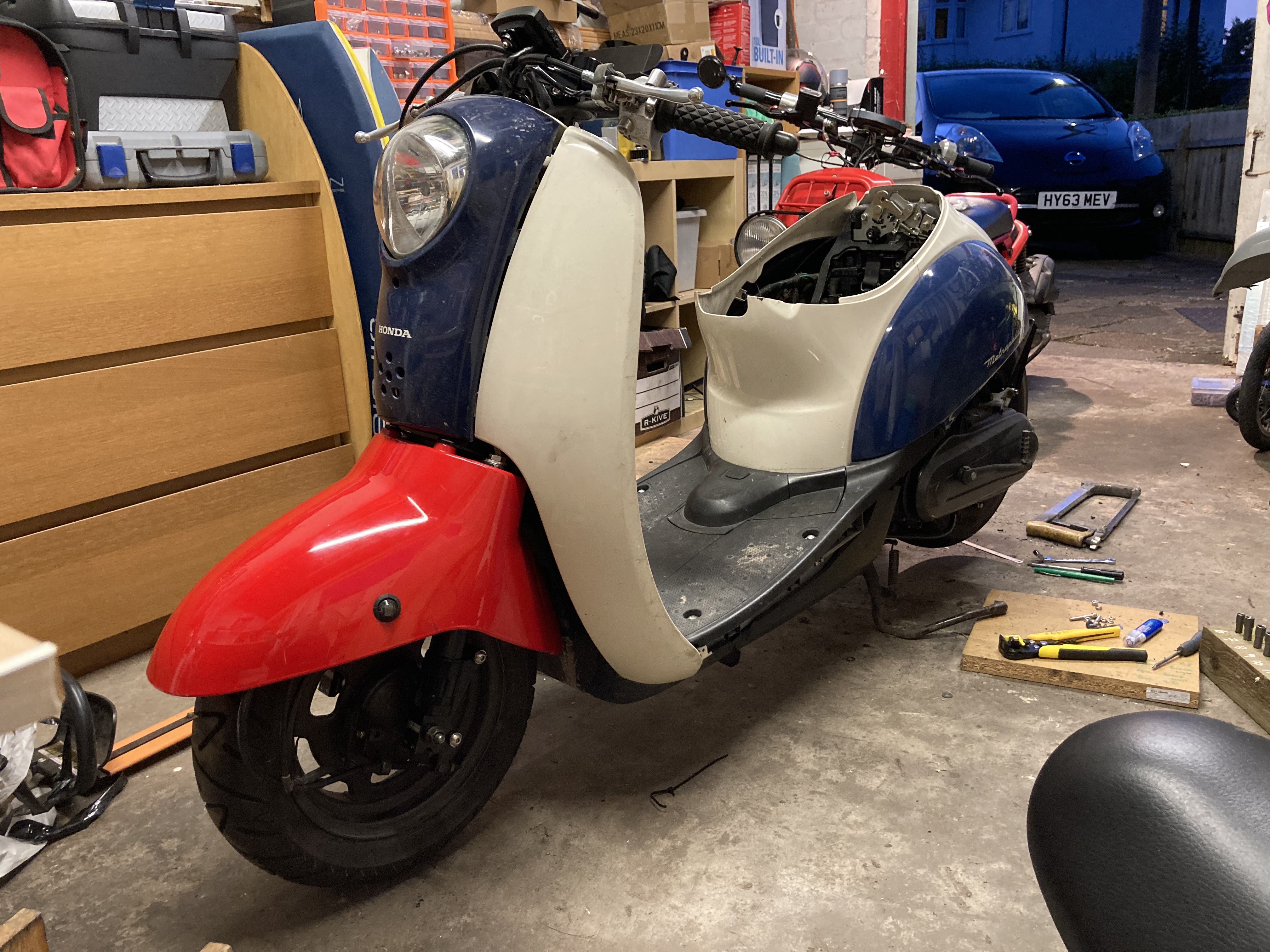

So I started to replace the front…
Good news is the that frame isn’t bent or cracked. The wheel and bars etc are shot though.
First thing I have learnt. A met is like a child that takes all its clothes off to pee!!! No matter what you do, you have to remove all the plastics!
Then there is the combined brake cables, so f’ it. I’m in the whole way. Zoomer rear end is happening at the same time.
So up front I have installed a Zoomer wheel, hub, low down adelin shocks and the wider Zoomer triple tree with new steering bearings. I’ve cnc’d a riser out of 6081 and have gone for some aftermarket handlebars with the original controls.
I can’t get a met fender over here so have been buying old second hand ones to see what fits. I think a Sinnis zen 125 is the winner (the red one). If I was keeping the Met tree the Sinnis flair 50 would have been the best.
I have now cut the top of the fender neatly and made some brackets - just waiting for them to get laser cut. It fits the wheel ok, but I won’t know if it clashes with the front frame plastics till it’s all together…
The dual brake thing has been removed, So new zoomer front and rear brake cable installed to take its place.
I have a Koso speedo gauge to go on, just waiting for the bracket to get laser cut again.

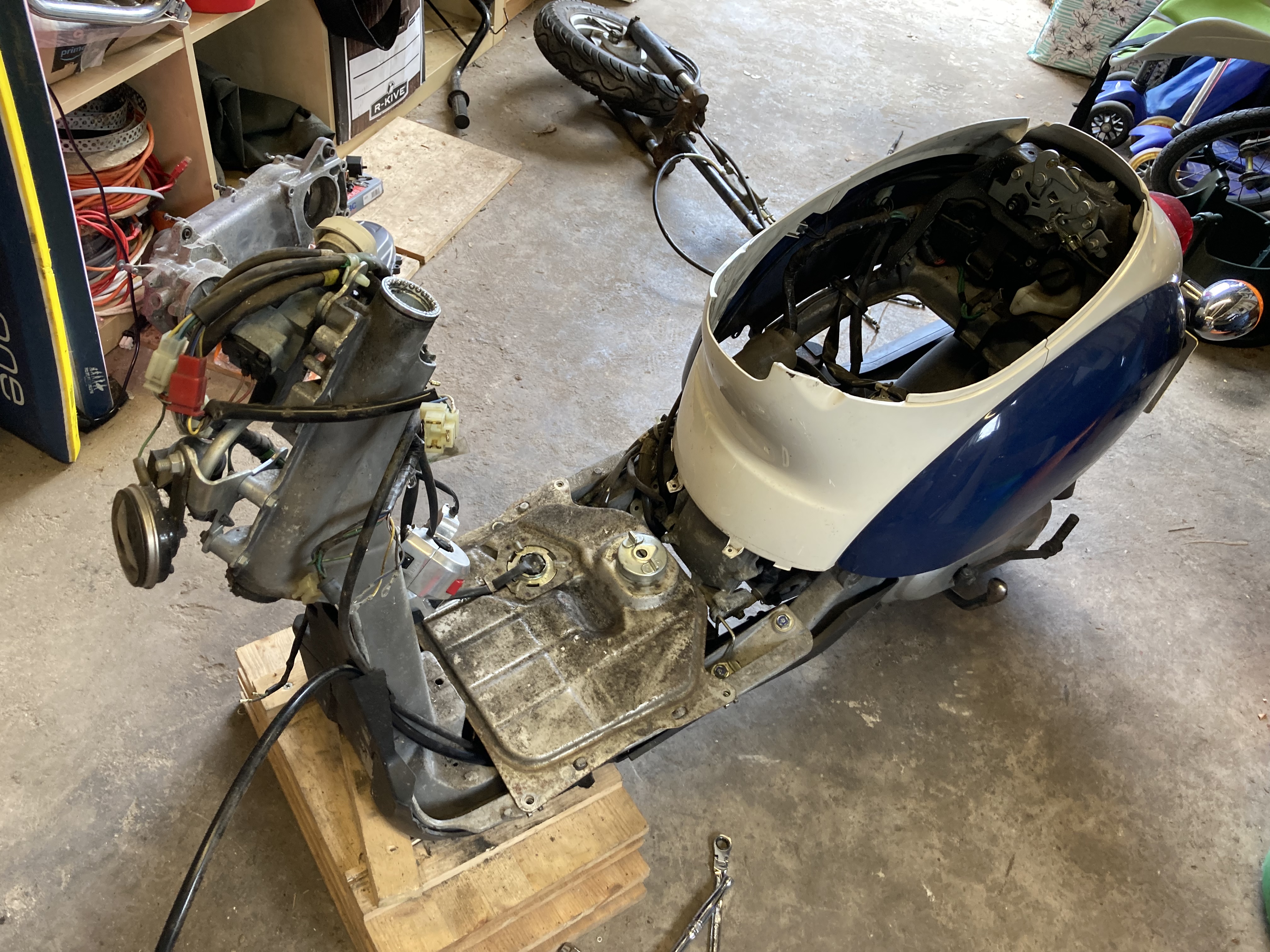

So on to the rear. Have swapped to a Zoomer rear cvt arm. Douglas 10x5.
I cut the bushing off the left hand side of the CVT case, and packed the engine mount on the other side. So the engine is moved over circa 10mm to the left.
It’s very nearly center…
There is something really cool looking about the naked Met:
So it’s underway. There is no turning back now….

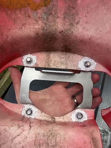

Mock up of front fender bracket on fender. I used plastic JB weld to hold the nuts in place to make it easier to fit when on the bike:

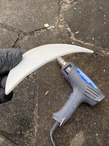

Tidying up the plastics today, and learning as I go.
Trimmed the rear again to suit the higher light.
Trimmed and bent piece to suit using dremel and heat gun.
Then used a plastic welder to install it.
Still need to trim the bottom slightly. Undecided as to whether to fill the gap and smooth it in, or to leave the gap expressed.
