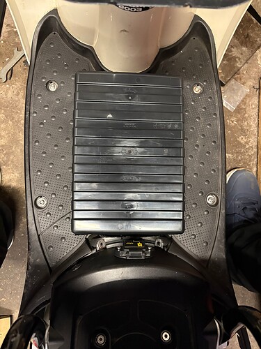

Temporary covering to battery whilst I work out what’s best to do…

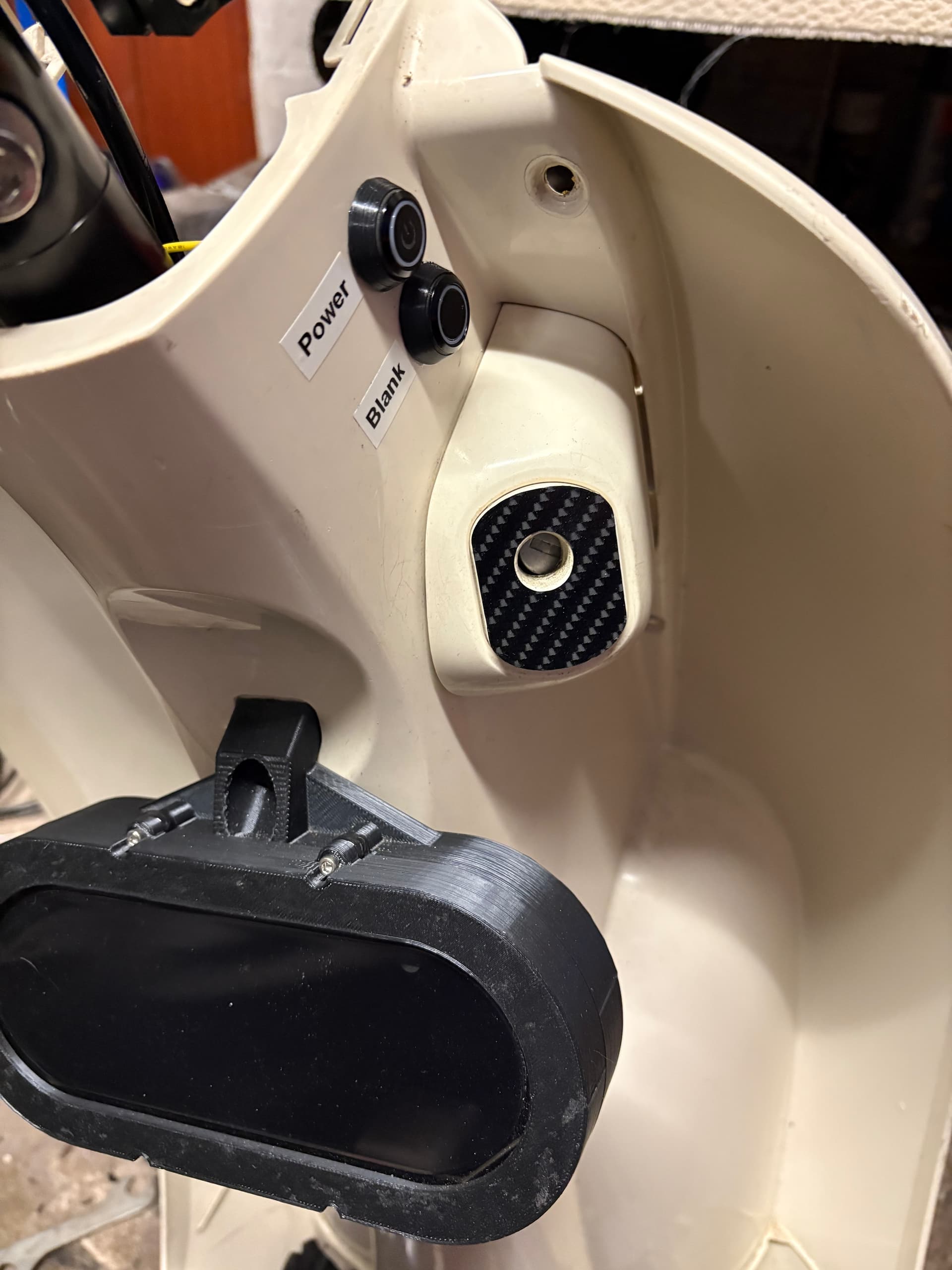

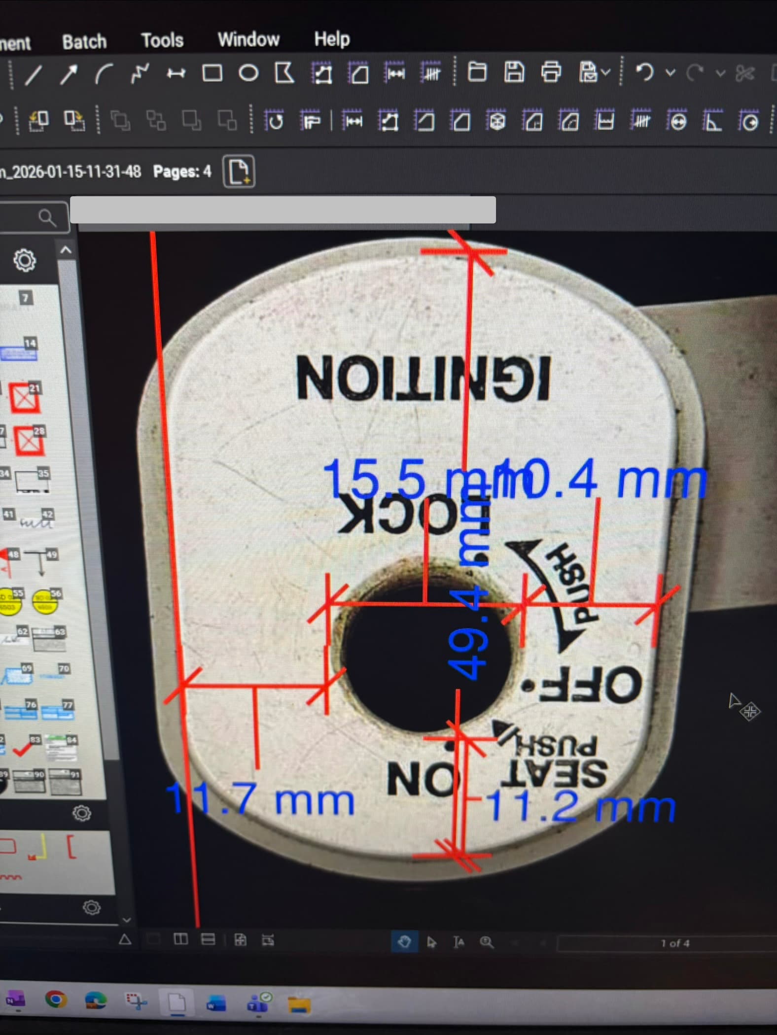

Working through the key location issues. It’s harder than I thought as there is limited movement on the key before you hit the plastics.

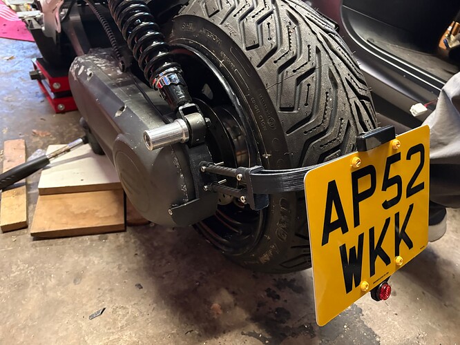

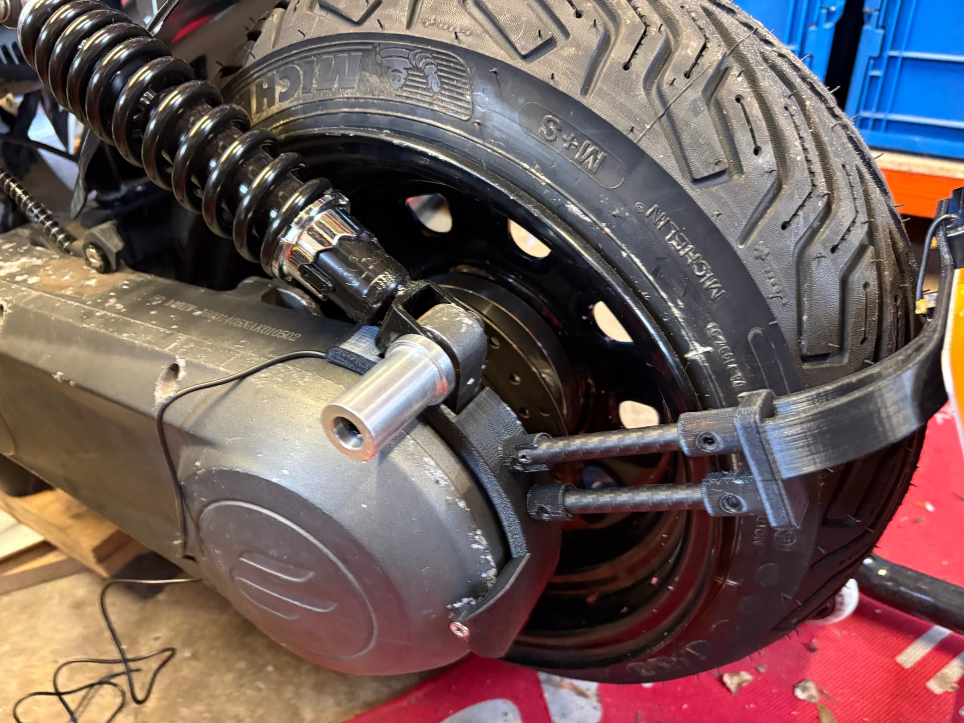

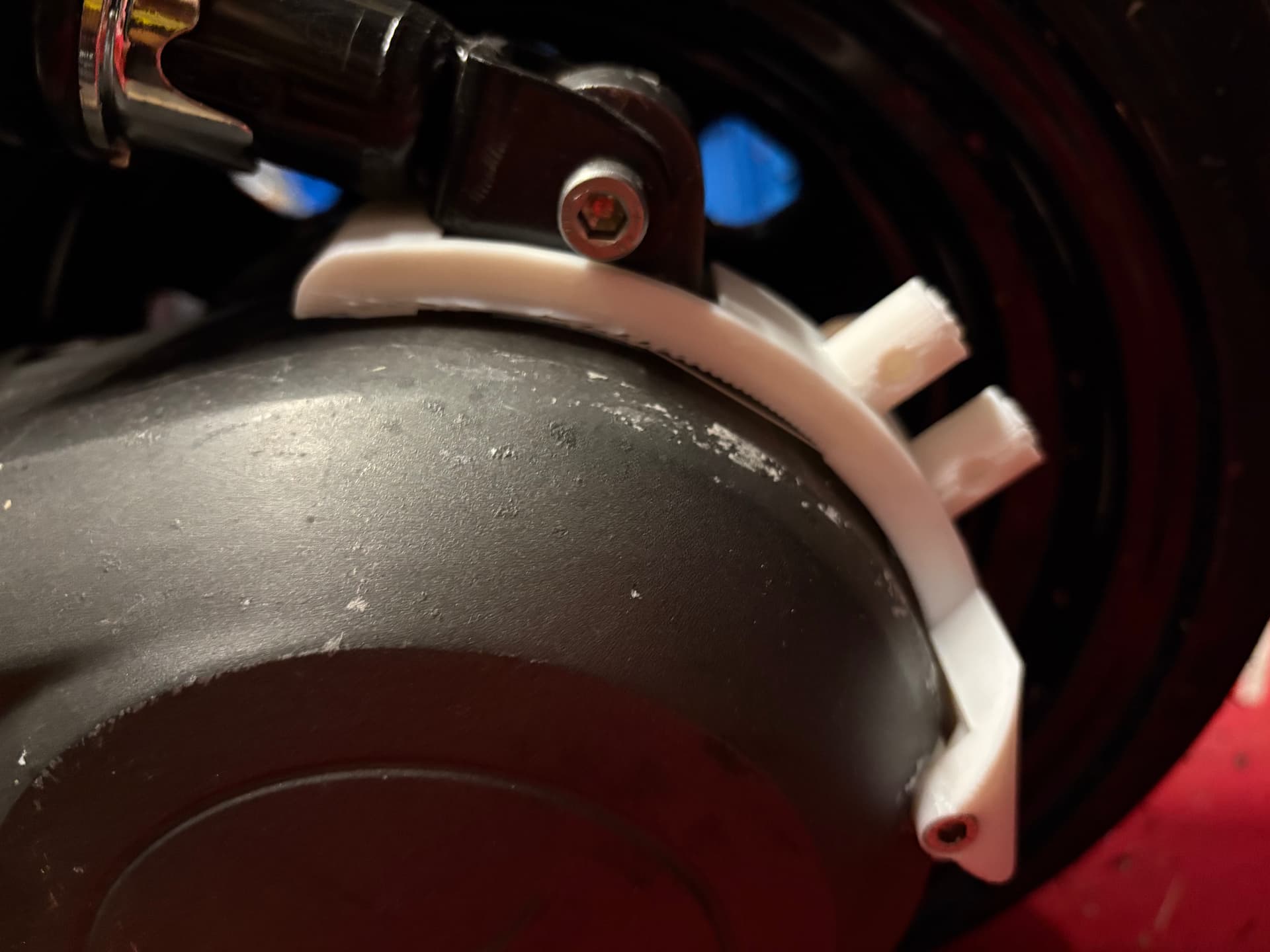

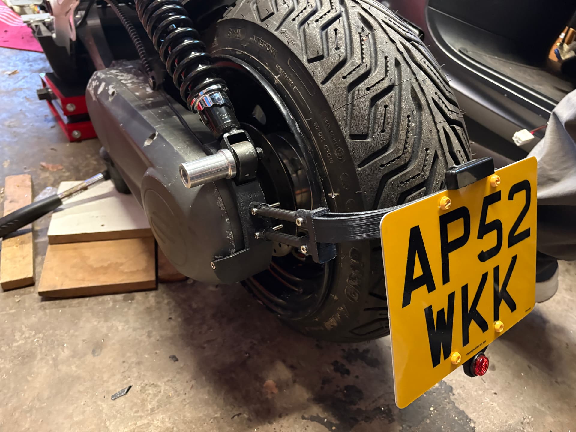

Also trying out extending the number plate mount to reduce some vibration.
Finally got the number plate mount right. With a recess underneath for the plate light wire…

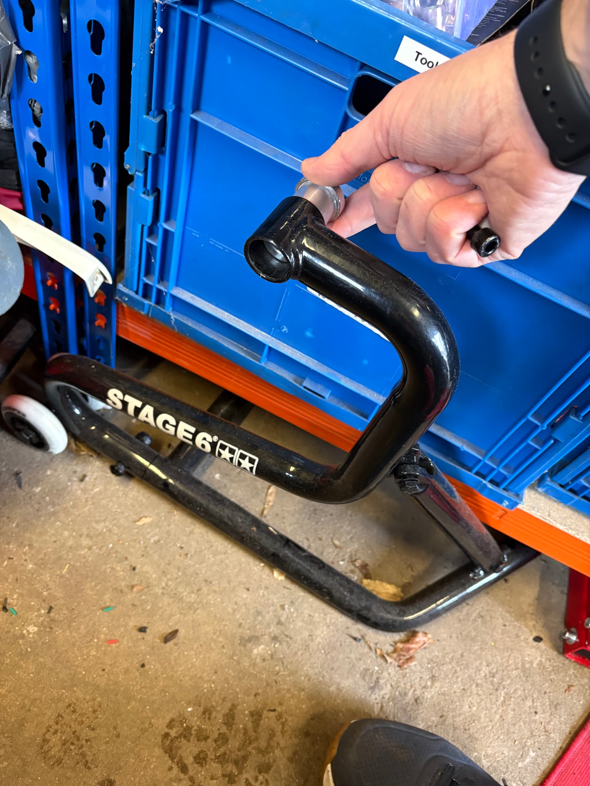

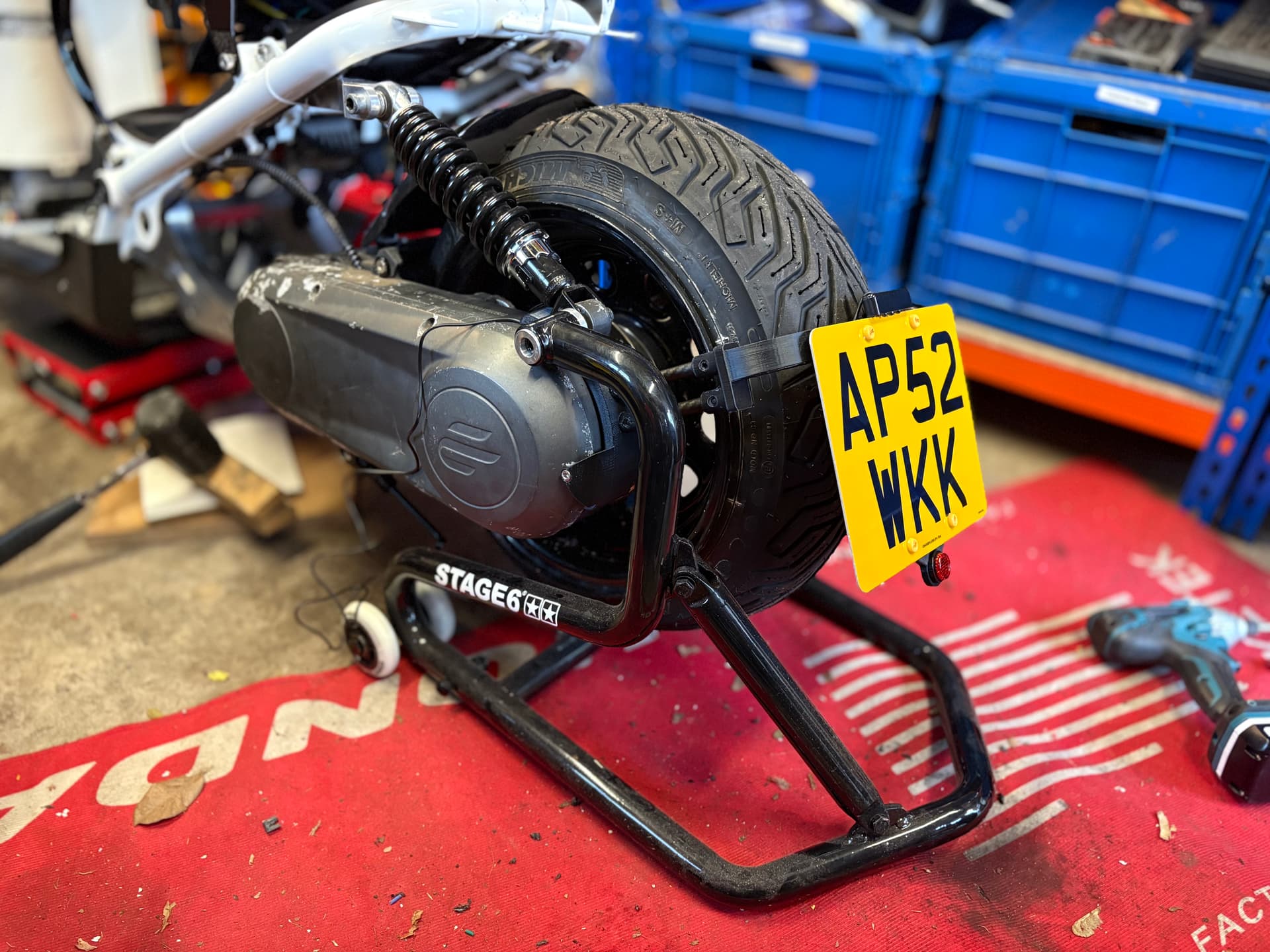

But then remembered I have a stage 6 paddock stand quick adaptor.
I want to fit it as it will make my life easier in the future. So now have to adapt the bracket again. Attempt no who knows is on the printer. 10 hour print…: so will see how it turns out.

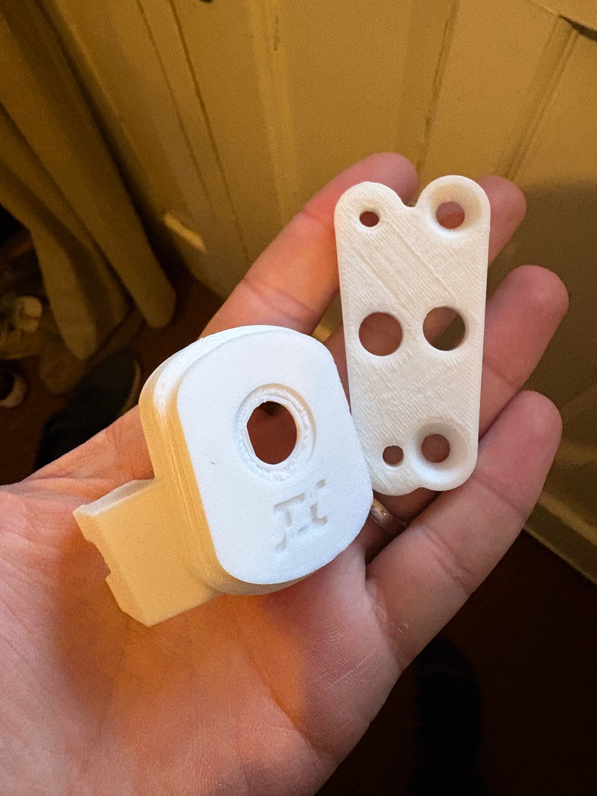

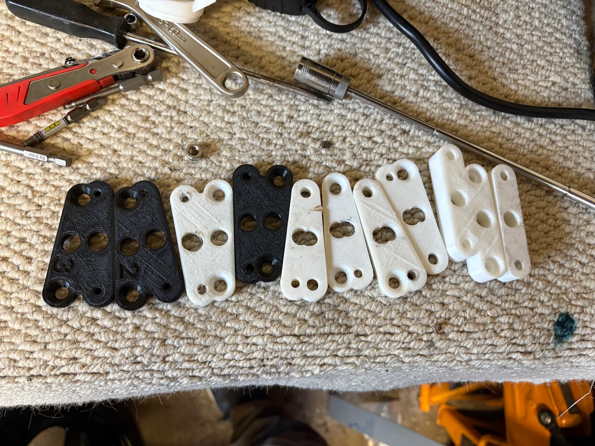

My key bracket is taking some time to get right as well…
The positioning of the key is good enough to use, but just trying to perfect it now. I’ve started numbering the last ones so I can check which is the best fit.

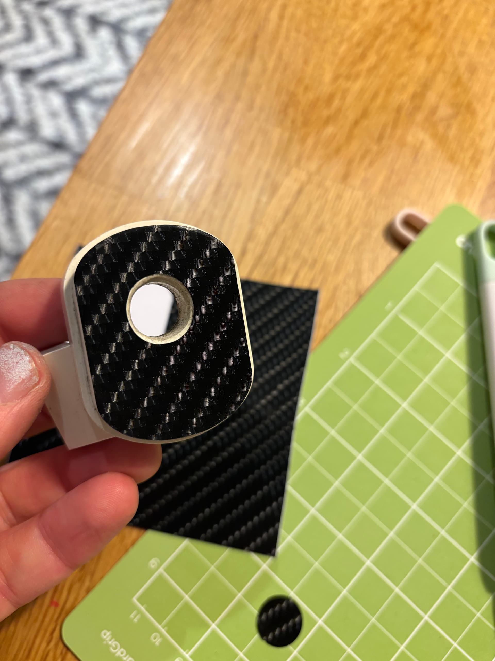

Uk mot says you don’t need a steering lock, but if it has one, then it needs to work. Mine doesn’t as I’ve swapped the key barrel over and offset it.
So have used my cricut to cover up the steering lock symbol, so they can’t say it had one.
It’s a 5d carbon weave vinyl so is kind of holographic. Quite cool.
Have also added labels to the switches temporarily for the MoT. Will take them off after.

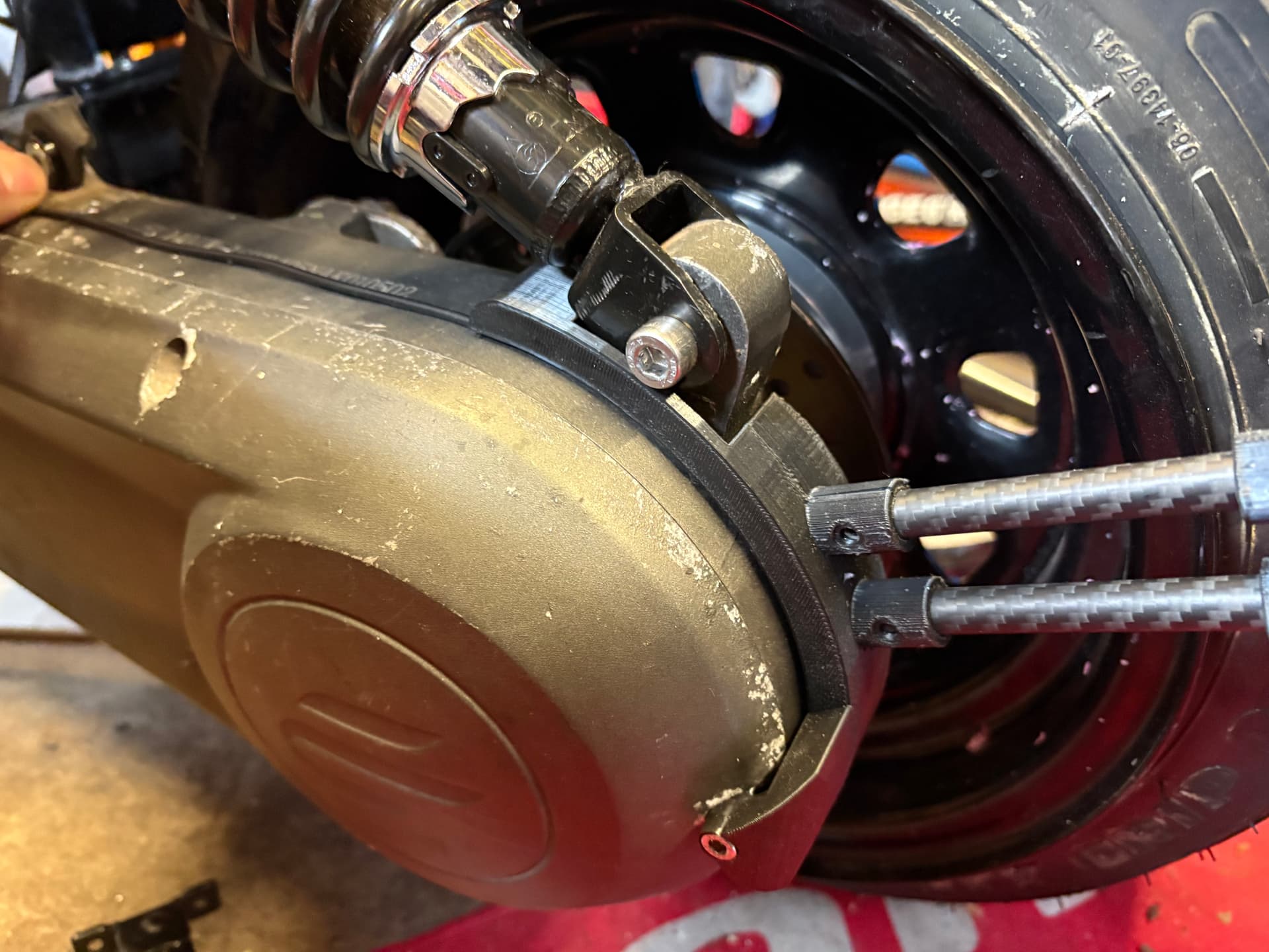

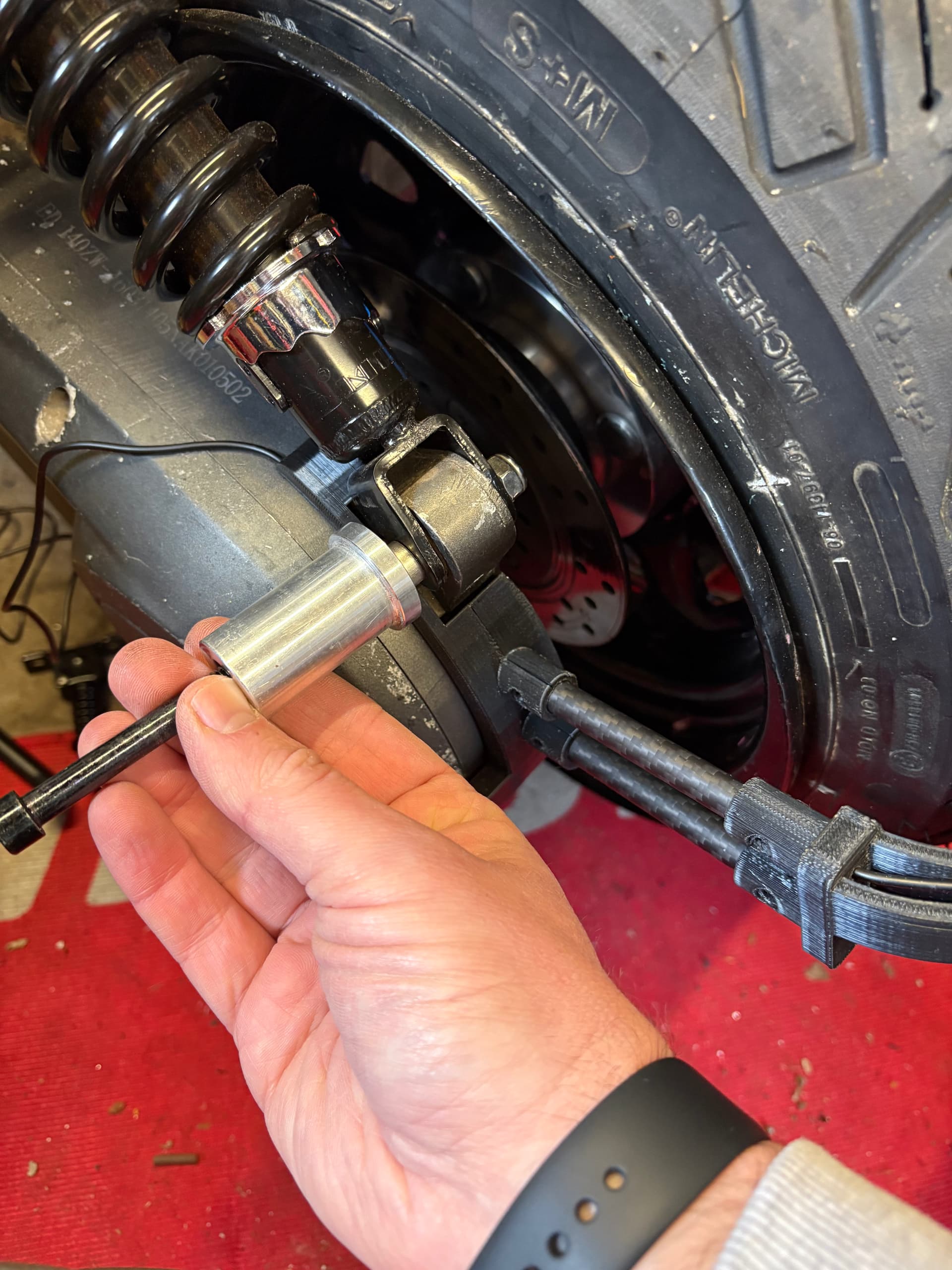

New rear plate bracket and paddock stand bracket. Although I broke the mount being an idiot - so need to print it again!
Added some bolts which tightens it all up. Have ordered the right shorter length so will swap out when they arrive.

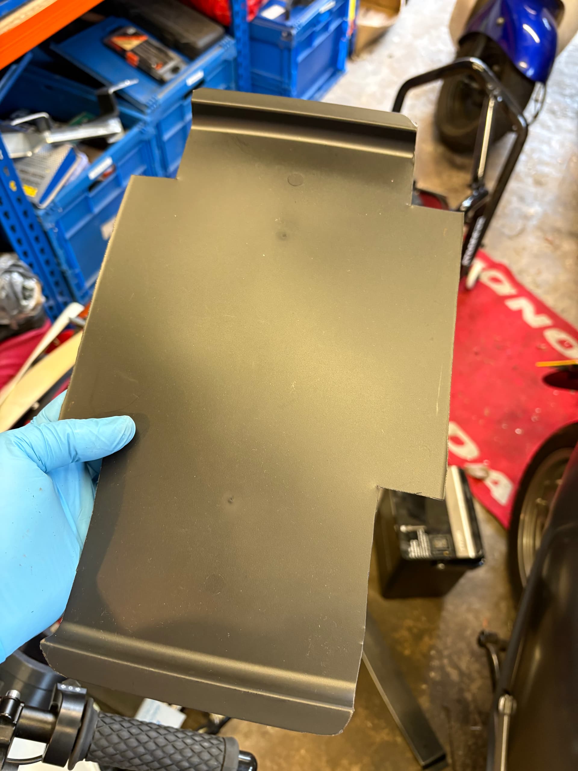

Have made a rear splash guard for the battery location.

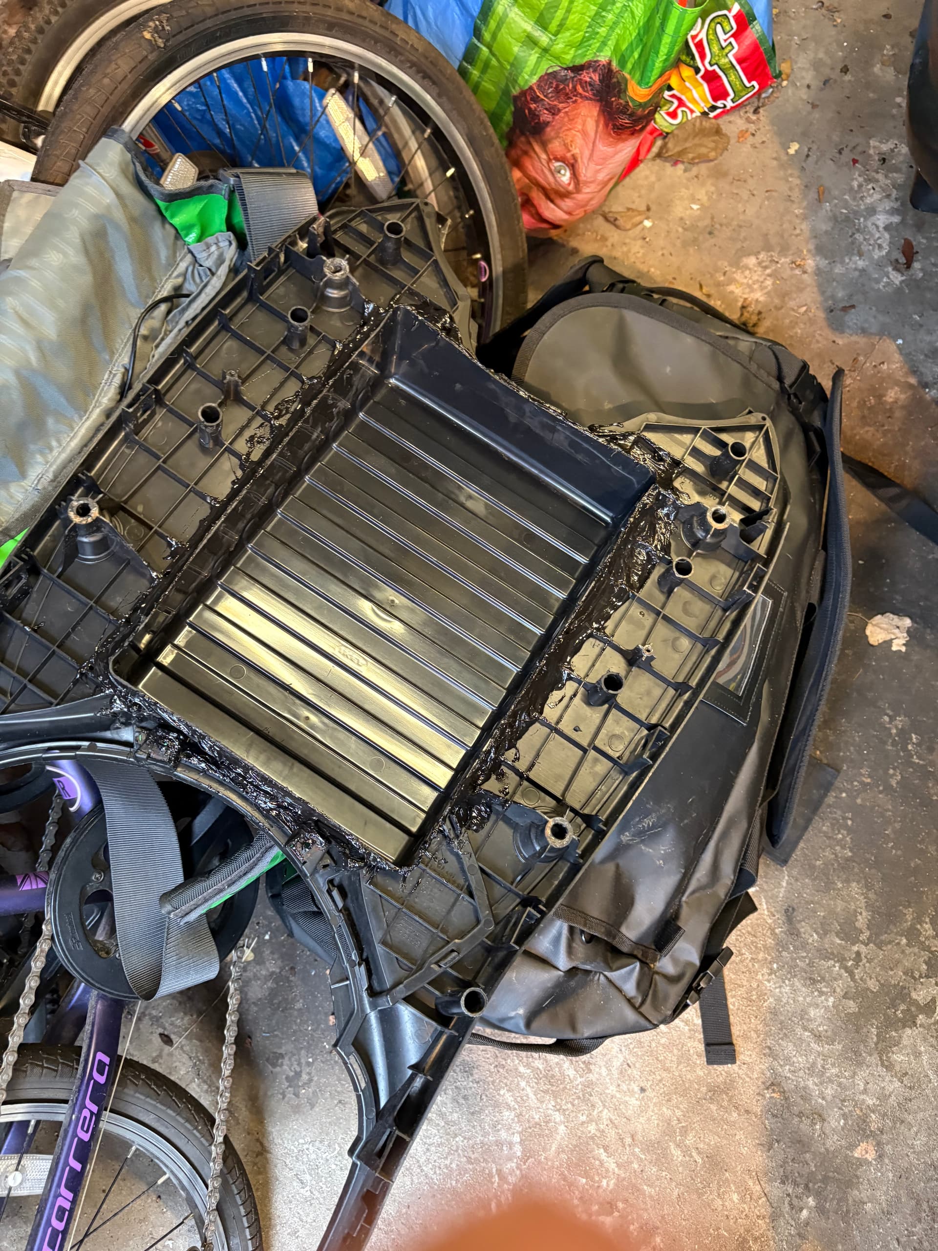

Have plastic welded and mansory glued a plastic cover with the floorboard.

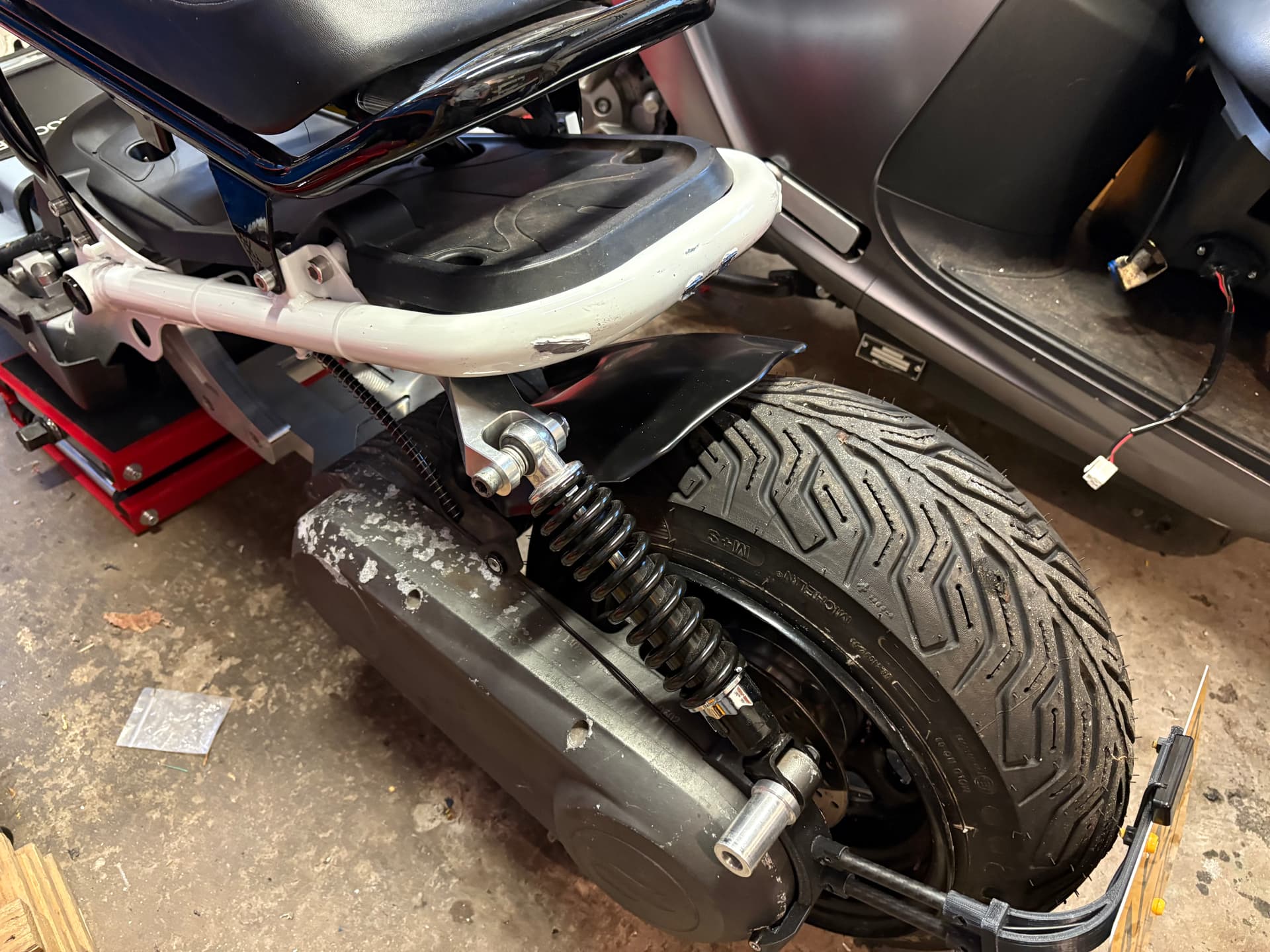

Finally cut off the rear frame brackets.
But my Dremel broke so I can’t tidy the welds up. Grr.
So nearly there…

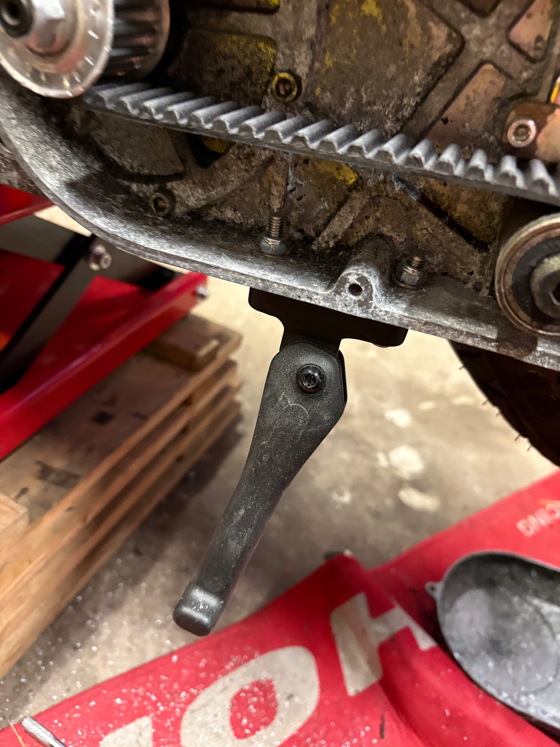

  1. Fit a new kickstand. The one I bought was cheap and broke. New one should be arriving today.

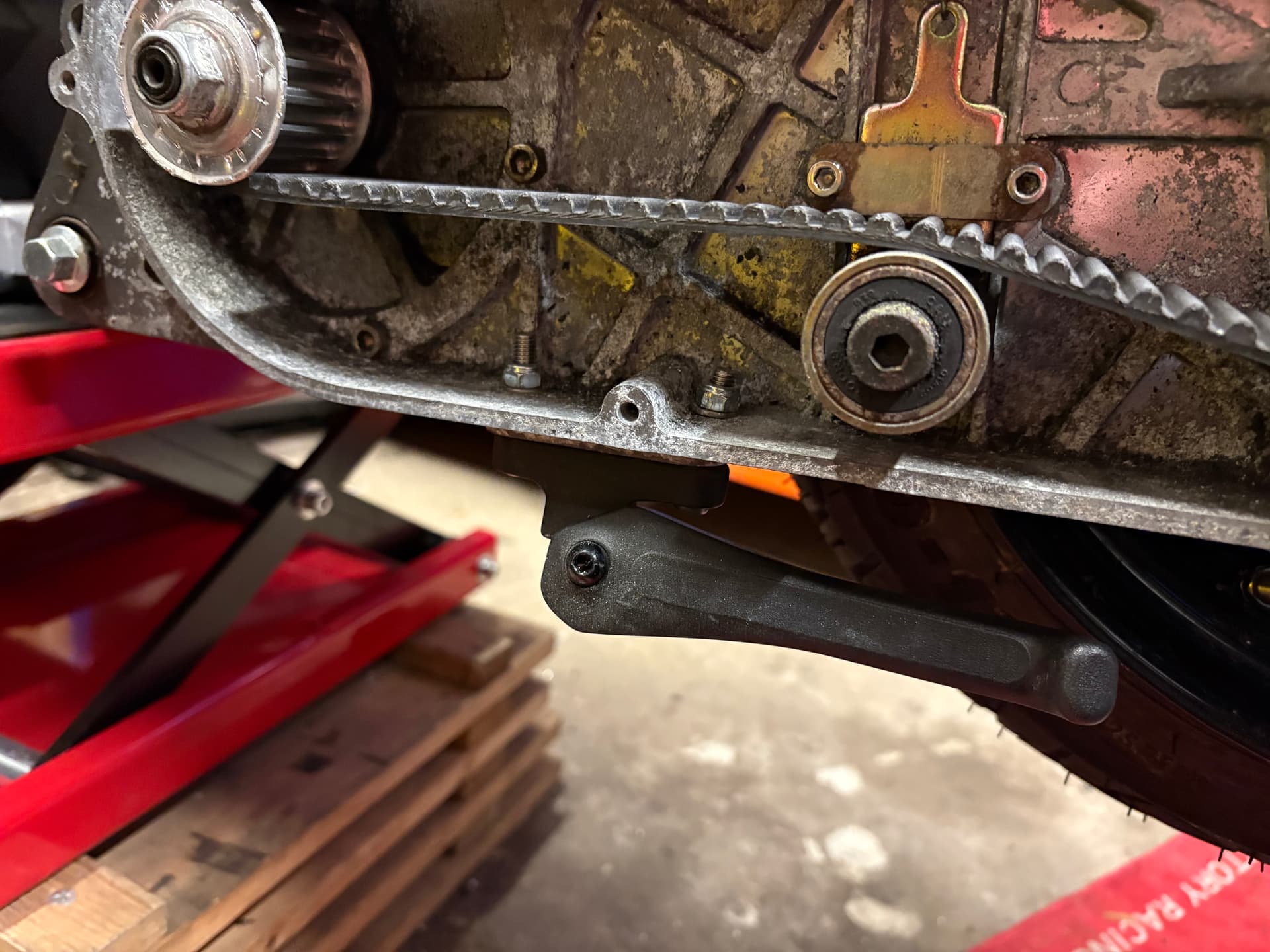

So just 3 things to do. The kickstand turned up, but the bolt spacing is different - so need to drill and tap a different hole, but the stand looks better quality.
Finally got a new dremel and finished shaving the frame brackets.
priming and painting it - not my forte…

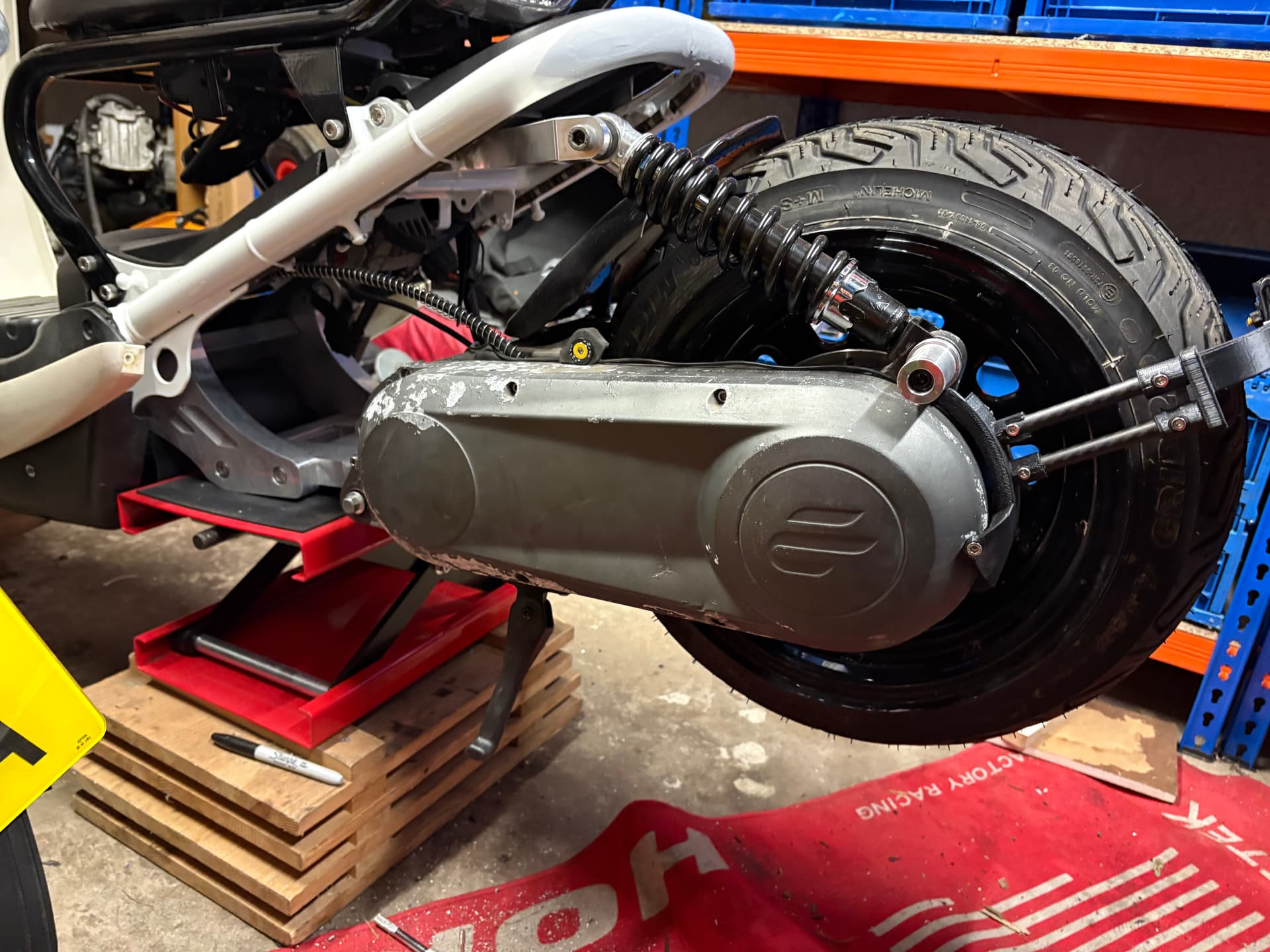

Brakes also re-bled and now work. The paddock stand is great for this sort of thing.

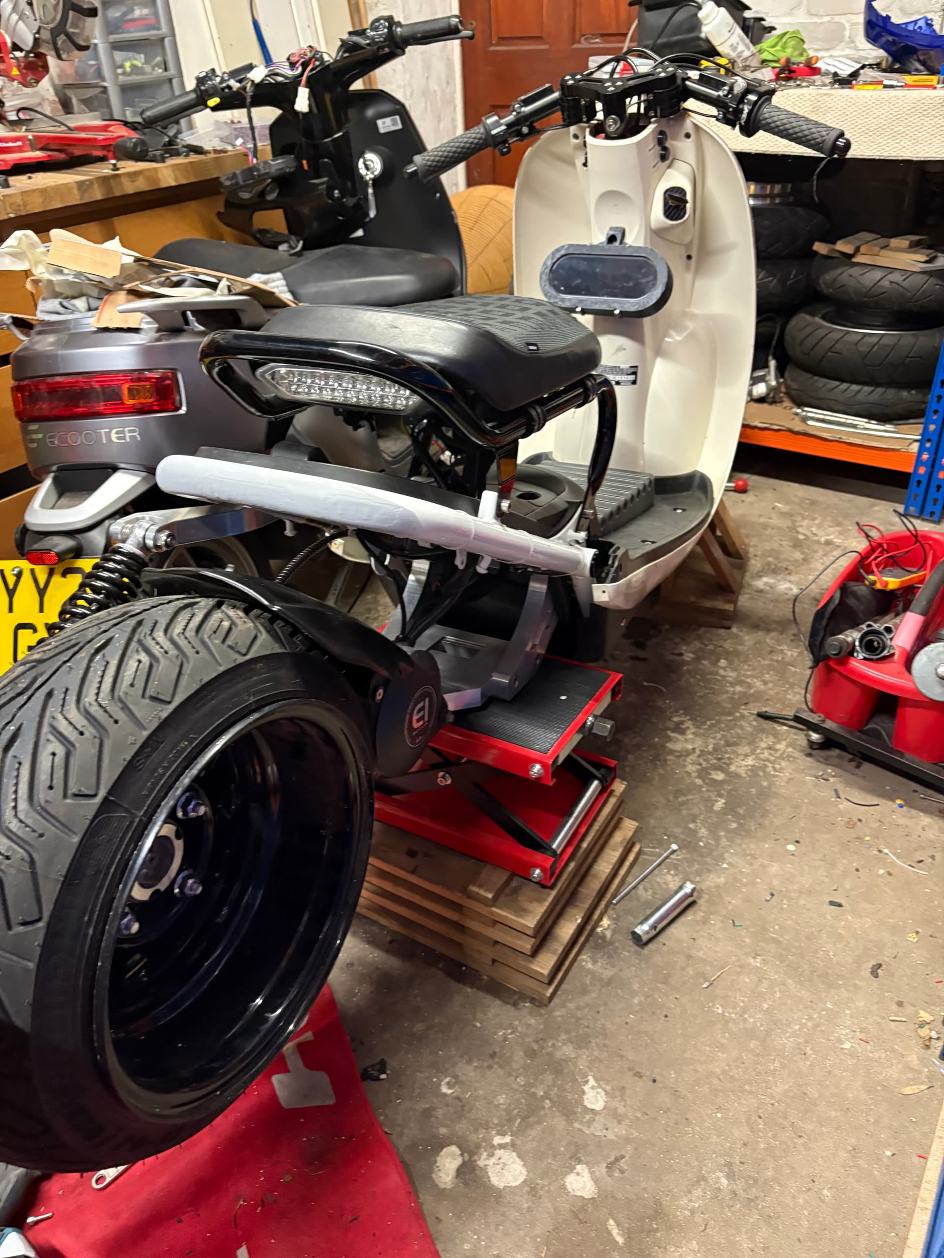

So it’s just the kickstand to re fit and then I’m completely done. Can’t quite work out how to do it though, now that the bike is off the bench I can’t get enough room under it to get a drill under (and straight). Hmm. Need a proper motorbike lift…
Rigged up a lift on a timber platform.
Gave me enough room to get under and drill. The tap didn’t work though as the location clashed with an old broken off bolt.
So F It. I took off the cover and drilled straight through and nut and bolted it! I’d probably stronger anyway.

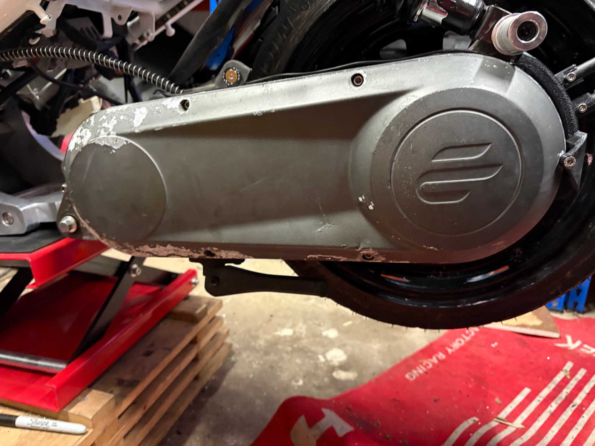

Although I might paint the cvt case black… and maybe the yellow panels too…
Was thinking I was gonna change it up to black, so it was all black and white.
AI isn’t convincing me though…

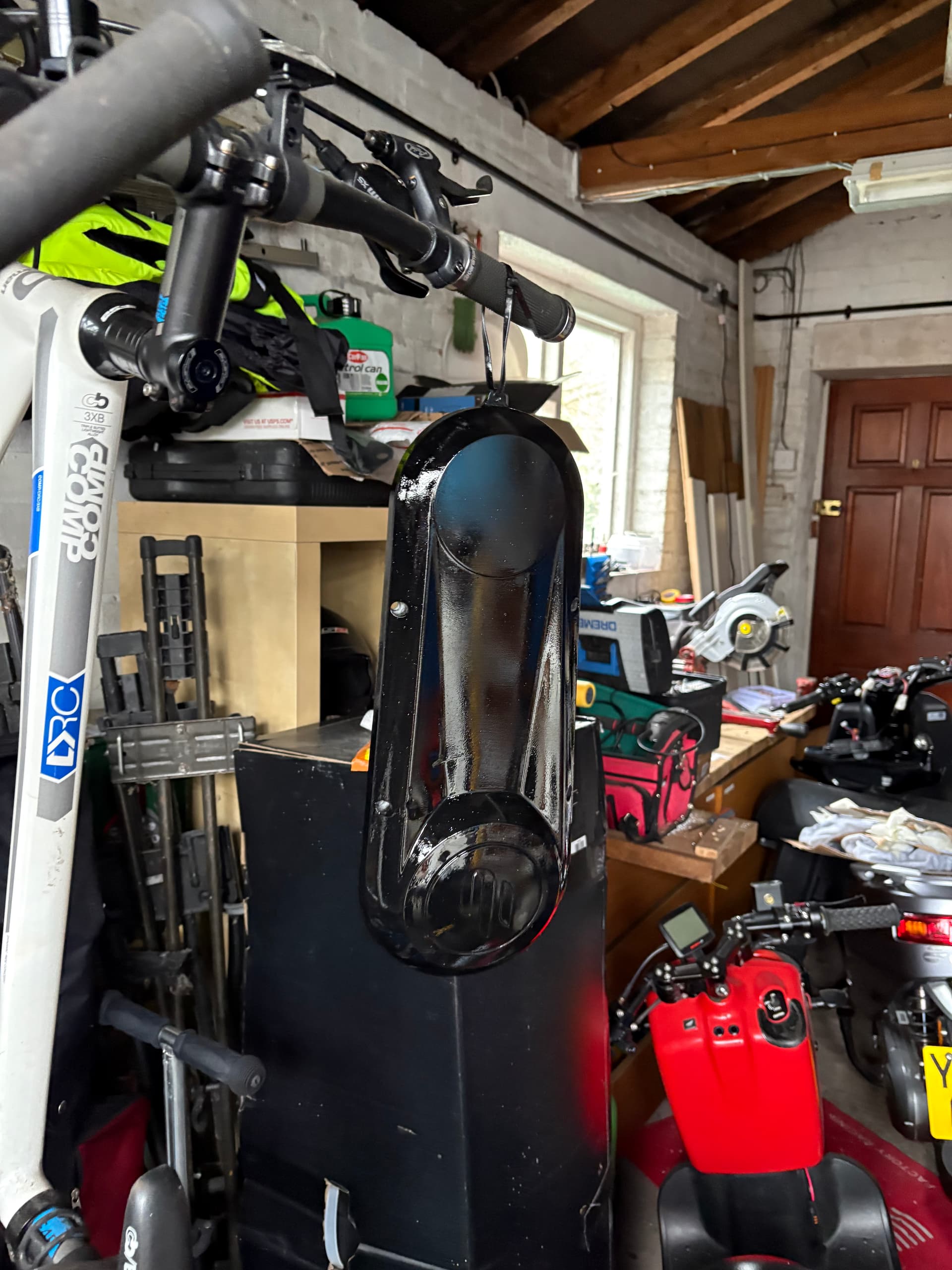

Painted the cvt case black to neaten it up…

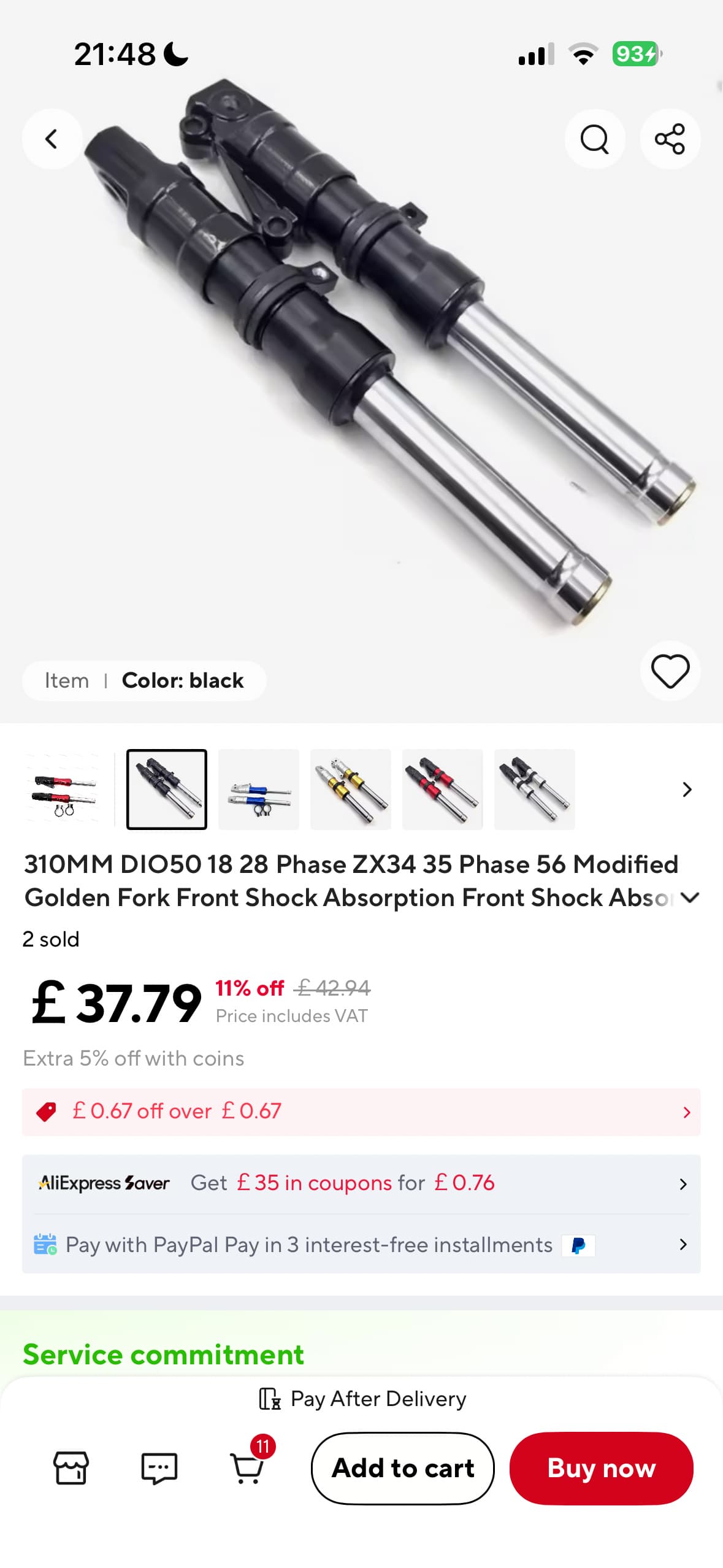

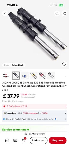

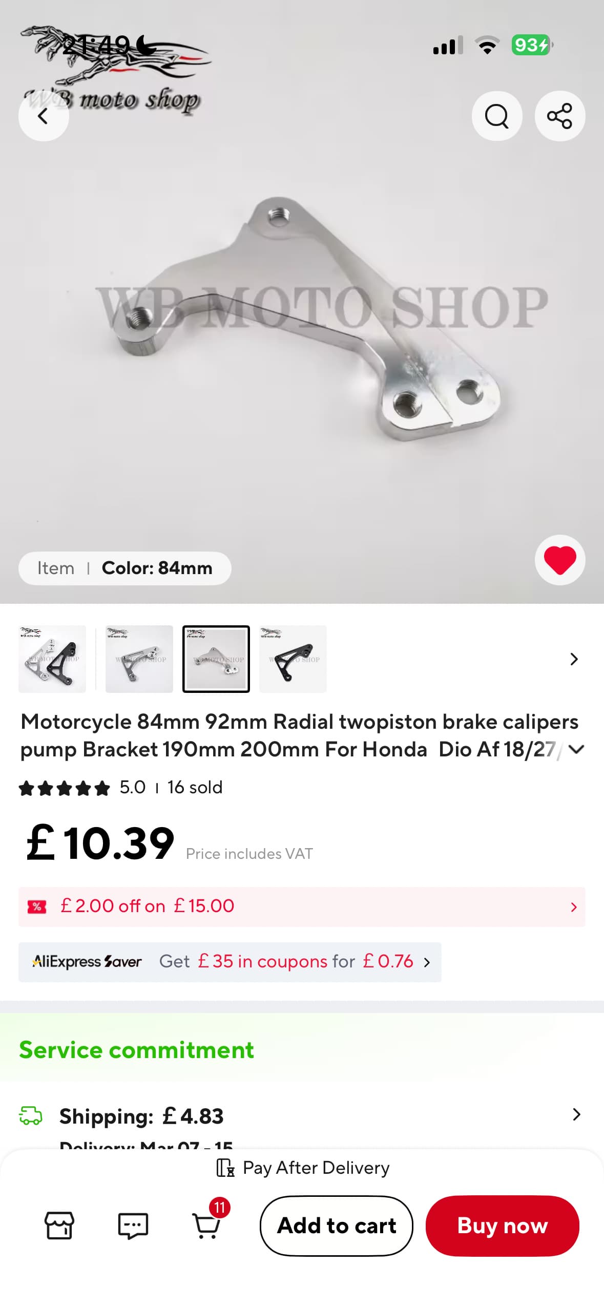

Worried the front shocks are too far gone to pass a mot. So went to order some backup ones in case… the price of the low downs have gone crazy. I used to pay £60. Now they are about £200.
So I’ve ordered some dio shocks. They are 10mm longer (310mm instead of 300mm) and the caliper bolts are closer together (84mm instead of 92mm) but you can get them for <£40. Plus £10 for the caliper bracket.

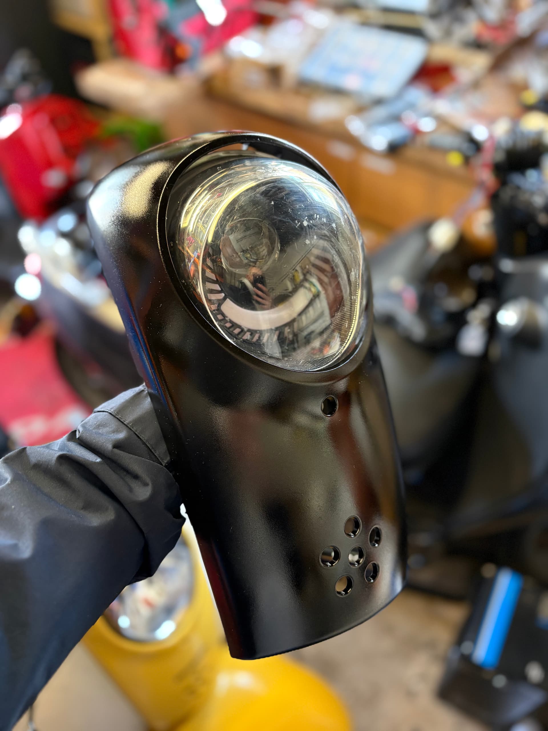

  2. the headlight beam is too high, but you cant adapt it anymore. going to go back to a stock headlight whilst i figure it out.

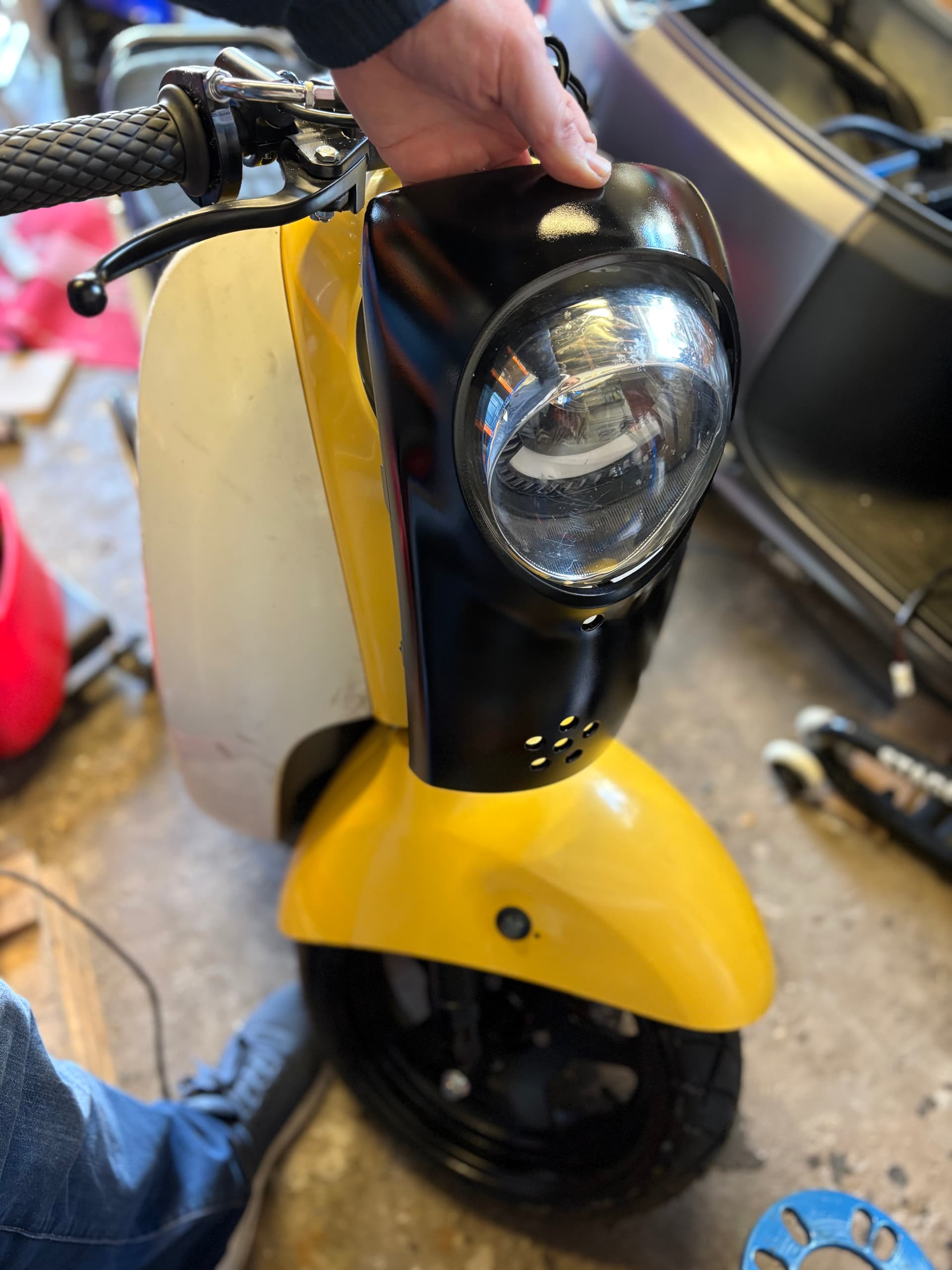

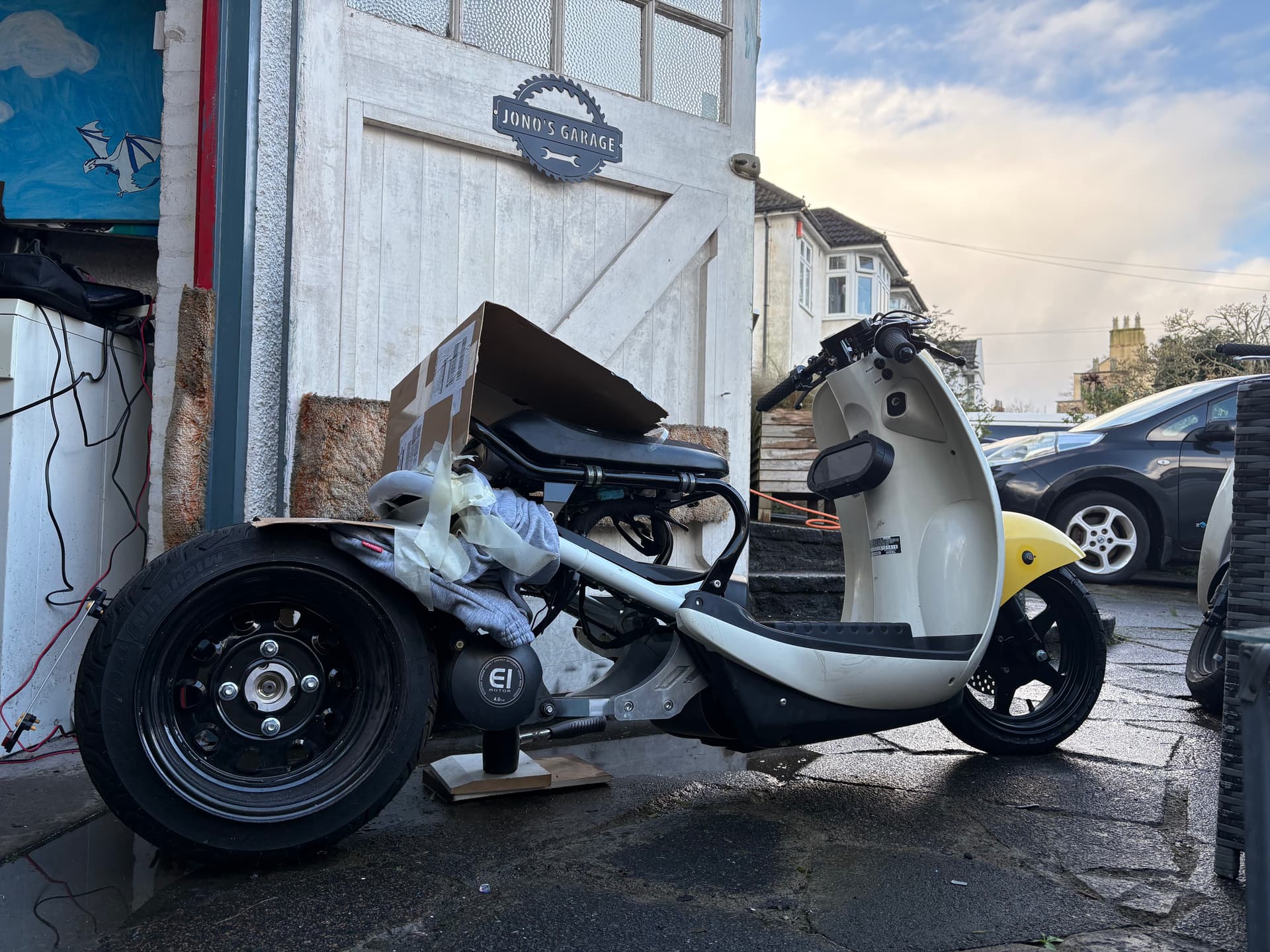

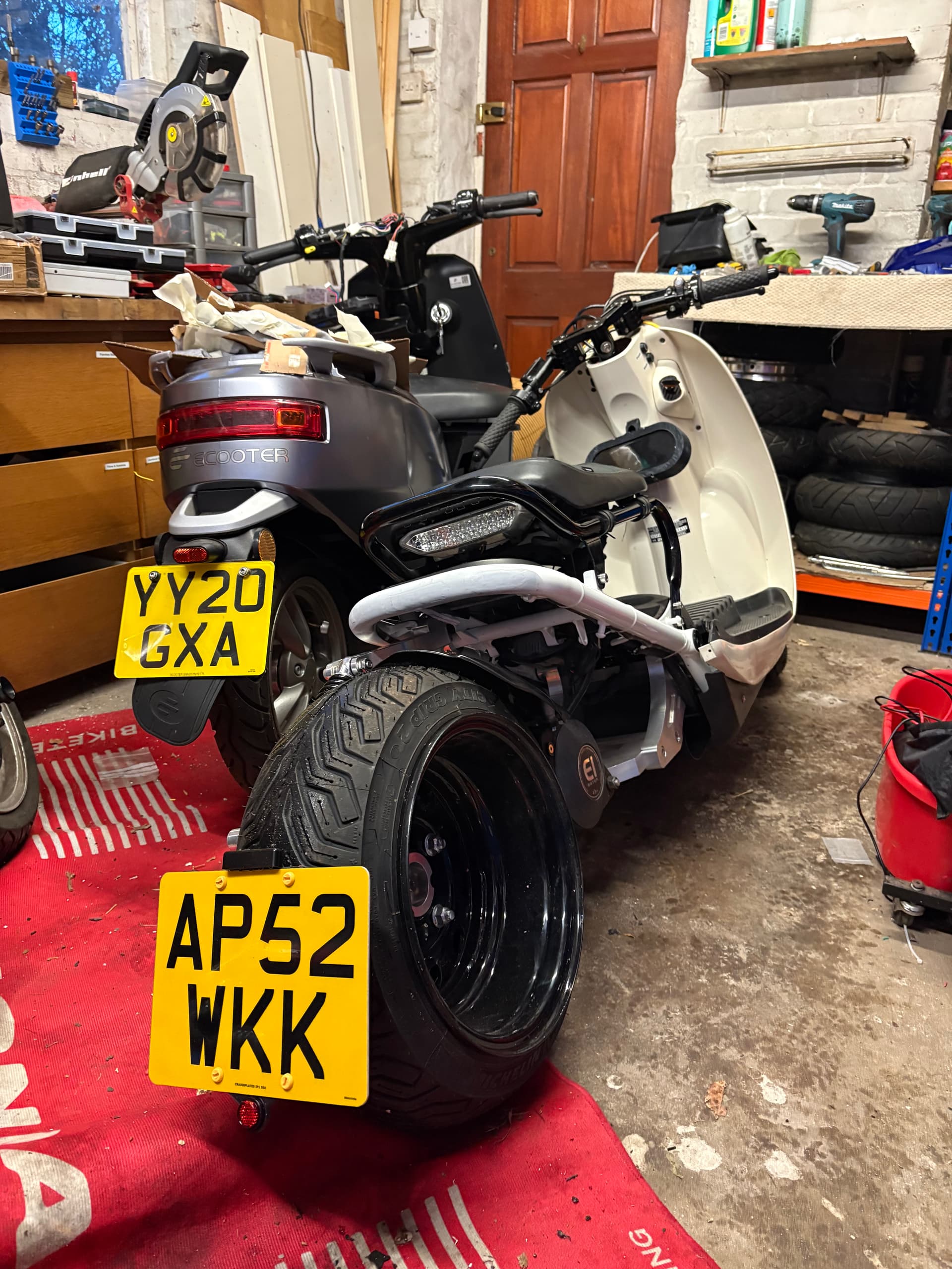

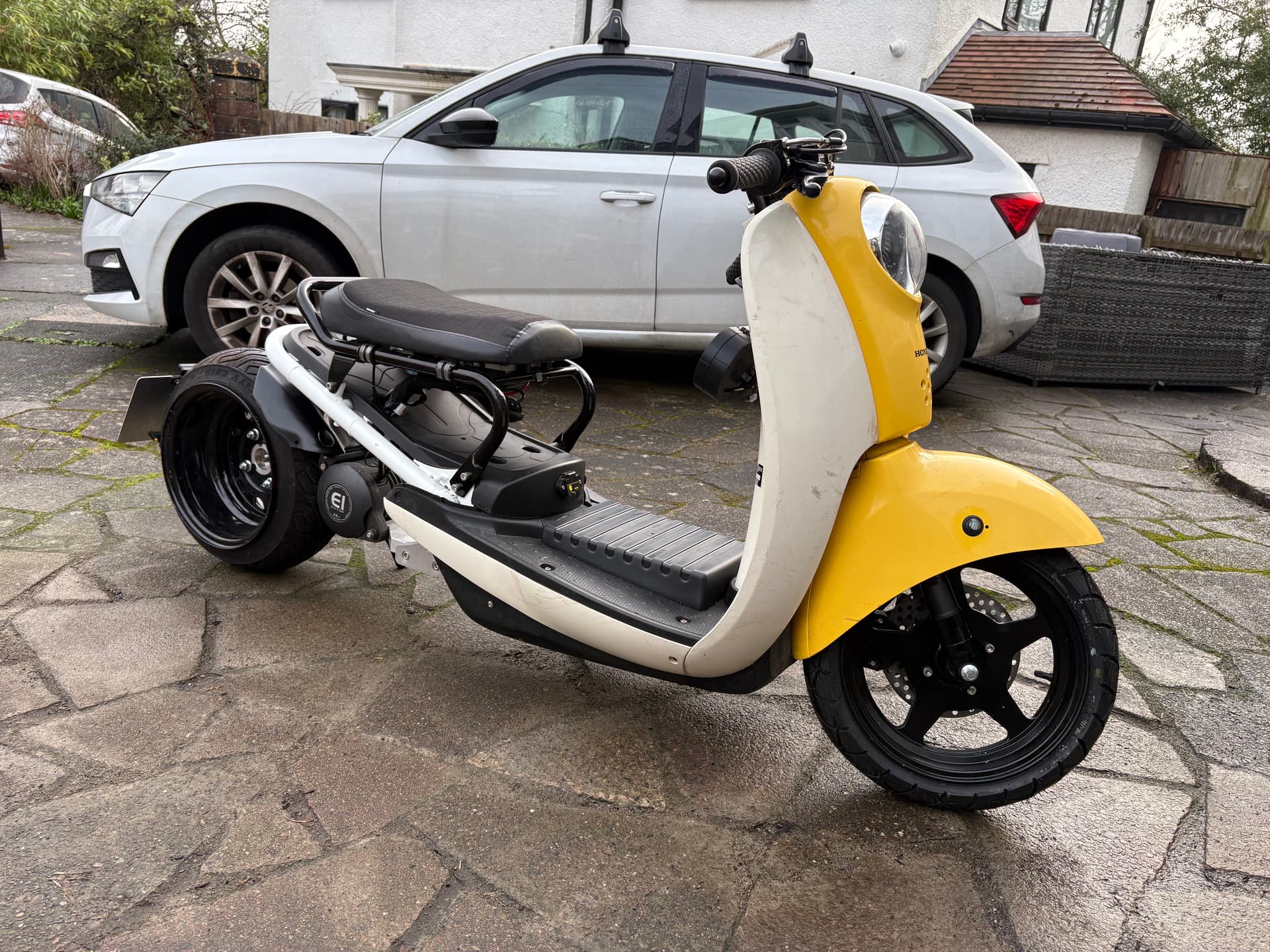

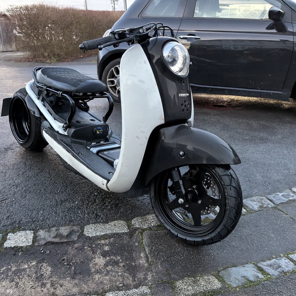

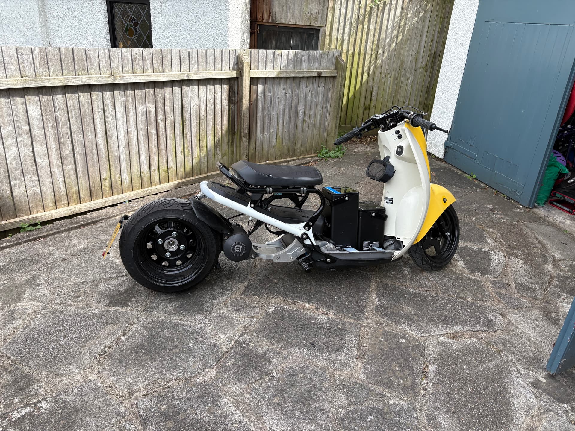

heres some photos of where it sits at the moment…
I rode it to the Most centre and lots a fair chunk of battery, so I think it’s probably max 20miles range. So might have to look at fitting in the bigger battery at some point.

Swapped out for an old headlight and bulb.

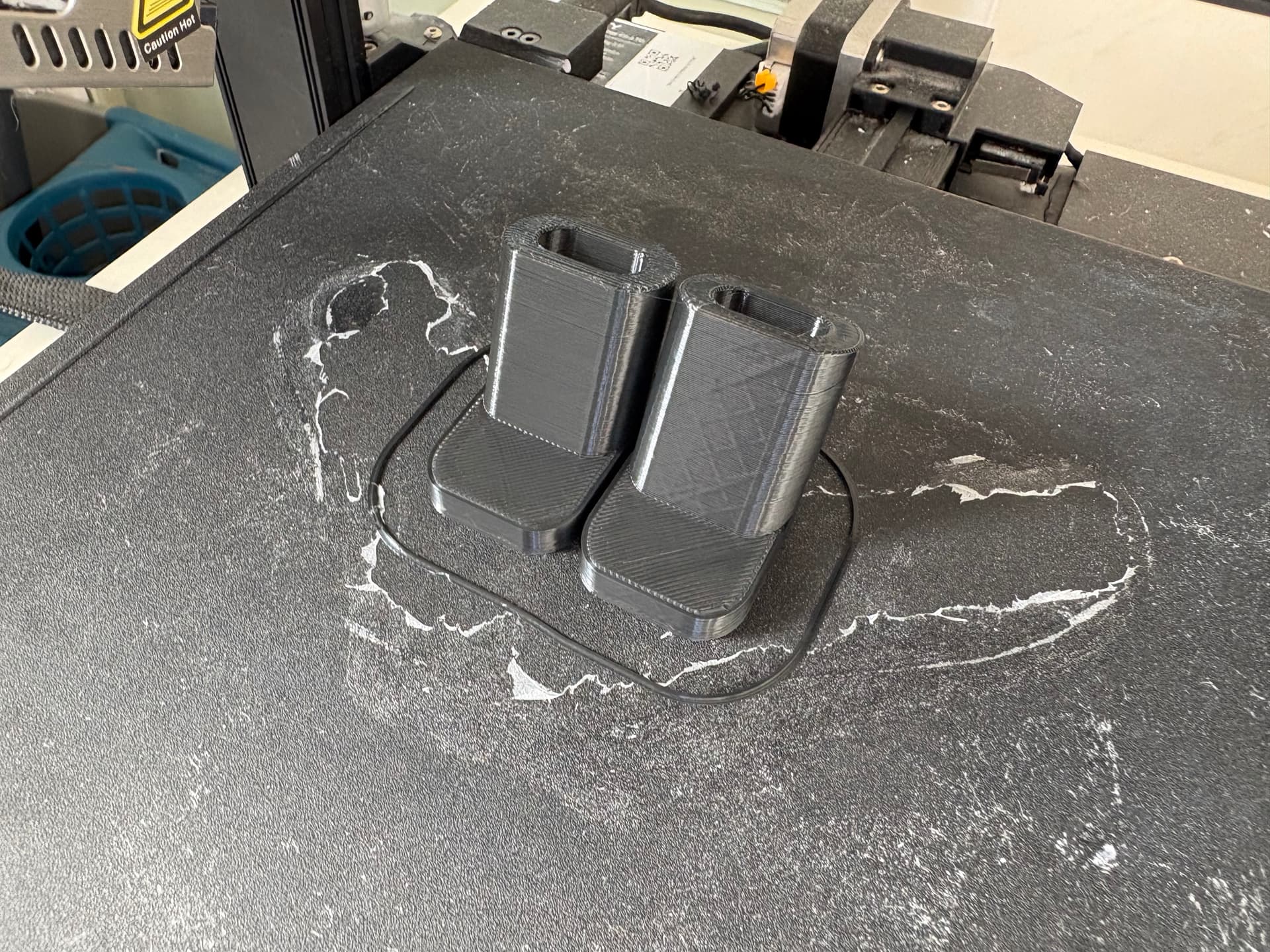

Also cut down the kick stand as it was too long. Gonna 3d print a foot for it.

Printed some feet for the cut down kickstand…

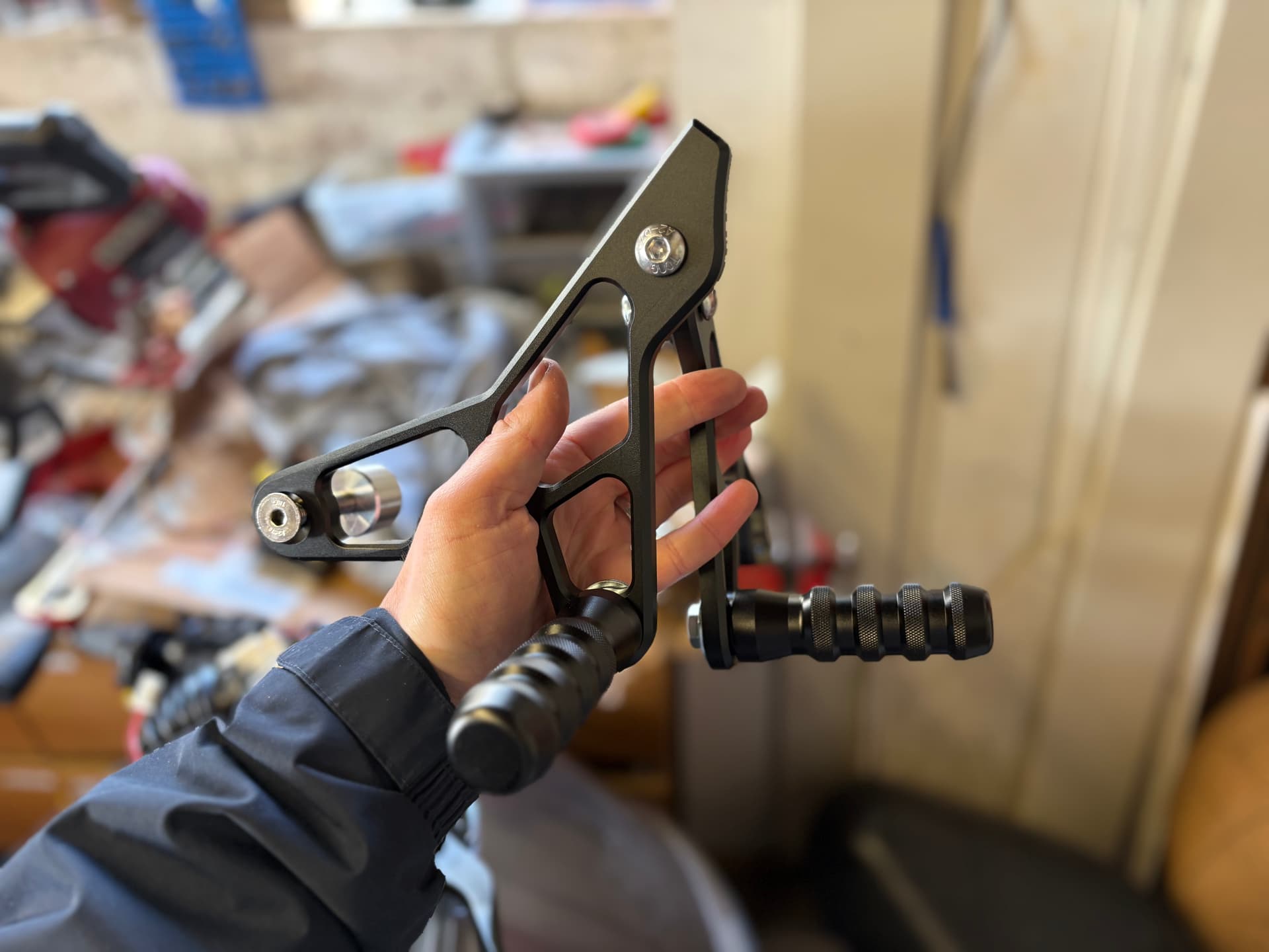

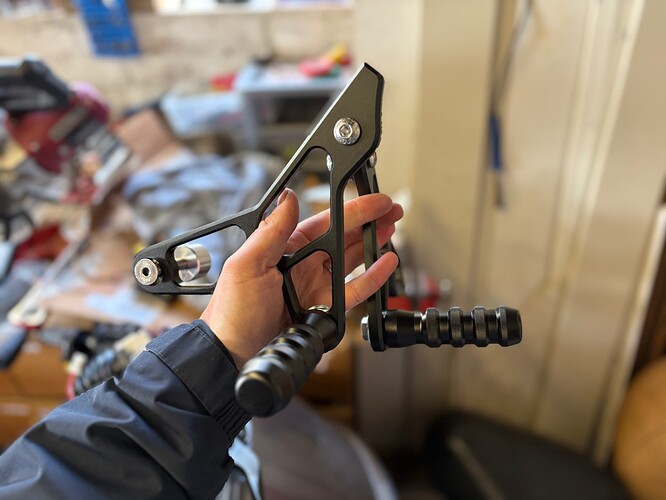

FLP kickbacks turned up.
I much prefer riding with rear sets. Just waiting on longer bolts that I’ve ordered as they need to include my mount as well. This will be my last mod though!!

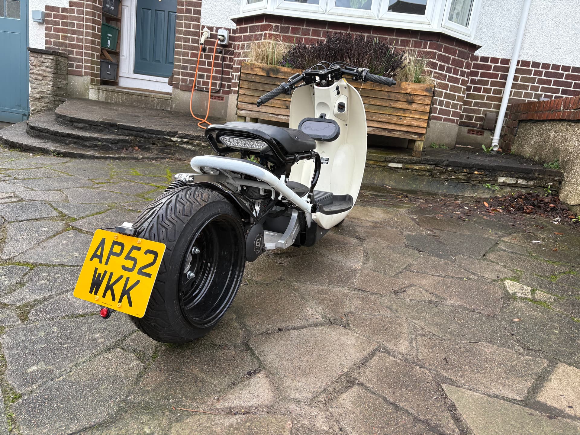

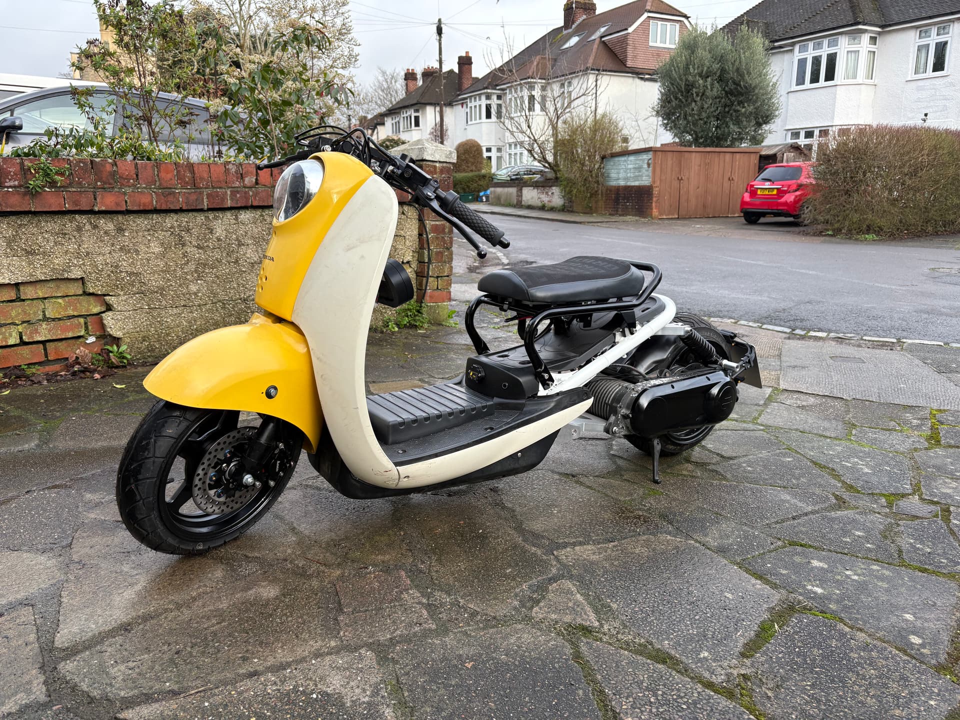

MoT passed.
had to put the original headlight back in rather than an aftermarket one.
it wasnt the steering head bearings - the bolts were loose where the shocks connect to the triple tree. bit of a stupid mistake by me not doing those up! shows the point of an MoT though - i would have been riding round and the bolts would have fallen out if they hadn’t of flagged it.

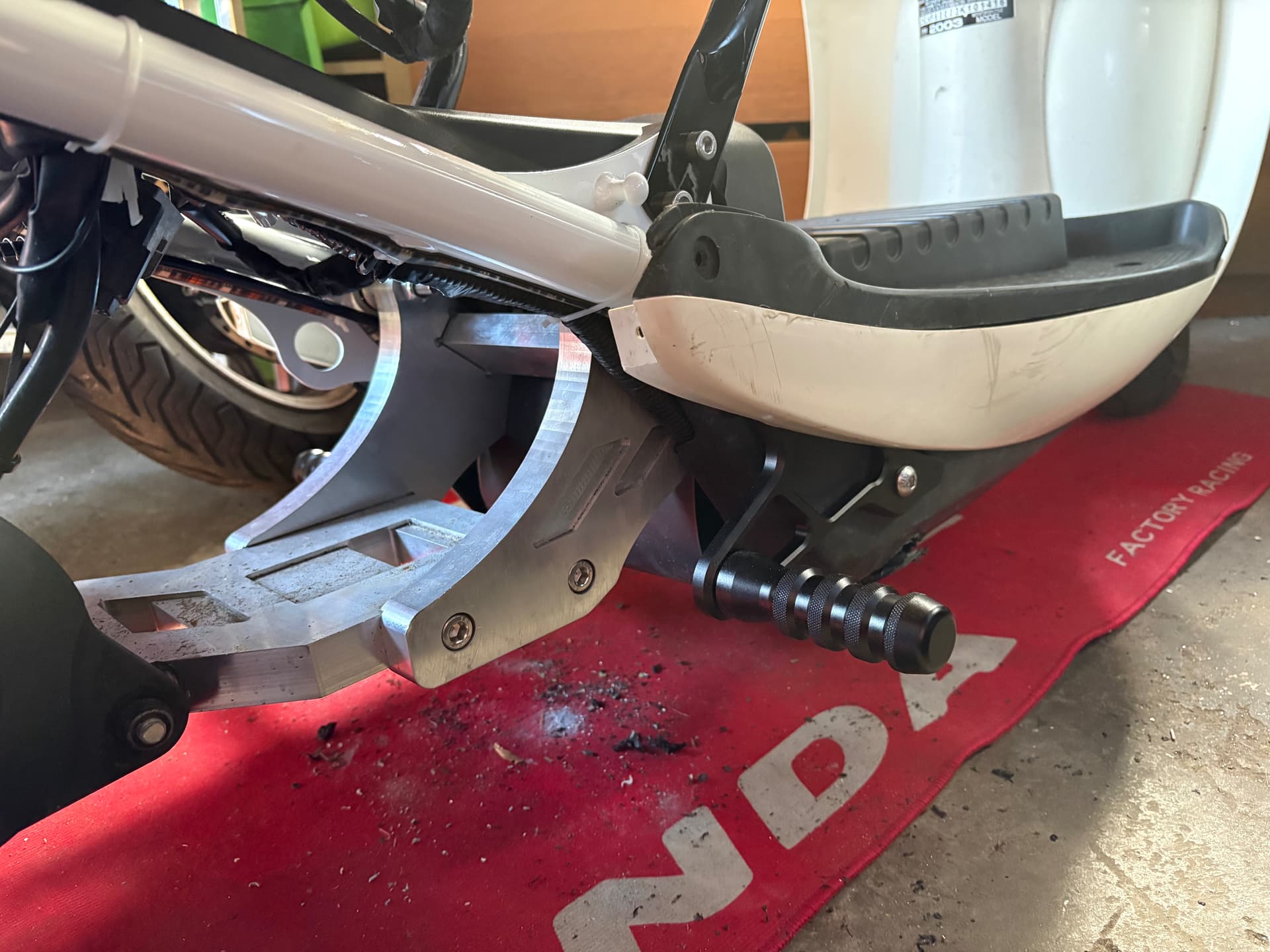

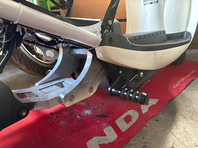

FLP set backs fitted.
These make riding so much more comfortable. Couldn’t do with out them.

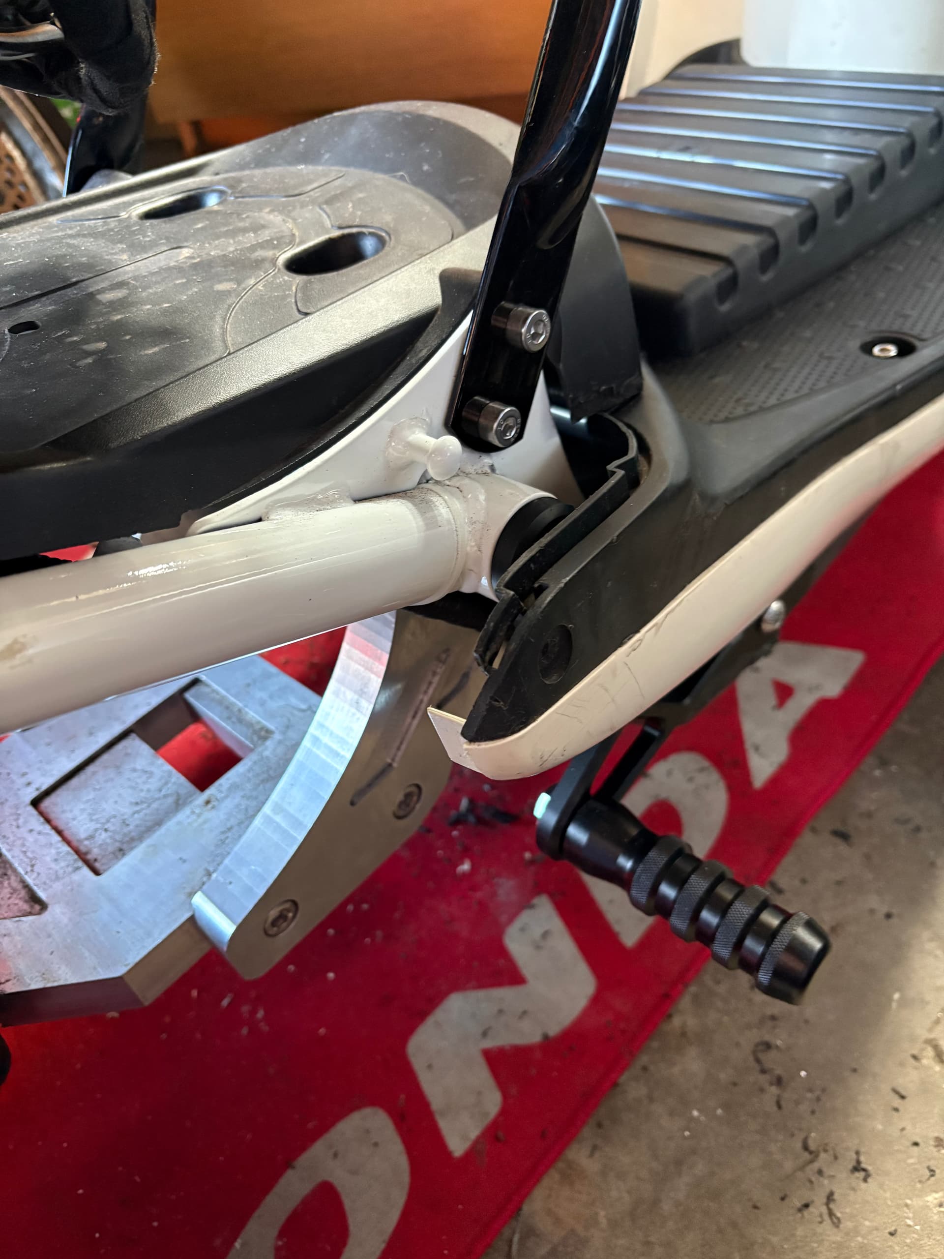

They were an absolute PITA to fit with the Met undercowl plastics. Had to cut a hole in the under cowl to get access to the ruck rear frame to do the lower mounting bolt up. For now I’ve folded the plastic flap I made back up. Should probably neaten it at up some point.
The set backs seem to work with my engine mount ok.

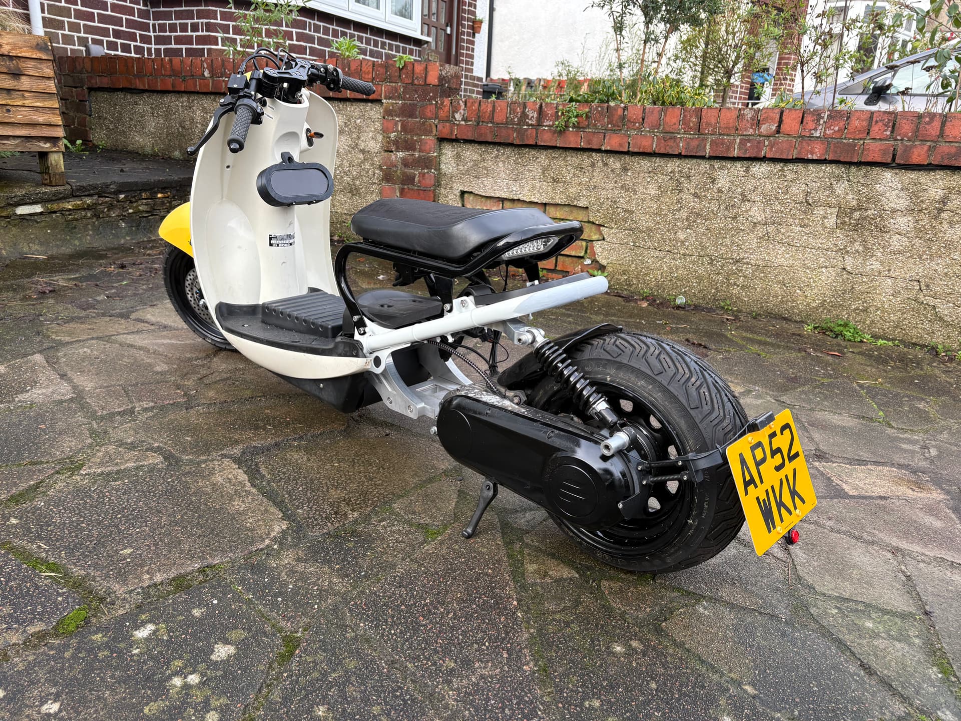

So that’s it. Build over. Time to think about what the next project will be…

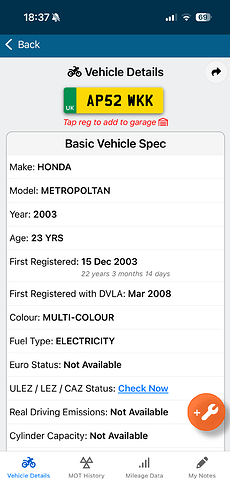

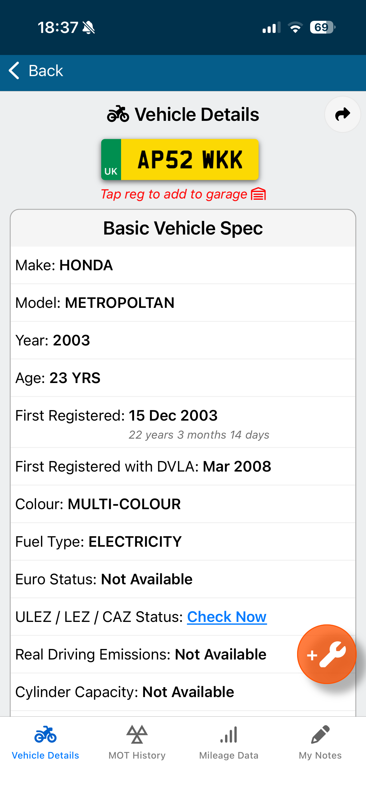

My electric conversion is now fully registered with DVLA. Well happy with that! Had to compile a bunch of paperwork and supporting evidence, but wasn’t as bad as I thought it would be. If anyone does an electric conversion and wants some help with the process, give me a shout.

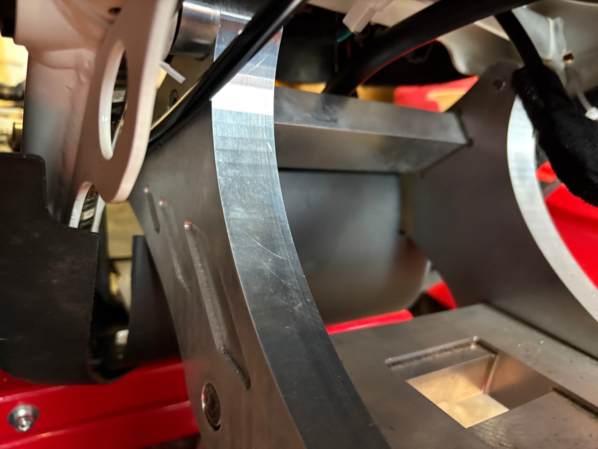

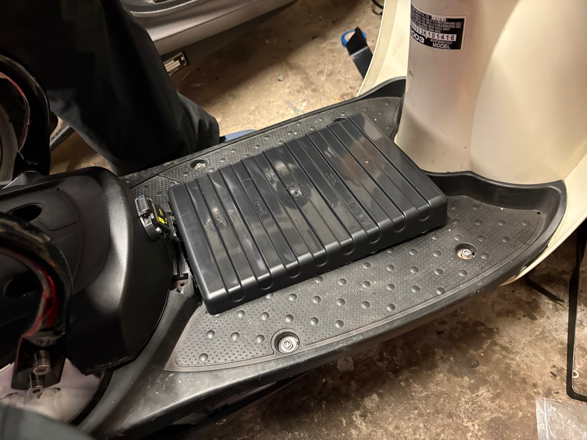

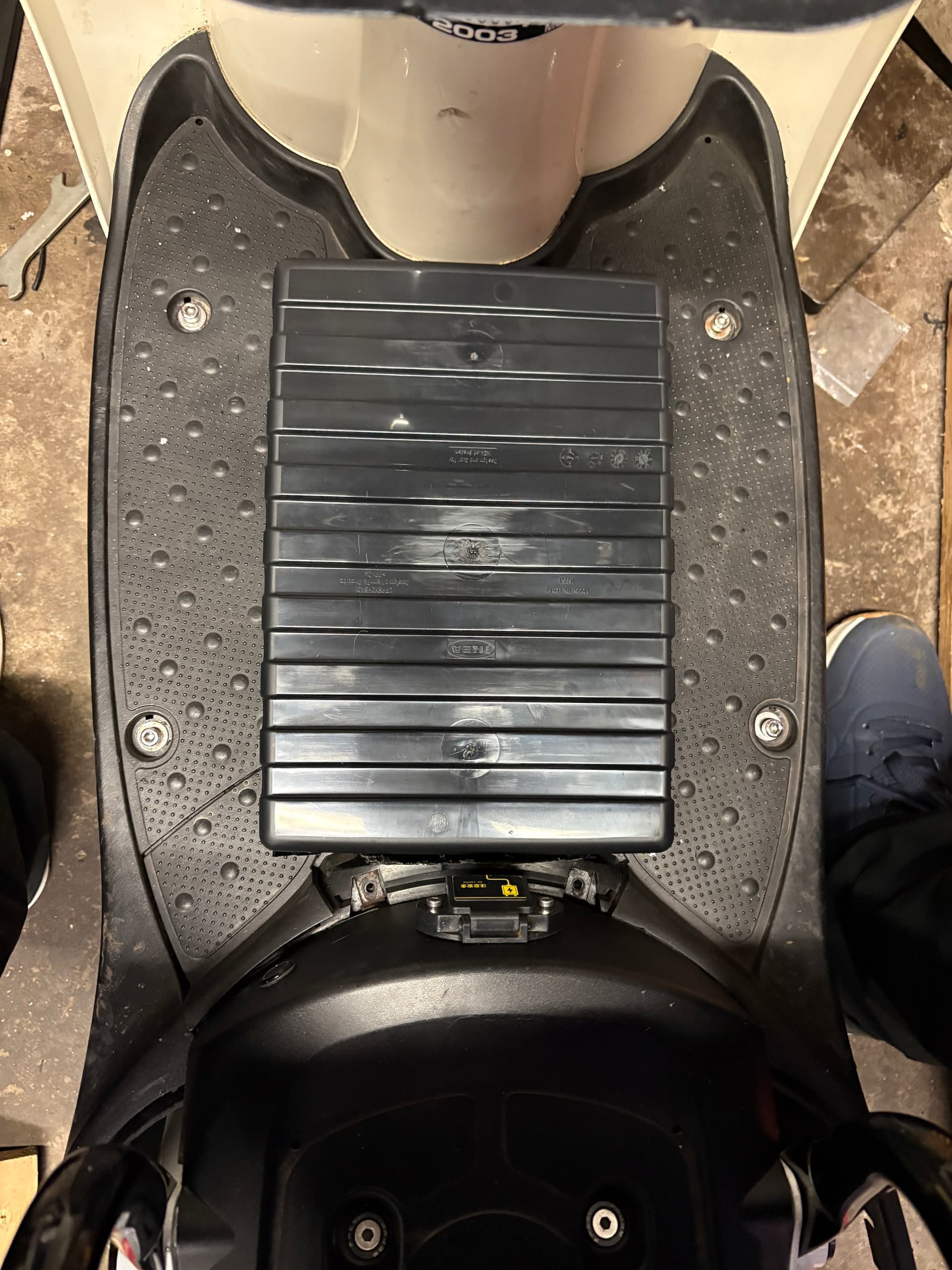

So the battery has stopped working. It’s under warranty so will get it sorted. Whilst I had the battery out, I looked to see if I could put them vertical…
Not gonna do it - just playing, but this would give me a good range!!!
Wondering whether I could put the larger battery vertically below the seat though. That would give me more range, and remove the ‘gap’ between the motor and the main frame that I don’t really like.
