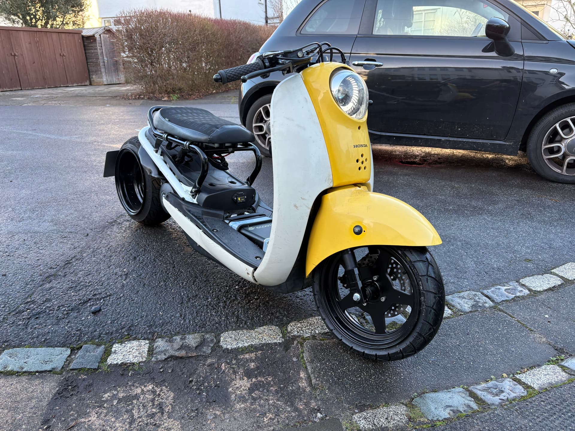

Mr_o_uk’s Mildly Modded Metruck
Year: 2003 / 2020
Make/Model: Honda Metropolitan / Ecooter E1R Donorr
Pictures:
Start:
Finish:
  • lots! Read my build log!

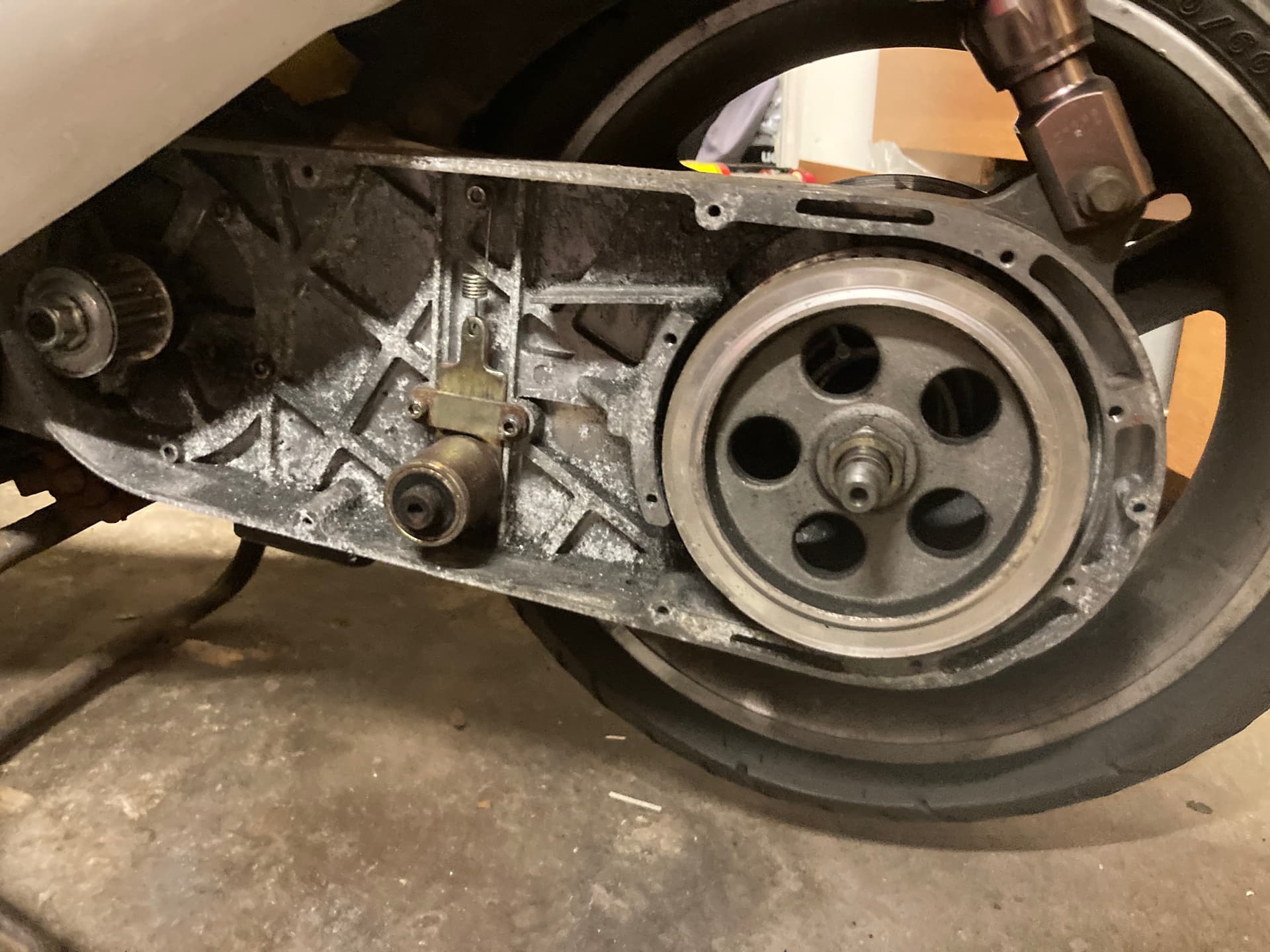

Need to get the bike running before I do anything. I bought it as spares or repair. It won’t drive as it has a broken belt.
Have taken the cover off to find the belt type. It’s a HTD 912-8M-30 belt.
Have ordered one.
Bike seems to run now that the cvt case isn’t locked up by the broken belt. Think this bike was a bargain.
