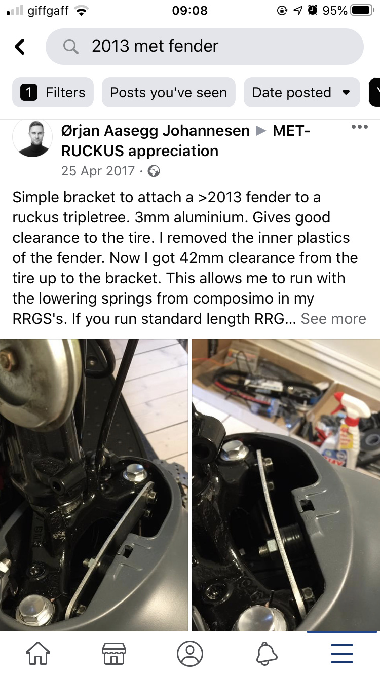

Options 2 is to fit a later 2013-2017 met fender. This requires modification and a new bracket also.

Photos courtesy of Aaron Ford (he used to sell brackets):
Photos courtesy of Derek Marciniok:
Photos courtesy of Oslo Zoomer Garage:
Photos courtesy of Tommy Chan:
